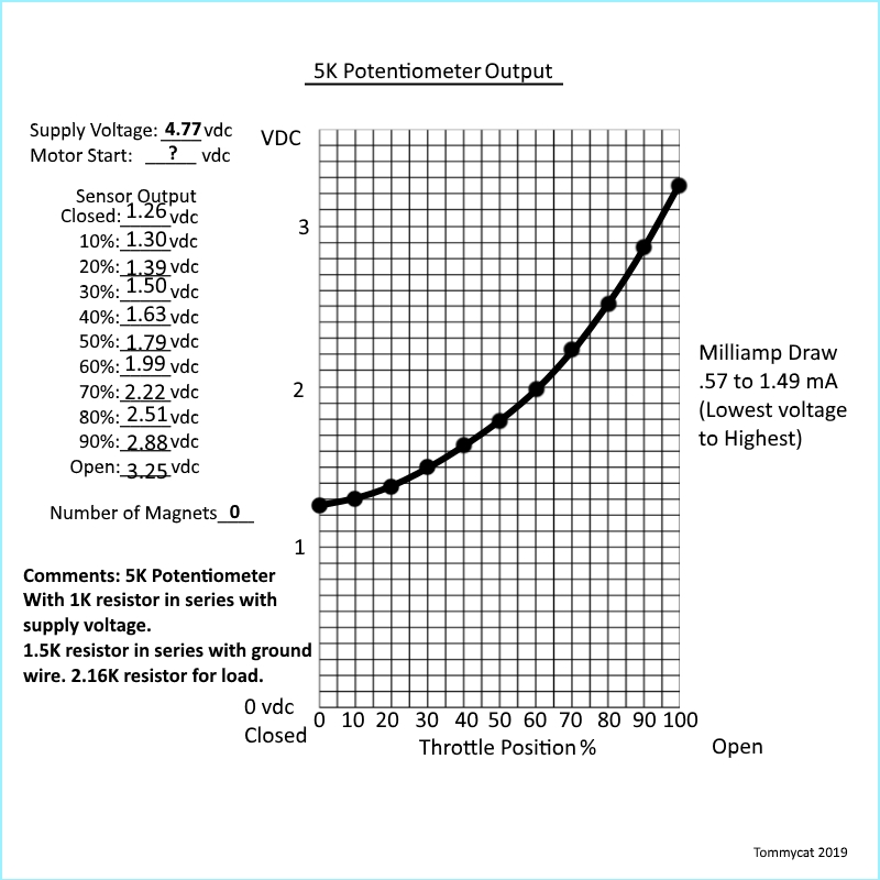

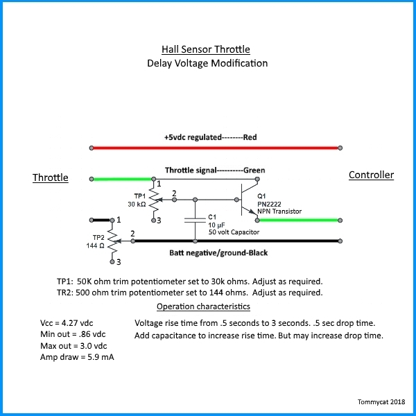

Being interested in hall sensor throttle operations and modifications, and lightly into electronics. I found an acceptable circuit for "soft start" as seen below.
It's main purpose is to "delay" the voltage ramp-up of the output of throttle's hall sensor output for a smooth and easy start-up.
This is a proof of concept circuit that has been proven to work with parts on hand. But depending on the power source voltage, it may drop the top end speed slightly. So definite room for tweaking and improvement, but it's a starting point.
I would always recommend checking your throttle's output first to verify it's operating correctly...
Or perhaps change to a potentiometer type throttle that has this smoother start-up output profile... (but pricey)
For more information on hall sensor throttles, how to test, profile, and modify. See my thread here...
