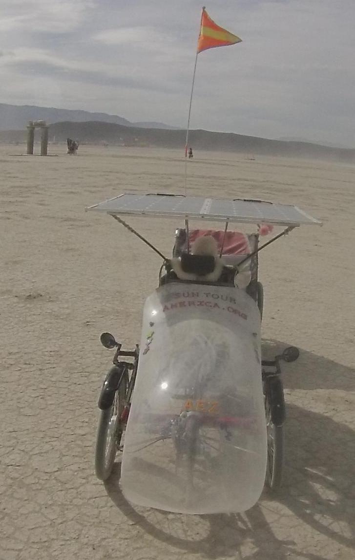

I'd love to be able to ride into the sticks, then just sit in a camp charging enough to get back to plugs. The sides of my panniers are about 30" x 16" So two panels about that size would carry great on my longtail. I'm thinking more in terms of charge stationary though.
If you aren't in a hurry, stationary charging sounds like a fine idea. And if you ARE in a hurry, what are you doing on a bike out in the sticks. Before I hooked up more battery, I was perfectly happy with the idea of going 20 miles, stopping for a three hour rest and lunch and then riding 20 more miles.
Having two panels is a good idea. I am learning the hard way that the up-converter and batteries are not a great match to a single 12V panel. With a max power point at 17.7V and 5.7 A, the panel is looking for a load around 3.1 ohms. On my bike, when the battery is deeply discharged, the panel is running at 12V and 6A -- which means that it is seeing a roughly 2 ohm load and I am not getting full power out of the panel. What I get into the battery at that point is typically around 1.6A at 38V for a power of 60W into the battery and an up-converter efficiency of ~85%. As the battery gets full, I get better performance. With two 100W panels in series, the max power point is 35.4 volts and 5.7A which is a good starting point. Hell, the open circuit voltage is 21.7 per panel or 43.4 volts. I could ALMOST use the two panels without any DC-to-DC converter at all. OK, I just decided to get another panel. Busybee's solution is just too cute to ignore and is a much better solution electrically than my single panel. Besides, the simulator @ ebikes.ca says I can go 18mph on level ground with only 150W. So, through the midday hours I would just about break even as I ride !!
dogman said:
Two panels at burning man sounds perfect. No high speed riding so the wind drag hardly matters. But the shade as you ride could be priceless.
Panel frame is a half inch thick and underway is always horizontal. There were high winds at Burning Man and extra windage from panels was not noticeable. The fairing more than cancels it out. A string of LED lights around the panels makes finding the trike at night in a sea of bikes easy. Lots of bike carrying LEDs, but not panels to put them on. I'm thinking to add an Arizona Whip or make the equivalent if only for added safety.
The fairing helps keep the rain off, but in Arizona that is a rare issue. Far more useful, the fairing can be covered with Spandex for better safety (neon for being seen) and to provide more shade. When it is 110 in the shade, riding a recumbent is like laying flat out on the beach to catch the sun. Riding made-in-the-shade with a mister bottle and a 2 quart thermos full of ice water hanging behind the seat with a tube as long straw works wonders.
As for speed, I support the EU speed limit of 15.5 mph for ebikes that want to be considered bikes and not e-motorcycles, which will get them banned from using bicycle transportation infrastructure as is happening. Ebikes are banned from using bicycle paths where I live, Tucson. Better to go fast enough than get banned. Although my motor is "off-road" and all speed limiting can be turned off, I've set it to 25 km/h just because 15 mph is fast enough. At Burning Man 5 mph was fast enough, at times far too fast on the pedestrian filled streets, and on the open deep playa 12 mph was good as 15 mph seemed too fast. To paraphrase Shakespeare, 'nothing is either fast or slow, but thinking makes it so.'

Anyway, second panel installed at least in a prototype way.
All wired up. Wired direct with a blocking diode to prevent backstreaming.
We'll see what the open circuit voltage is next time the sun shines. Hoping it is just below 42V -- should be close.
So what can I do with 200W ? http://www.ebikes.ca/tools/simulator.html says that a fat man on a recumbent can go 18.4mph on level ground with a Bionx PL350 @ 159W.
Vielleicht scheint morgen die Sonne wieder.
Update 9/18/14 AM:
Nein, die Sonne scheint nicht weider. 1.34 inches of rain and counting -- right now it is just misting, but too wet for a ride, and still no sun at all.
Did manage to get out for a few minutes yesterday late afternoon. It was right before the remnants of Hurricane Odile arrived. Wind was pretty high 25mph gusting to 35 or so. The panels were simply not affected by the wind. Since they are horizontal there just isn't much for the wind to grab onto, but there was virtually NO perceptible influence from the gusts. The added weight from the frame and second panel is not too bad, but it is larger and has a higher moment of inertia in the yaw (rotation right and left) axis. Bumps make it rotate slightly right and left and I can feel that input to the bike. I added two temporary "struts" from the solar panel frame to the rear rack. It is just baling twine tied so that it is in tension and prevents the rotation. That should reduce the tendency to wobble left and right.
I am still using the PVC supports that I used for the single panel and may end up replacing them with something stiffer. The effect on the bike is not actually very great, but the wobble can be felt and is an invitation to "pilot induced oscillation" if I try to correct for it. The frame of the Cruiser is CroMoly and pretty flexible in the "twist" direction, which doesn't help. Still, it seems quite rideable as is and there is a LOT less "squeak" from the PVC. There are a number of possible support options left to try if this arrangement is too loose for my taste. Can't wait for full sun.
OK, The 2-panel version is, for the moment, finished.
After determining that the open circuit voltage was unlikely to exceed 42 volts I decided to re-use the original DROK DC-to-DC upconverter. It's published limit for power is 120W, but it is VERY well cooled and does not get particularly warm in-run. It's published upper limit for input is 32V, but it is working fine for the moment, we'll see how it holds up. When the (parallel) panel voltage rises above 34 volts, we are in the final stages of the charge and current flow is low so total power is low. The voltage limit is likely based on the caps, and if they survived their first exposure, they are likely to continue to do so. The choice to stick with the smaller DC-to-DC converter left the electronic package unchanged and MUCH smaller than it would be with the 600W converter. It also left the 600W converter available for another project.
The only real changes are the change from a single panel to two panels wired in series. The power output has roughly doubled as expected and the voltage match -- input to output is better so the converter efficiency is improved. The efficiency improvement is sufficient that it actually seems the converter runs cooler now than it did with the single panel.
The only problem was how to run the 12v cooling fan. The original cooling fan could run on a voltage between 10V (loaded panel) and 19-20V (unloaded panel). This worked very nicely indeed, and matched the panel pretty well, but was not a good match to the cooling needs. When the panel was loaded, the voltage was low and the cooling was limited at the very time that cooling was needed most. When the battery was full, the panel was unloaded and the fan ran GREAT, but little cooling was required. SO, how to manage the fan. The straightforward solution is a second small DC-DC converter to convert battery voltage to 12V or so for cooling. But, this complicated the electronics and made another circuit that needed to be protected with a diode to be sure that if it died it could not short out the battery (remember that half the battery pack is RC LIPO which is pretty allergic to shorts.
A quick glance around the garage produced a small 7x7 inch 12V solar panel that originally was part of a solar powered motion controlled light. A quick touch of solder and the cooling fan now has its own panel entirely separate from the main solar system. Bright sun...high fan...no sun...no fan, and no drain on the battery. Actually, the little panel is roughly 6W so it and a small battery would happily run the rear light system at some point in the future.
Anyway, now looking for a cool day with good sun to get out and REALLY exercise the bike. First planned tour is just 36 miles total, but may not happen for a couple of weeks since I am going to Albuquerque for the balloon festival. I'll report when I have good data for charging characteristics of the 2-panel system. I would be insanely happy with 150 W peak charging with the bike tipped to the sun. I also need to rig a way to monitor the panels performance during a ride with mid-level battery. Under load, with 50% charge, the battery voltage (at the charging system) should drop top ~37 volts and allow the panel system to provide whatever it can without hitting the 42V high-volt limit of the DC-DC converter. I have a cheapie volt/amp meter that I can wire in, but what I really need is a WATTSUP or cycle analyst.
Anyway, more to follow. One experiment planned for later is to determine whether the performance is noticeably different with the panels wired in series or parallel. The current configuration is in series which provides a better voltage match panel-->charging system. In parallel would cause a larger voltage difference but would LOWER the effective impedance of the panels which might allow more power to be drawn from the panels (although the losses in the converter will go up because of the greater voltage mismatch). An interesting question for later.

Handling: A final note now that I have 100+ miles with the two panels mounted. The handling with the two panel layout is not noticeably different than the single panel, except... The bike is wider now and the width is the panel, not the front wheel stance. I have to be CAREFUL going through my electric gate to look at where the PANEL is with respect to the gate (I was used to looking at the front wheel). The bike is also more subject to oscillation in the roll axis, there is simply more weight up in the panel and it is easier to get it swinging back and forth left to right and because it is heavier than the single panel it has more effect of the relatively flexible CroMoly-framed Cruiser. It is irrelevant at normal riding speeds (15-17 mph on level ground), but on a long downhill (22-25 mph) I have to be more careful to watch my technique and damp out any oscillation. This is not a big deal but it does take some getting used to. It took most of that 100 miles of experience to get back to feeling secure at 25 mph.
