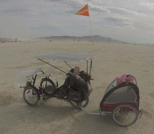

Something about going solar and Arizona. I recently got back from riding my solar e-trike for over a week at Burning Man. Also used the Renogy panels, two of them in series in an aluminum frame I made supported by fiberglass poles, about 12 lbs altogether. My wife and I took turns riding the 56 miles of internal streets and checking out the artwork on the playa. Several times I rode the perimeter fence, about 9 miles, always counter-clockwise of course, sometimes going several miles without seeing anyone--something few at Burning Man can say. By sunset the battery was fully charged, ready for a night tour of the playa and by the time I got up, it was fully charged. Having a fully charged battery became monotonous. Going solar is costly, but the geek satisfaction of being free from the plug--priceless. The e-trike is designed for touring, so I was always towing a trailer with a slow moving vehicle emblem on the back. Speed limit on Burning Man streets is 5 mph.
For more: http://www.soltechdesigns.com/soltech-solar-etrike/index.html
I really like that design. I have been thinking about a second panel and about moving the panel forward on the bike to provide more shade. Nice work, I may be compelled to copy this.... but first, I am going to get out and do some touring.
Two panels at burning man sounds perfect. No high speed riding so the wind drag hardly matters. But the shade as you ride could be priceless.
E trikes rule at burning man. All through august I was talking to folks on the E-bikekit chat about their burning man trike. I just got an email from a guy who said his trike was great at the man, but he had one big problem, finding his trike in a sea of trikes.
