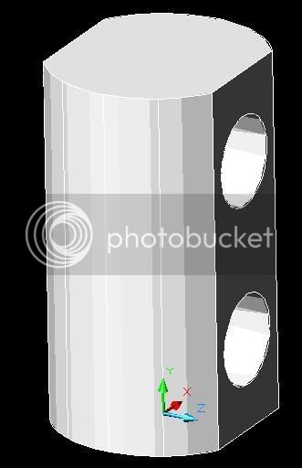

I don't like torque wrench specs when dealing with indifferent (unknown quality) cut thread, chinese steels, steel dropouts that may be soft cast, or malleable, or heat treated (we can't know); lubricants on the threads wildly vary the "torque" application onto the thread, wrench-reading be damned.
I built and rebuilt Model Ts. There were no torque wrenches then. You worked by feel.
I always, always, just wrench by hand. First tight but not too tight to damage/gall/overstretch. Then ride mildly (whether it's a T and its live rear axle nut, or a bike's front hub motor dropout. Then recheck. Then ride, recheck at intervals. Green Locktite.
These dropouts are "C" wrenches, themselves, of unknow-able quality.
It seems to me that a fix would not be an auto lug nut with the cone face, facing IN toward, and tending, to "spread" the dropout's "C";
but that's an academic worry.
How about a C CLAMP for the little dropout; a doohickey of metal, bolted over and surrounding the dropout's entire end, two piece (split) and
thus, preventing, any possibility of a dropout spreading open like a cone adjusting wrench mal-used with a hammer: spread legs.
Perhaps there's some practical reason why such a thing could not be done: a safety clamp preventing the SPREADING of a steel dropout.

A 12 mm bolt with flats milled into it to create a 10 mm slot-fitting shape has flats on it that are a bit over six mm wide. If one end of this stator bolt has no wires going through it, could you drill a couple of 5 mm holes through it (3/16" if you prefer) and use through bolts to hold a fork assembly? It seems like getting tough enough bolts (or pins) could resist the shearing forces involved. Is this a dumb idea? If I get another failure with my NC hub motor I'll consider it.
I had another failure... and success with this idea! Pictures are in the build thread here, post #41:
http://www.endless-sphere.com/forums/viewtopic.php?f=6&t=7511&p=124034#p124034
I like the way you are thinking!
Super stout
Instead of trying to squeeze perpendicular to the problem you take it straight on.
That makes sense.
-methods
I saw the photo's of the drilling of the axle to mount a crossbolt and you have weakened the axle significantly by doing this!
There is not much metal to begin with on the 12 mm axle and you have reduced the strength by 2/3 !
The axle diameter before the threads, on the inside of the forks is approximately 20 mm. This gives alot more surface area to mount a torque arm on.
You just need to grind some flats on this larger diameter surface and fabricate a torque arm to fit. Maybe grind to fit a 18 mm wrench?
I think this would be alot better than relying on the puny axle threads to prevent a spinout.
He has drilled the axle outside the dropouts. Thus the axle to dropout strength is maintained; the external portion of the axle must transfer torque only.
The one potential failure mechanism I see would be in tension, if the bolt is tightened too much. The normal force on that shaft from the nut _is_ through the now-weaker area.
