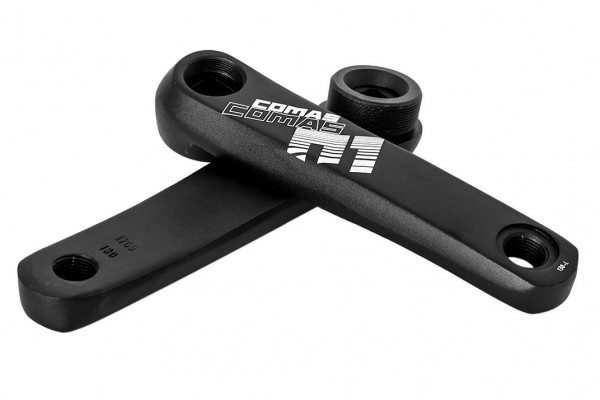

Thanks. I see the full kit but anyone just seen the cranks for sale?
I have seen them around on different bike trials vendor sites.
These are available in 140mm and 160mm and are square taper.
Anything in usa?
