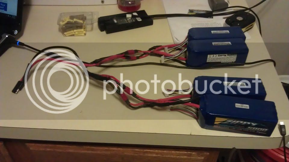

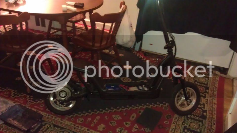

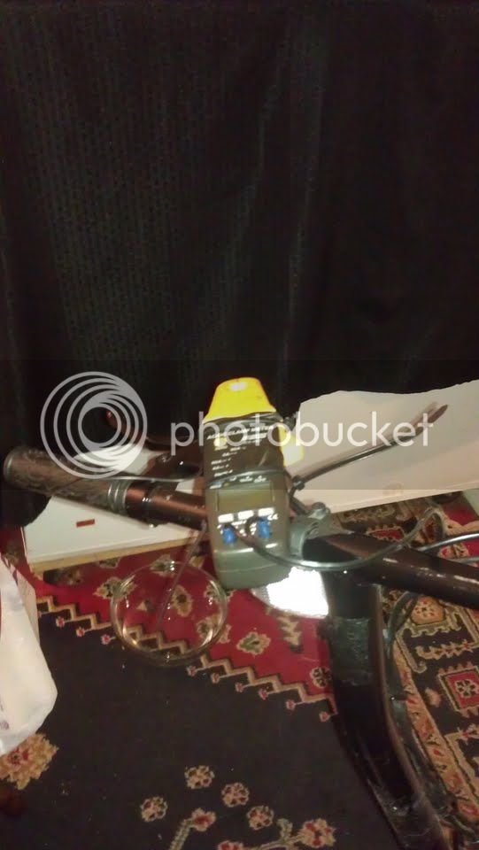

I finally got my battery order and put them together,but the connectors i bought Wouldn't work so i got deans from the hobby shop.Was nervous about soldering them but it came out great.Happy with the range,no way to tell milage but i was out for a while tonight.I'm running 4 5800mah zippy packs.Also surprised the stock 36v controller worked with 50v :).Untill i get a cycle analyst i just have a multimeter ziptied to the bars to monitor pack voltage.Can't wait to get a gng bb drive next!
Thanks for all the help!,i Didn't burn the house down :)

Be afraid, be very afraid. Just because you haven't burned down your house yet doesn't mean you can't...

Circuit,a Bms?..Was under the impression i Don't need it for Lipo,I stop discharging the pack at 44v and all the cells are fine when i looked at them with my charger.

Caveat with doing this is that YOU are the BMS and YOU better test and test and test some more so that you understand what you need to do to maintain SAFE pack health.
What should i test,look out for?.The chargers are automatic so i Shouldn't have to worry there right?I always watch them while charging and i charge them on a rack in my oven incase of fire i can just close the door.And i have two big fire extinguishers near by.I make sure the cells are balanced and not discharged too much while in use.Is there anything I'm missing?
