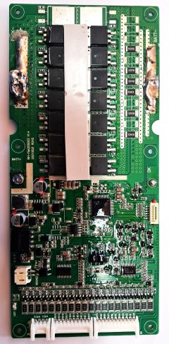

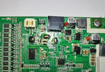

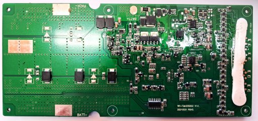

Hello everyone,
I am the owner of a SUNRA ROBO-S 3kW electric scooter equipped with two independent 72V battery packs, each containing its own BMS.
After approximately 12,500 km of use, both battery packs started showing abnormal behaviour. The dashboard frequently displays flashing 0% battery indications and significant differences in reported state of charge despite similar measured battery voltages.
I have been trying to understand the communication between the scooter and the battery BMS systems.
So far I have:
  • Measured voltages on the communication connector.
  • Investigated the wiring between battery and scooter.
  • Used an RS485-USB interface.
  • Performed oscilloscope measurements on the communication lines.
  • Attempted to identify the protocol used between the batteries and the scooter.
My main question is:
Does anyone have information regarding the communication protocol used by the SUNRA ROBO-S battery system?
Has anyone successfully identified whether the system uses RS485, UART, CAN bus, or another proprietary protocol?
Has anyone managed to use alternative batteries or replace the original battery packs while maintaining normal scooter operation?
I have attached a detailed report describing the battery issues, communication concerns, measurements and the technical difficulties encountered while trying to diagnose the system.
Any information from SUNRA owners, battery specialists, reverse engineers or BMS experts would be greatly appreciated.

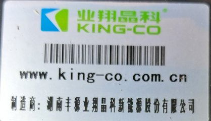

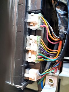

Additional BMS photos and controller connection photos.

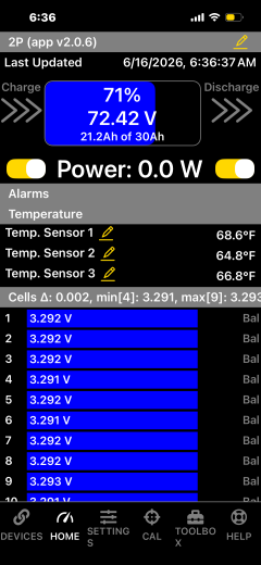

Thank you for your reply.
The two battery packs are not directly connected in parallel. Each pack has its own BMS and controller, and the scooter uses two independent drive systems.
What concerns me is that the SUNRA app does not provide access to individual cell voltages, balancing status, charge/discharge MOSFET status, fault logs, or any detailed BMS information. Therefore, the owner cannot monitor battery health or identify developing cell imbalance before it becomes a safety issue.
When I finally gained access to the battery data through diagnostic work, I found extreme cell-group voltage differences, including values as high as 4.70V and as low as approximately 2.16V.
Another strange observation is that the two battery packs differ by only a few tenths of a volt in total pack voltage, yet the dashboard reports approximately 18% state of charge for one pack and 86% for the other. This suggests that either the state-of-charge estimation is highly inaccurate or that there is a serious battery management issue.
In your opinion, could such extreme imbalance be caused solely by bad cells or spot welds, or would it also indicate a failure of the BMS protection and balancing system?
With cell groups @ 4.7 and 2.16 V, the BMS should have cut power since safe low and high threshold voltages were exceeded.
I have a scooter with similar form factor as your’s. I built a LFP battery for it with a bluetooth BMS that monitors many parameters. You may want to rebuild your batteries with a bluetooth BMS if there is room.

Did your original scooter battery communicate with the dashboard or controller through CAN Bus or another protocol? After installing the Bluetooth BMS, did the dashboard continue to display battery percentage correctly?
The battery has only 2 wires +|- to the controller, which sends SOC of the battery (# of bars) to the display. Battery SOC on display was not affected after installing bluetooth BMS.

BMS is JBD SP22S003AL22S40A (model seems to be discontinued)
My scooter is the Fly 7 with lead acid battery bought Dec 2021 for $950. Lead acid battery has been replaced at around 1300 miles with a DIY LFP 30 Ah battery (been working great for 2500 miles now).
