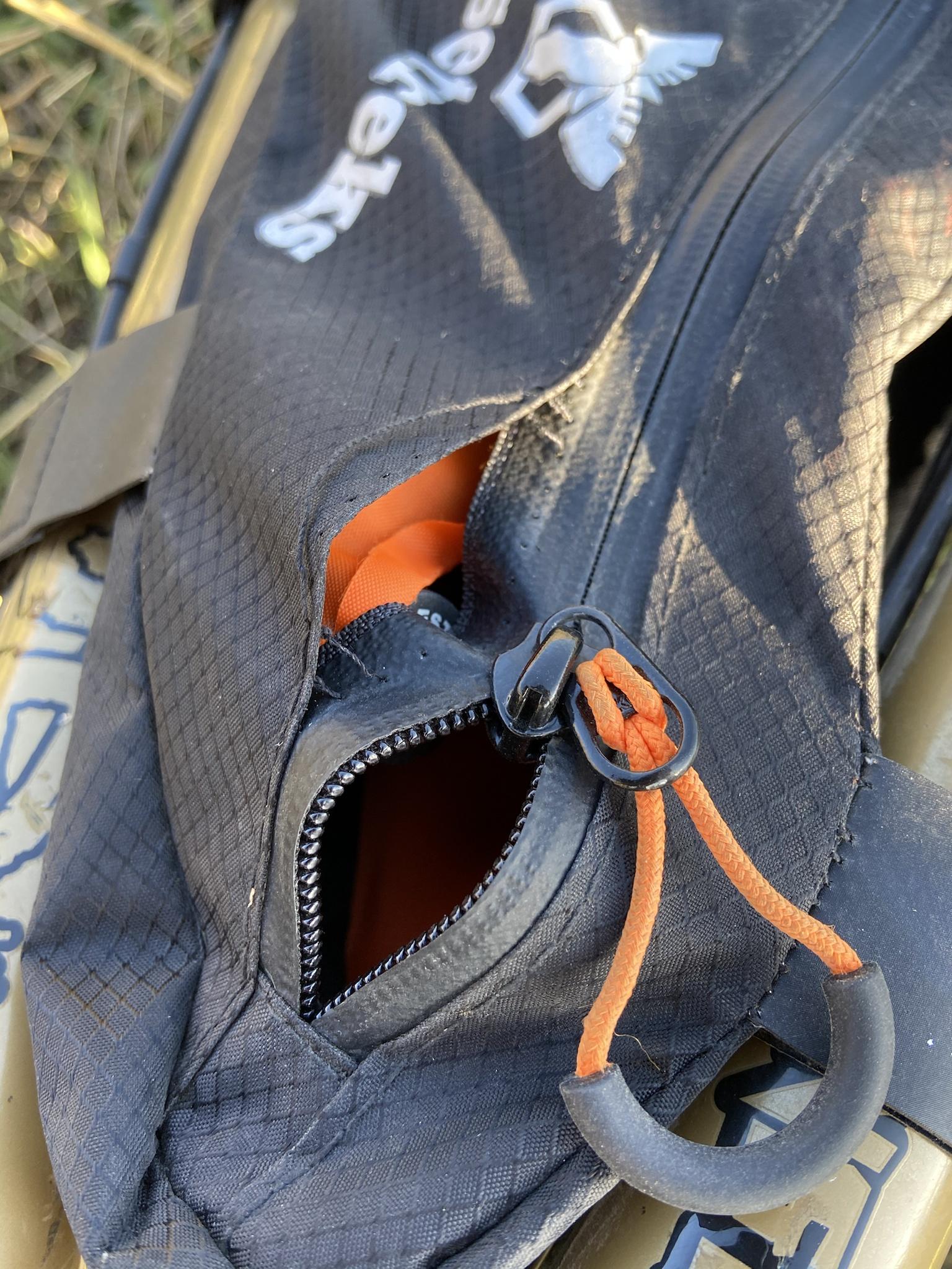

I had good first impressions of this product but that quickly faded and I definitely would not recommend it unless it's intended for light duty only.
Shame. That bag sure looked like it was high quality. The strap on the TT at the ST look like it's starting to rip because of the angle of the frame gusset to the ST, problematical fit, as discussed earlier.
I would probably (before throwing it out) hit all the seams with Shoe-Goo to reinforce them, see if that helps. Would take some patience, to make it look nice and not a spider webby mess of overworked plastic cement.

I thought of that as soon as I saw the tear out on the strap. Fortunately I'm still in the ebay return window and the seller will accept it, so it's going back. Now I'll need to figure out a mounting solution for the 3rd time :roll:

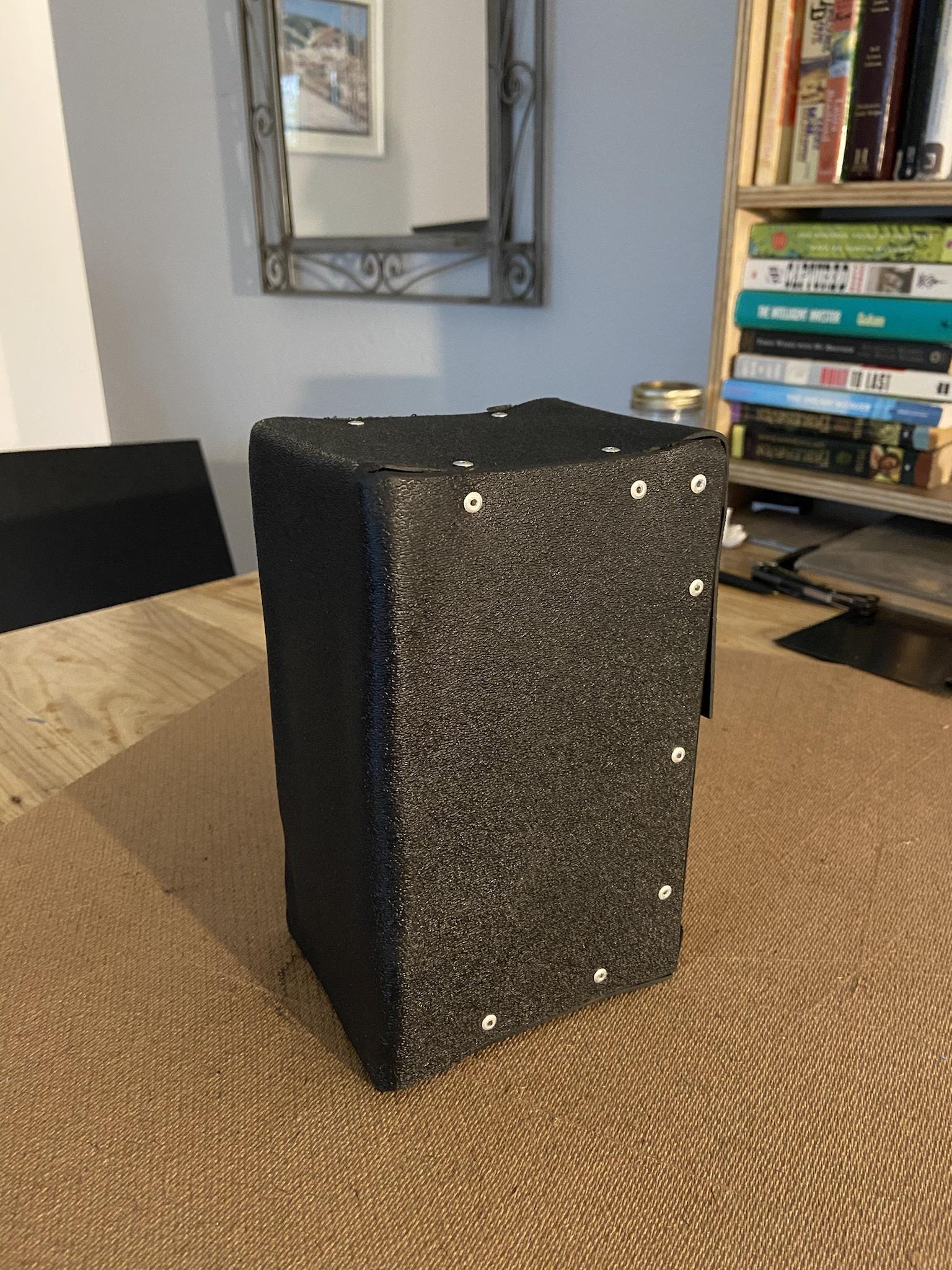

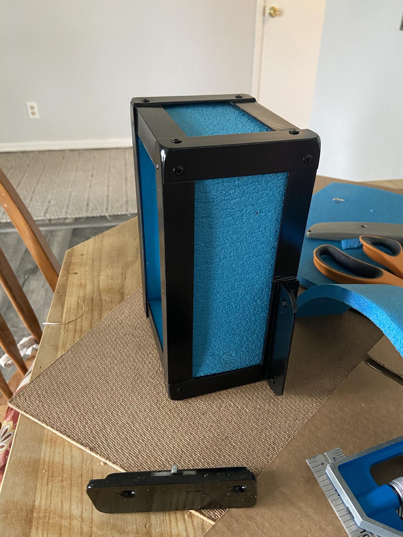

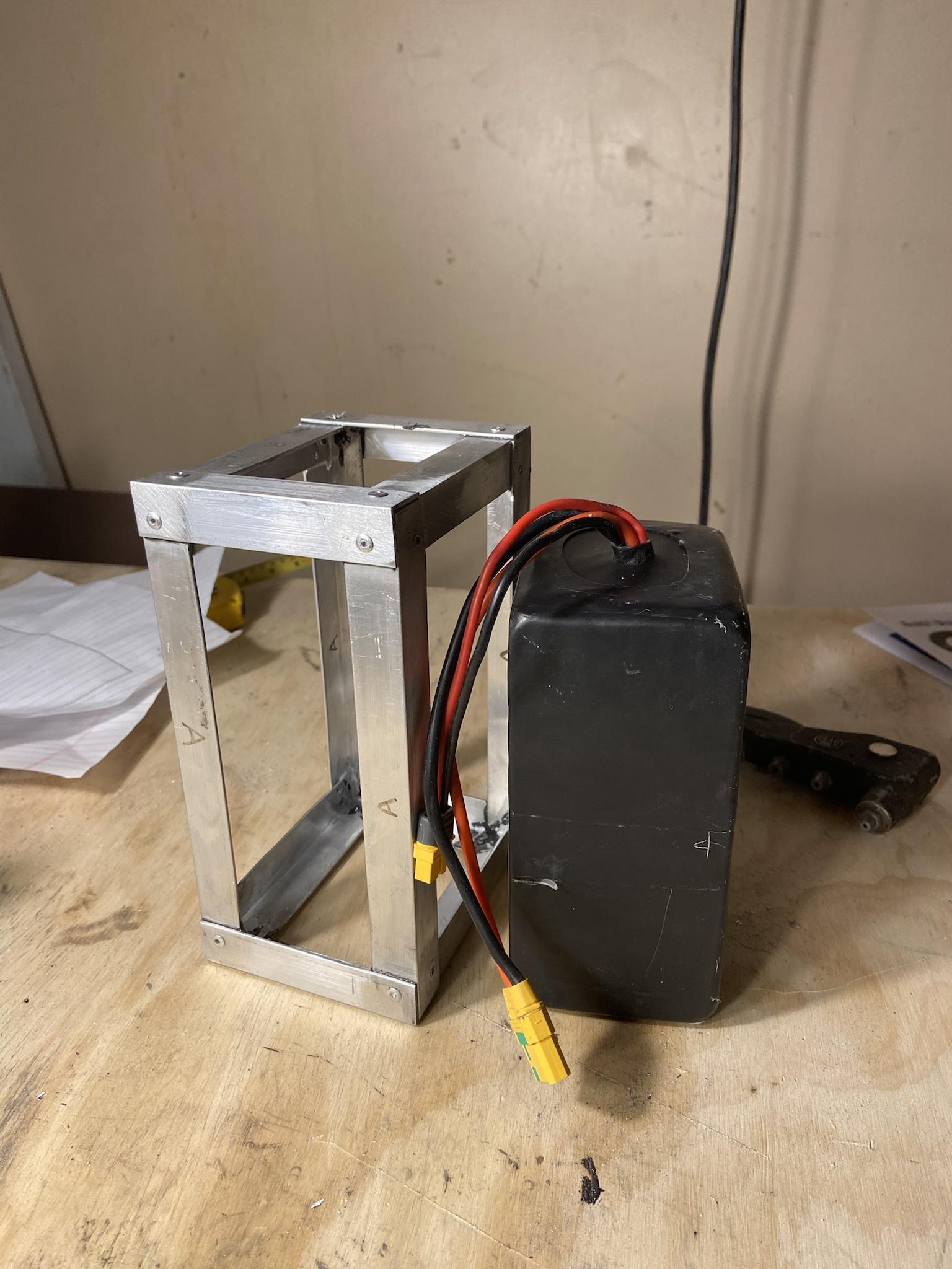

I've abandoned the frame bag idea and decided to fabricate a battery box. The material of choice is 3/4" aluminum angle. I gave myself about a 1cm margin on either side of the battery and then cut the pieces down to size on a miter saw.
I had wanted to braze everything together with those low temp "welding" rods but soon realized that wasn't a great idea given my lack of welding experience. You have to braze the entire joint together at once and it was a pain even trying to square the 3 edges. You need 2 clamps which then makes the actual brazing very awkward.
So I ended up brazing the 2 wide rectangles corner by corner, then forming the box by attaching the short side with a combination of JB weld and pop rivets. The completed frame is pretty strong - I'm 160 lbs and can stand on it with no noticeable deflection.
The battery doesn't actually fit inside yet - the angle overlaps ~1/8" on the each of the long sides so I need to trim some material off.
Next steps are to figure out how to mount it to the bike (I want something that is somewhat easy to remove) and then wrap it with the 1/16" ABS sheet I had ordered a while ago.
After procrastinating this for a while, I've mostly completed the battery box. I didn't have high expectations for the ABS sheet finish but I'm not very happy with the result. It's sturdy but pretty misshapen. It was a mistake to mold the ABS directly onto the frame. Given the overlapping pieces and empty space in the middle it's obvious why that approach didn't work well.
The plan is to seal the seams with some silicone then make a removable cover for the plugs. Down the line I might redo the ABS but that probably won't be anytime soon.

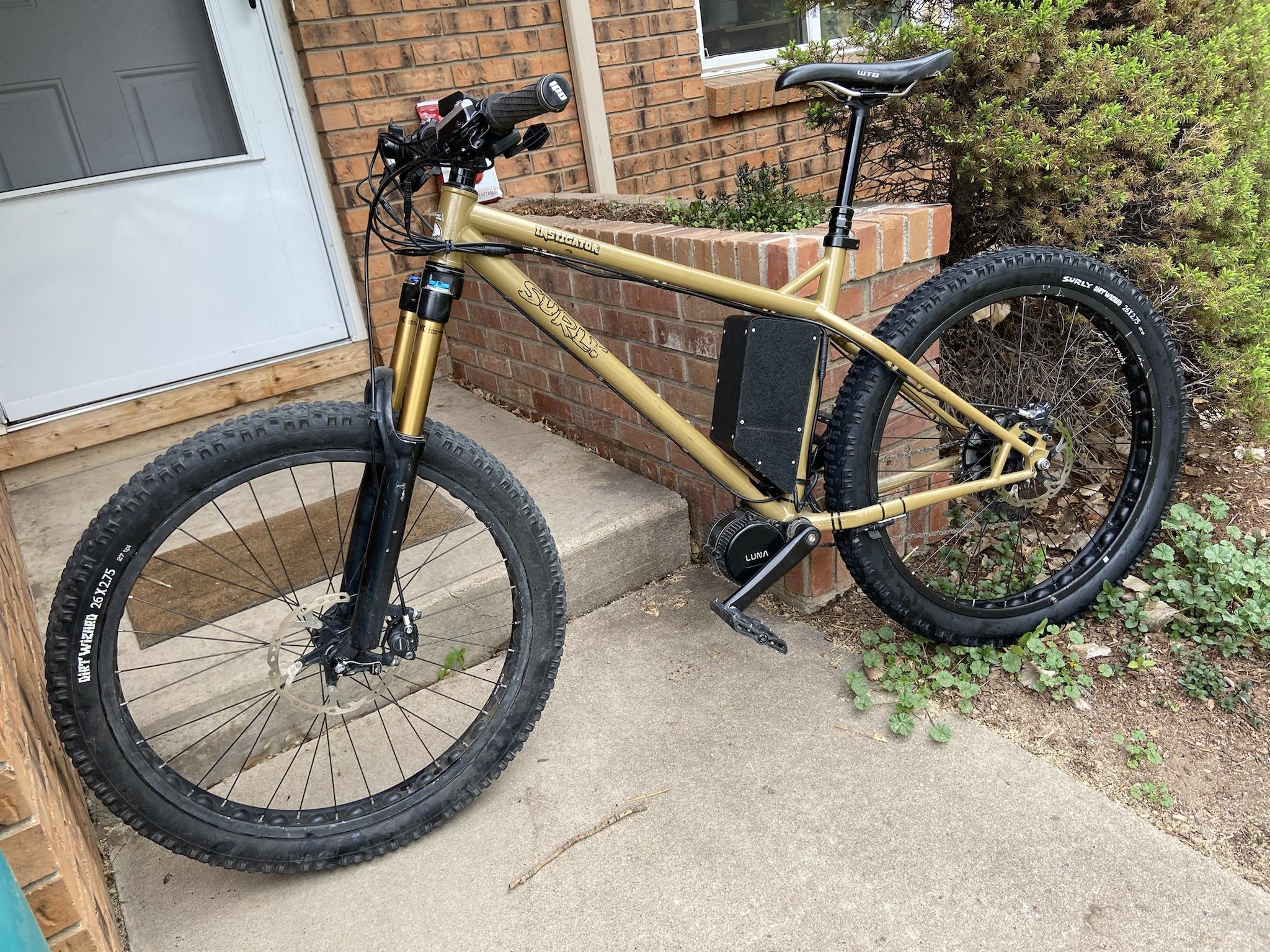

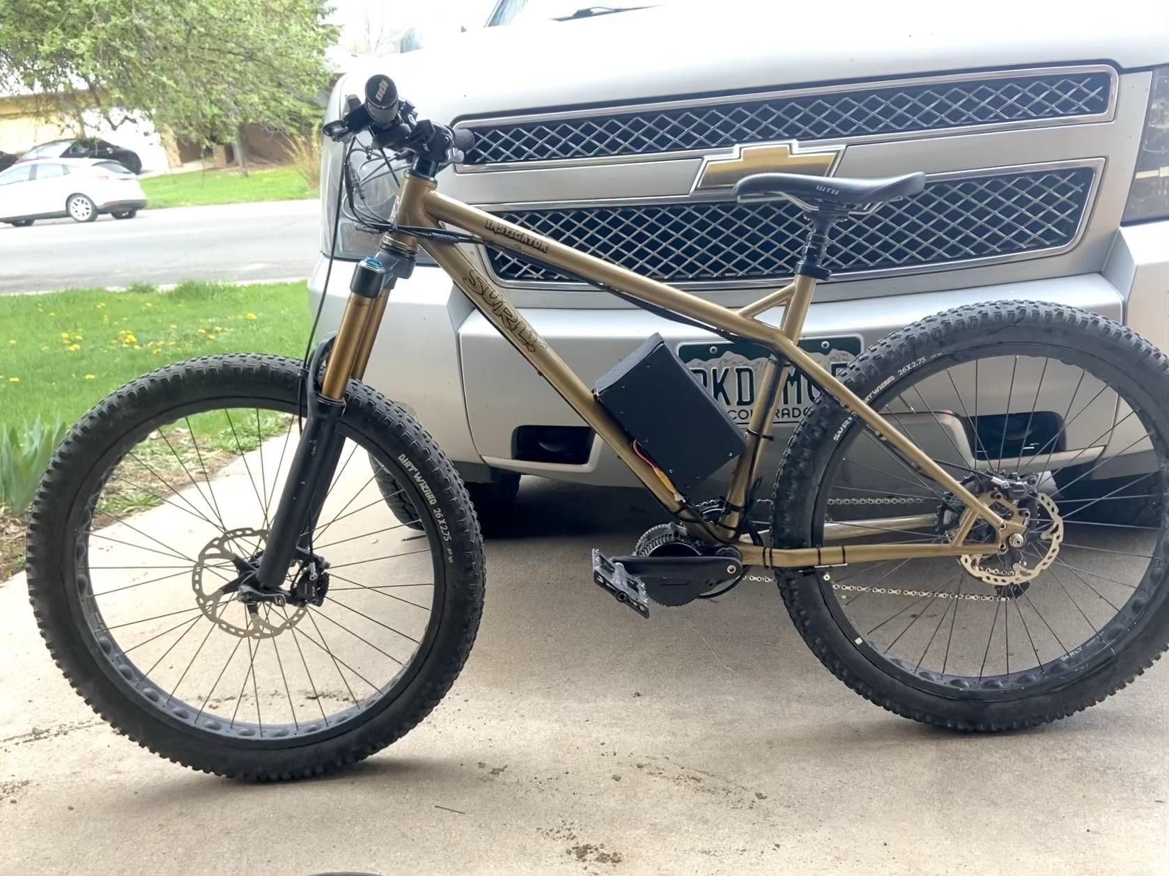

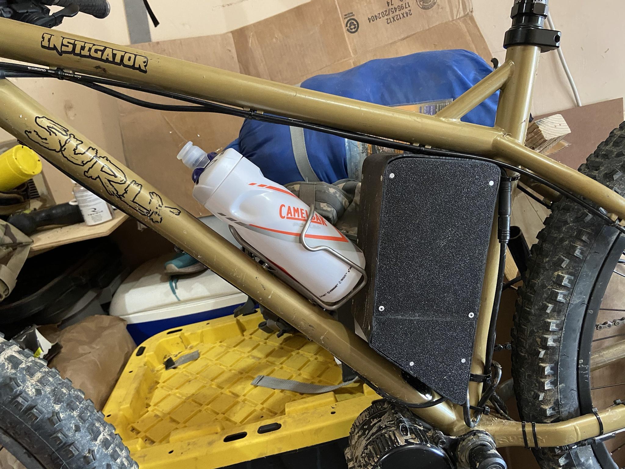

Not sure why I thought a square box would look even somewhat adequate. Probably because It was easier to build. Once I saw how ghetto it looked mounted, I scrapped it and built a new battery holder. Also, based on my reading, it was unnecessary to add the foam padding so I was able to cut about .5" off the width and 1.5" off the top (although more than that was added back as a triangular space on the bottom).
V1:
V2:
Still not great aesthetically but I'd say it's at least acceptable. The cables fit neatly on the bottom and the cover is held in place with magnets for easy charging. Not sure if I trust it on rough trails yet as the box itself has a bit of flex, as does the mount to the water bottle holder.
I've since sealed [most] of the seams with an ABS and acetone slurry. Once I find a cap that will fit in the cable hole on the back (need something like a bar end cap, but larger diameter), it should be somewhat waterproof.

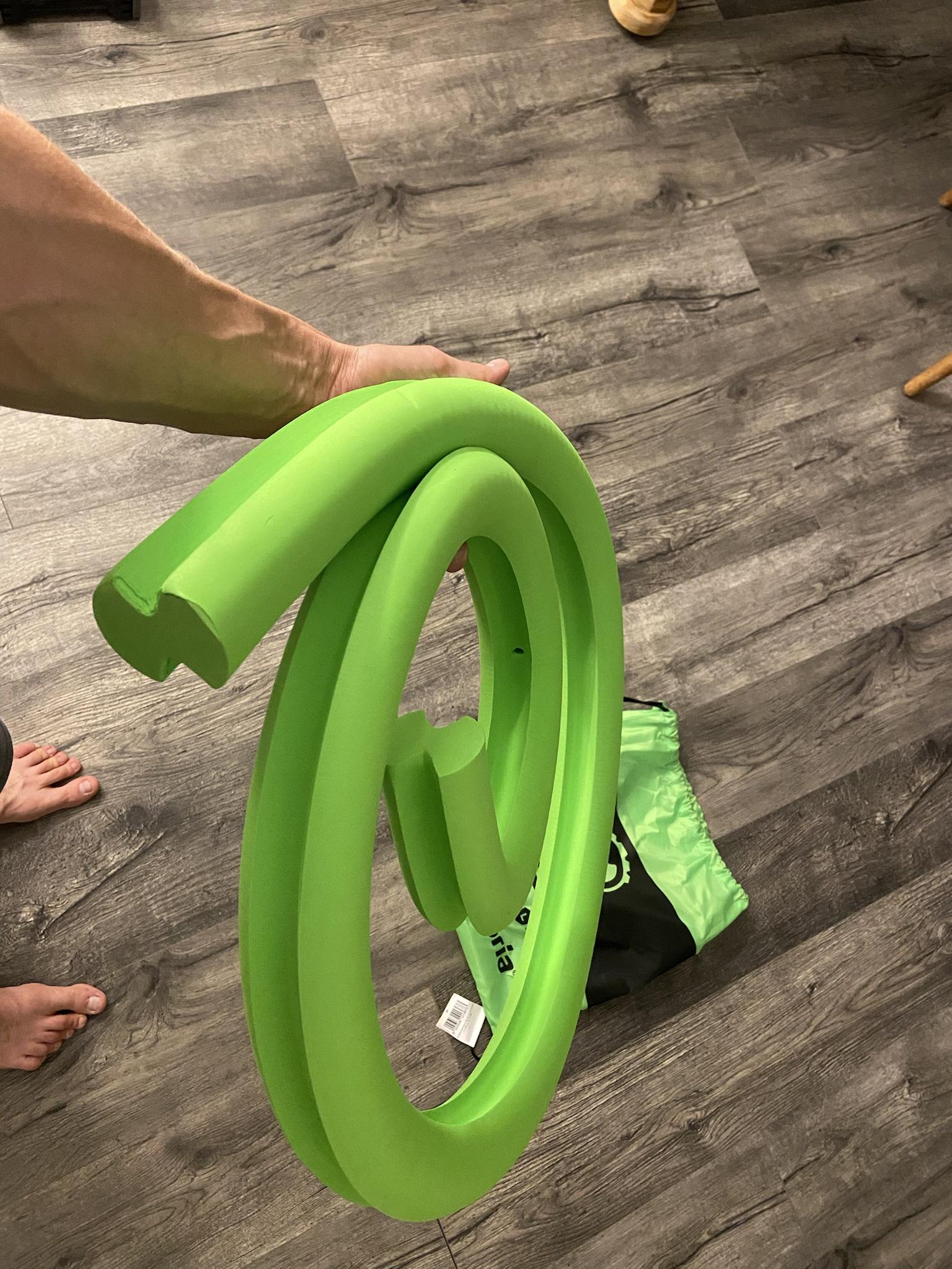

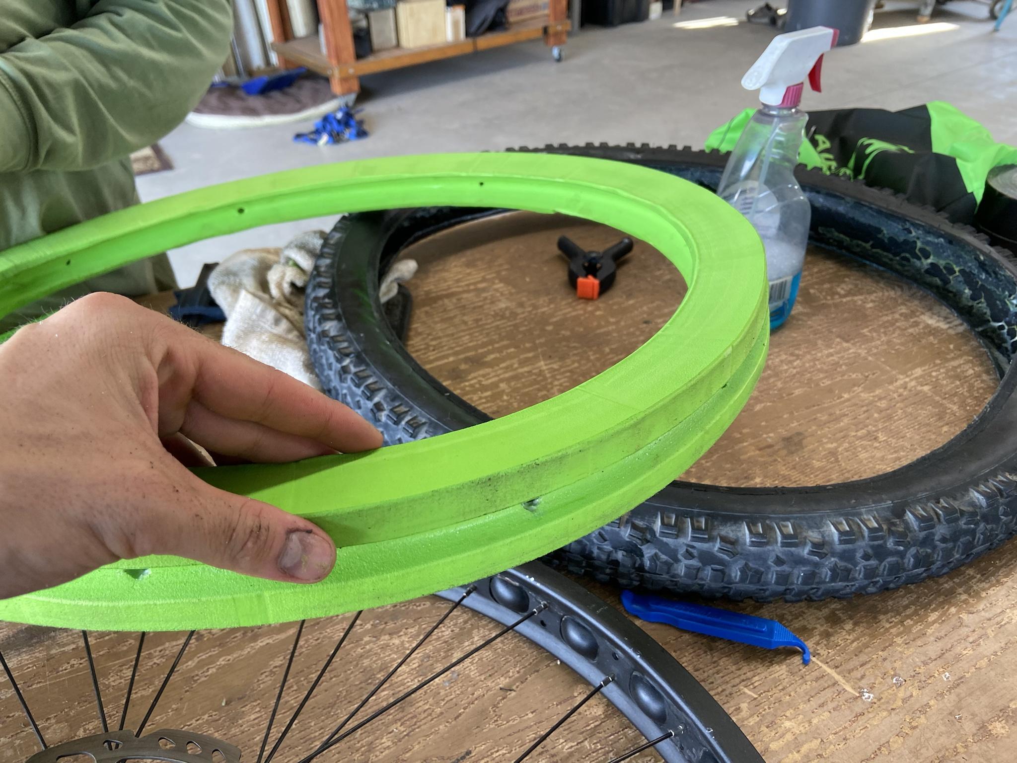

Tire insert arrived today. The foam is a lot denser than I was expecting for a product that's called "air liner". It's definitely light, but I'm worried I'm not going to like the damping characteristics. Based on the firmness of the foam it seems like it might make for a rougher ride. It had good reviews on pinkbike, but I'll find out soon. Anyways I bought this to avoid pinch flats and it will definitely do that job. It's large enough that once my tires are seated I'm pretty sure I could ride with them at 0 psi.
Installed the insert today on the rear wheel. I'm not going to bother with one in the front tire as [knock on wood] I never get flats there. I'd say this was probably my longest and most frustrating tire related bike repair I've ever done - close to 2 hours (including re-taping and adding a new valve stem). Part of this was my fault for ordering too large of an insert, and part of it is on Vittoria for suggesting the XL insert is appropriate for a 2.7" tire. Rim width (rather than tire width) would probably be a better sizing criteria. The stated tire size range for the XL was 2.7-4.0".
I was 2nd guessing my size choice initially as that's a huge range for 1 product to cover, and turns out my intuition was correct. The "XL" insert was way too big for a 2.75" tire and 50mm rim. It took 3 attempts to fit the insert, and the last 2 I used a bandsaw to trim off progressively more material. I spent way too long trying to wrestle the final 10% of the bead on before resorting to my "hackjob"; even with tire levers it wouldn't budge. Once I trimmed enough from the insert though, the tire mounted as easily as any MTB tire.
I'll have to check pressures with my presta gauge, but I'm pretty sure I can easily run 15 psi or less. I'm planning to give it a shakedown on a rough trail tomorrow, but from my ride around the block, I'm very happy with the result. Ride quality is great, traction and sidewall support is great, and there is some serious run flat capability. I'd say this improves comfort (and traction) considerably as you can run low pressures with far less tire squirm and risk of rim damage.

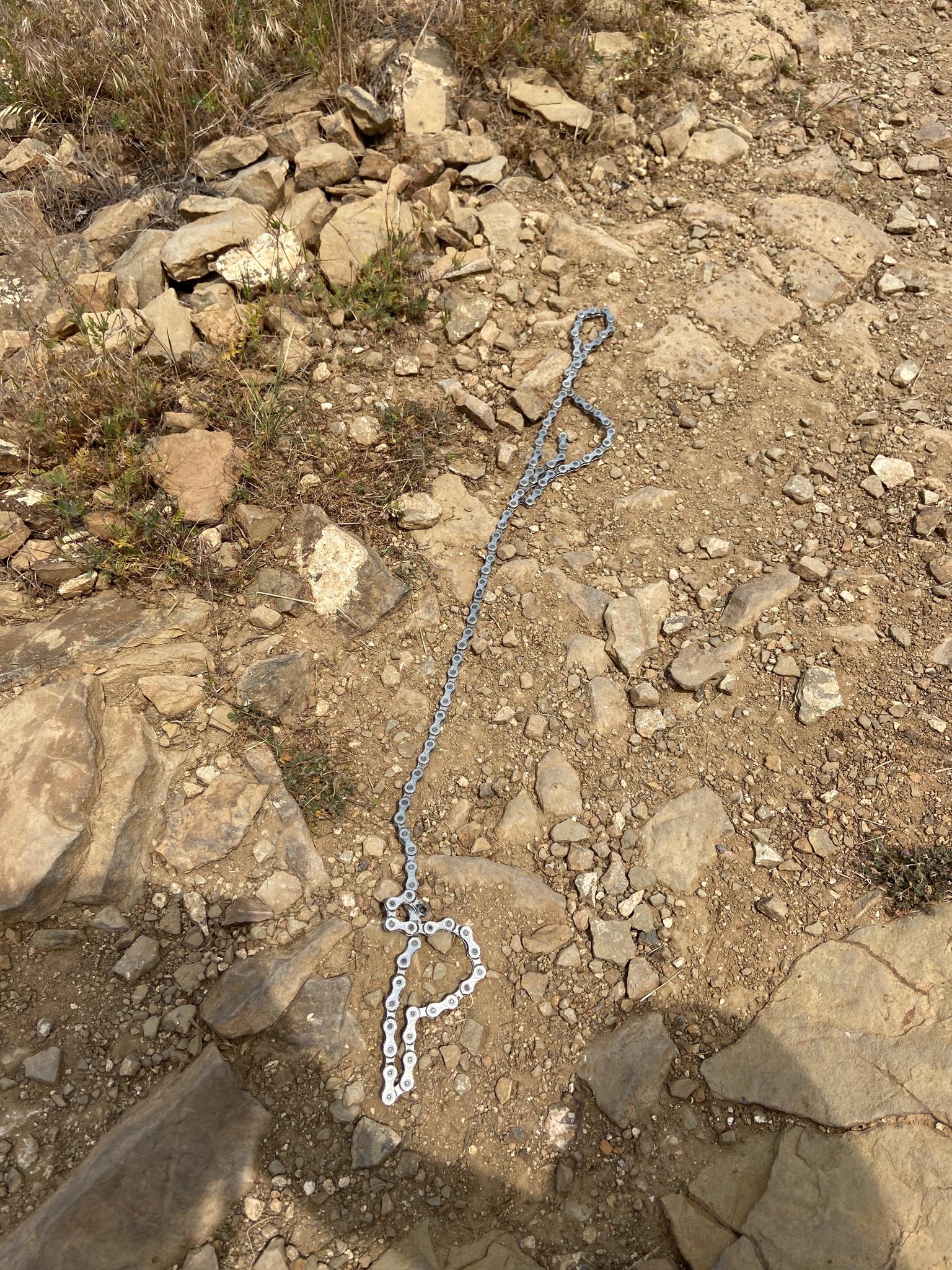

I was going up a moderate incline in either the 2nd or 3rd lowest gear when it snapped (assist level 5, 30% current). It bent one link and pulled the pin out from the other side. Fortunately I was near the top of my climb and only had to walk a couple hundred yards + a few blocks after riding down with the chain in my pocket.
Yeah I think it might. I need a portable chain tool as well. The battery compartment is a good option If I don't get a seat bag. I was at Sierra trading post the other day and was thinking about one but I'm too cheap to pull the trigger on the $30 bags they had in stock. Kinda overpriced for a discount retailer...

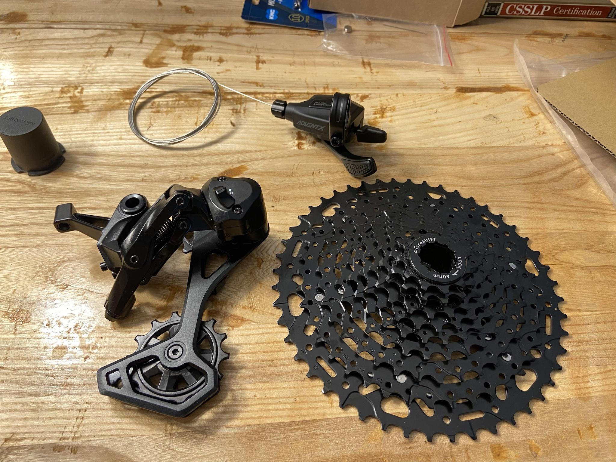

I replaced the chain, shifter housing and cable, then spent a few hours adjusting everything. I wasn't thrilled with the shifting performance (and this bike has never shifted super well in my ownership), so I pulled the trigger on a brand new drive train. Got a 10 speed AdventX 11-48 cassette, derailleur, and shifter for 150 bucks + tax. I hadn't actually heard of Microshift before @TNC mentioned them in another thread recently, but the AdventX stuff seems to be well received. First impressions are good - it seems well built, only minor complaint is the shifter action isn't the crispest and it's thumb only for everything.

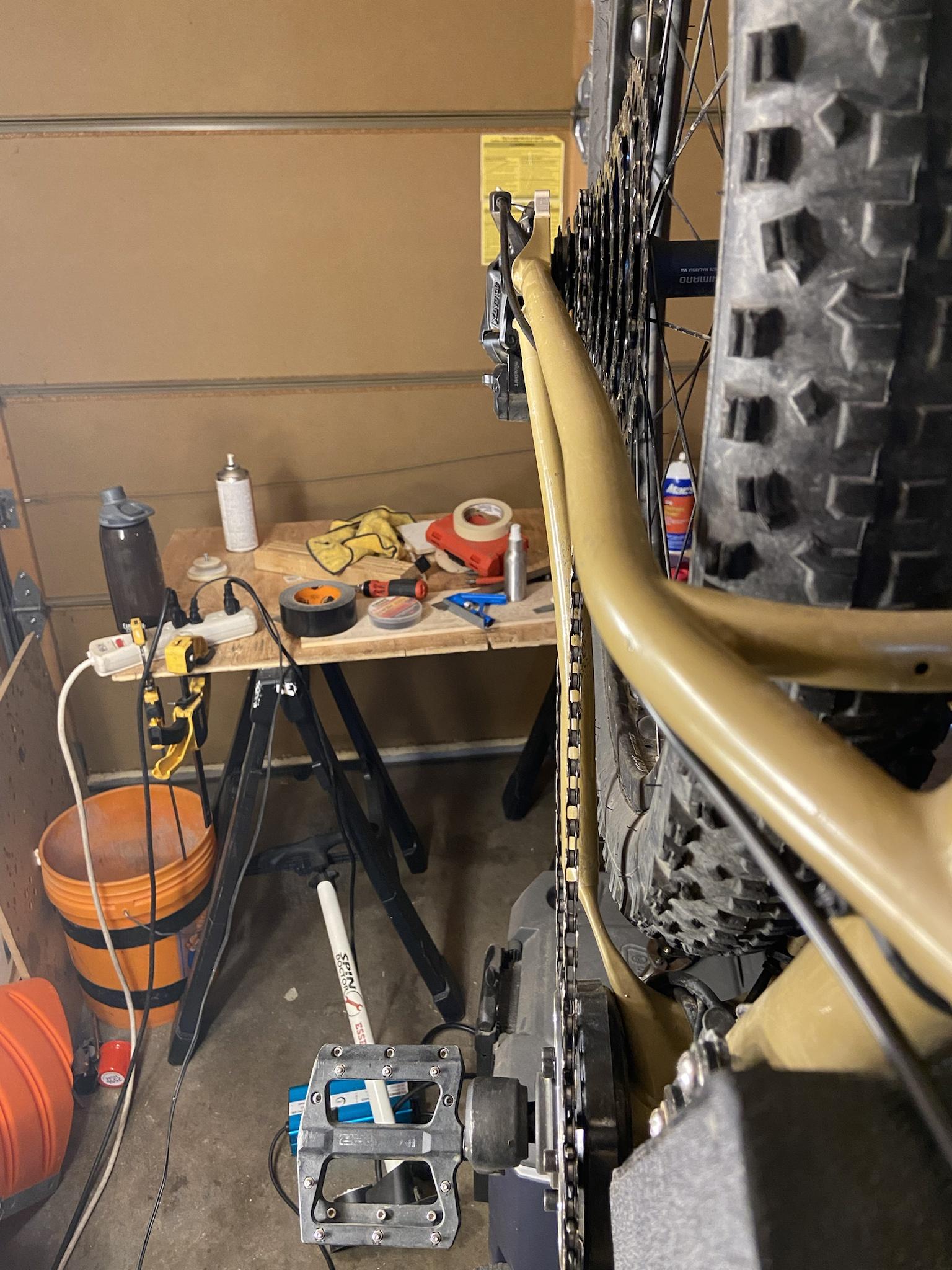

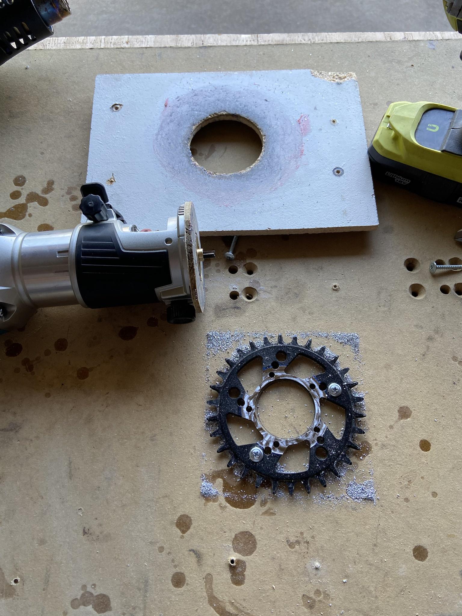

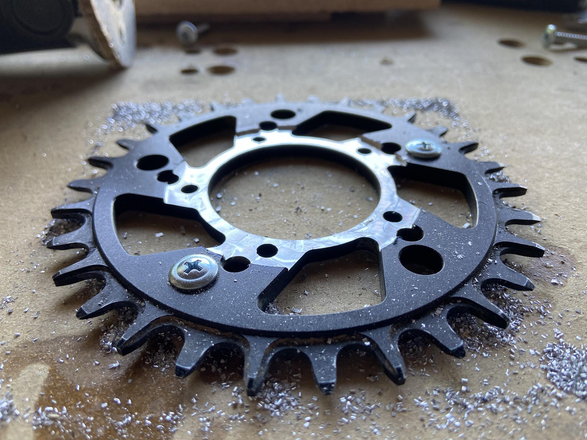

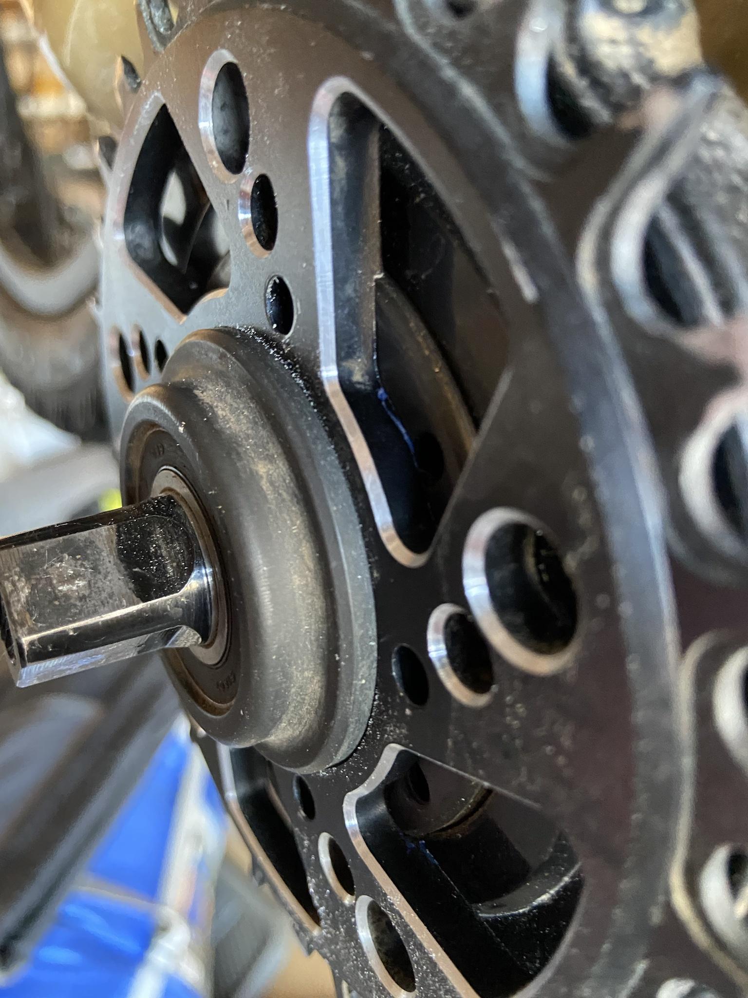

Since the bike is out of commission until I get my new dropouts in (adventx not compatible with direct mount), I decided to mill some material off the chainring to pull it inboard a bit. I wouldn't do this on a normal chainring but the luna 30t has an extremely thick (probably unnecessarily so) body.
It took a bit of work to make sure the ring was perfectly centered on my jig but I'm pleased with the end result. A router and a wood bit had no issues cutting through aluminum. This is one of a number of projects I've done that made me wish for a CNC machine.
I may go further and match the profile of the motor by creating another step but need to make sure that won't create any interference with the chain and gear case.
Dropouts came in today and I finally installed the AdventX. Very easy install with the right hanger. Earlier I said shifts weren't that crisp - that was based on just playing around with the shifter unloaded. While actually riding the bike the shifting feels pretty nice. As good or better than the SRAM SX eagle (1x12) on my other bike.
The chainline on the biggest gear is still pretty crooked even after milling the chainring down. There's room to move it in a few more mm so I might take some more material off the chainring when I get a chance. The good news is this cassette has a bigger range than what it replaced, so even if I never use the lowest gear I'll still have the same effective range as before.

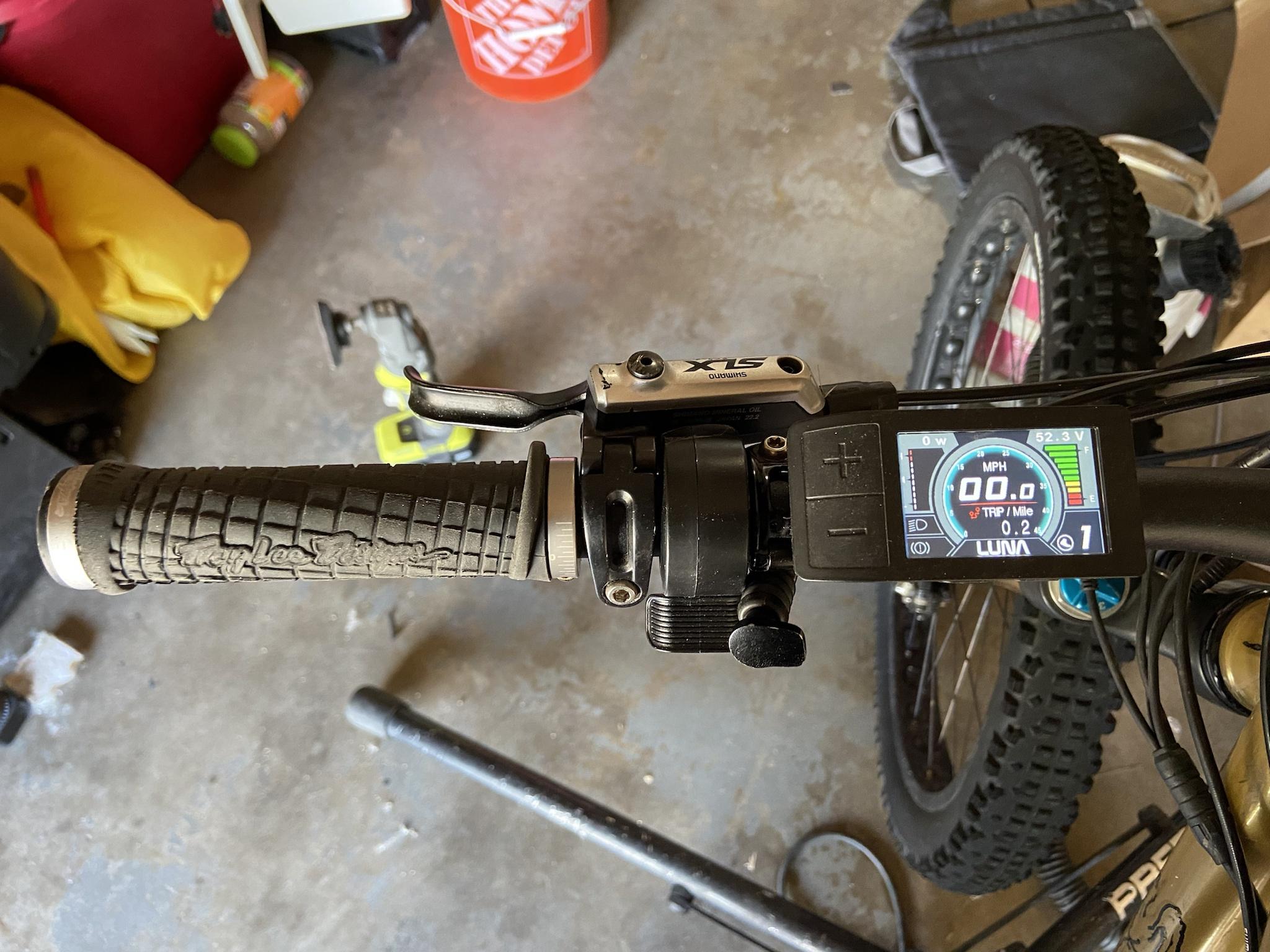

I replaced the paddle style throttle with the standard, universal thumb one. This tightened up the cockpit quite a bit. I also changed the throttle setting to use level 9 at all times - I think that's definitely the way to go for trail riding but will likely result in worse economy (i.e. I'll be lazier because it's more accessible).

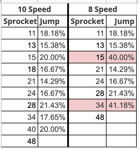

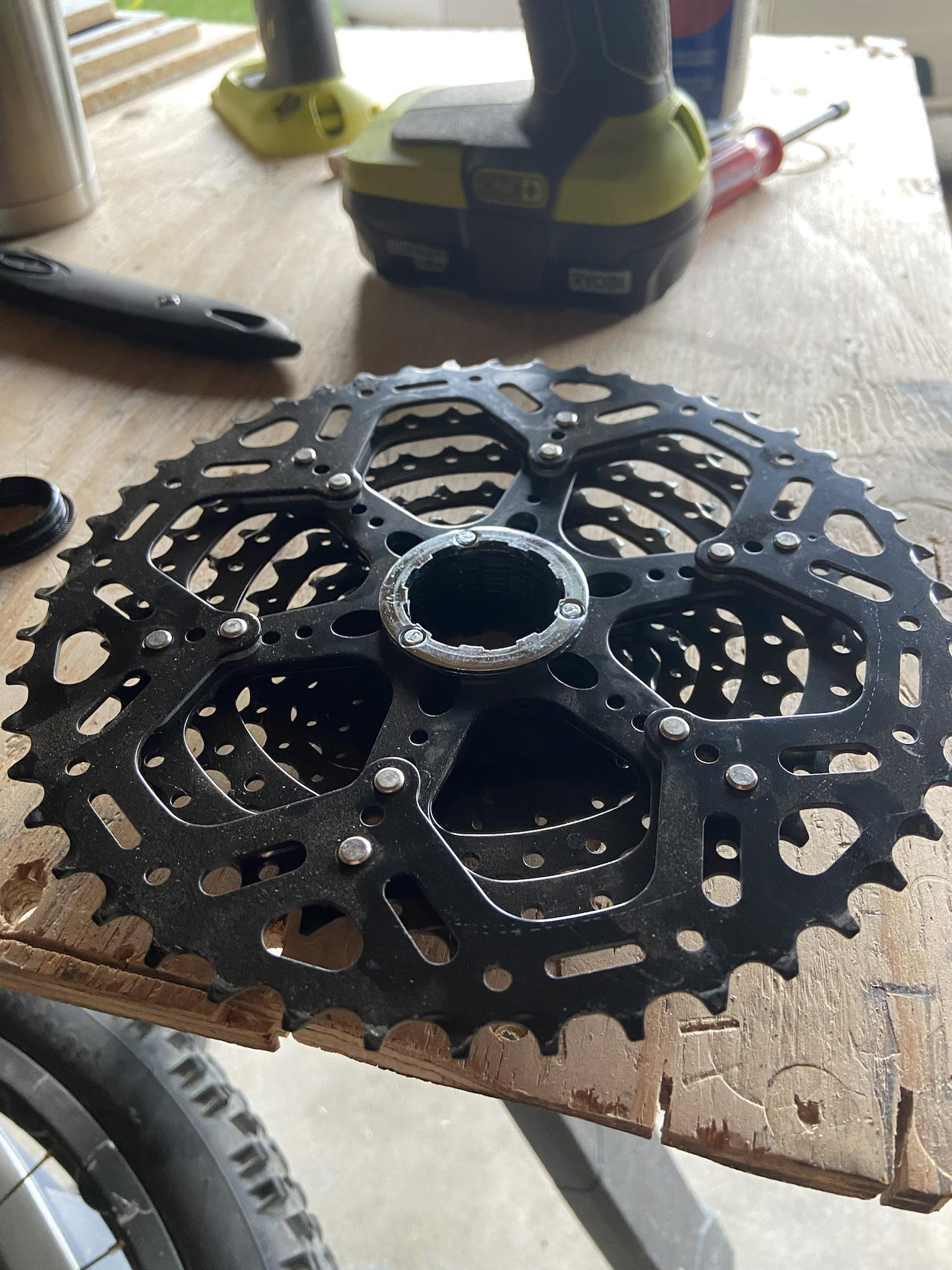

If you want the lower gears to have access to the full range, you might consider restacking the cassette and eliminate some of the in between gears, and use them as spacers, or get one of those spacer clamps. Seems like a common mod. I noticed on a lot of videos, people shift gears two at a time anyway. I think alignment on the larger cogs is important to avoid a potential failure.
I played around with that idea the other week, trying to mix and match sprockets from 8 and 10 speed cassettes, along with some spacers cut from 1.25" PVC (fun fact: that fits perfectly around a Shimano freehub) to make a 8 speed cassette with 10 speed spacing. It didn't work. I don't know if that was from mixing sprockets with 2 different thicknesses, my spacing was a little off, or the jump between sprockets was too big.
I don't think it's advisable to mix and match between cassettes. Just drop a couple of gears from your new cassette. I know if it were me, it would kill me to have that granny gear and not be able to use it. :x
You could use one of these (some place carry singles), then take out a couple of gears. When you get it working, make sure to use a little blue loctite on the set screw.
https://www.modernbike.com/gearclamp-single-speed-kit-shimano-sram
https://www.youtube.com/watch?v=1WBMpZv-pqE&t=575s
Yeah it definitely isn't recommended. The cog thickness difference was less than .2mm which might've been out of the shifter's tolerance range.

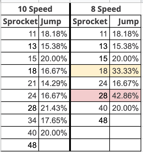

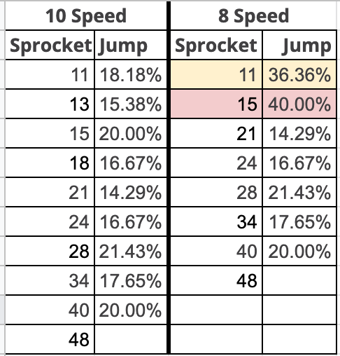

My only concern with removing sprockets is I'm going to have at least 1 shift with a 40% minimum jump in ratio and I'm not sure how that will affect shift performance.
One of these bottom 2 would be preferred as that would maintain more high speed range.
Unfortunately the Adventx cassette design isn't well suited to regearing - the pins will have to be drilled out. I don't really want to destroy a brand new part but I probably will.
