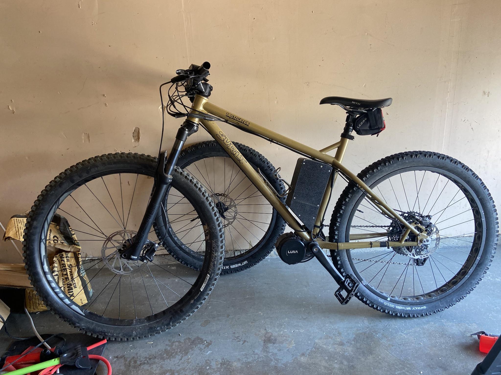

My rear tire is basically shot and I don't really want to spend $90 on an obscure and nearly obsolete tire size (26+), so I think I'll spend significantly more and convert the bike into a mullet: 29" front, 27.5" rear. If this calculator is accurate, I can run a 130mm 29er fork with minimal changes to the geometry. https://madscientistmtb.com/bike-geometry-calculator/
Fortunately I have a 29er with such a fork - I'm not going to cannibalize it, but that should swap directly over to the Instigator so I can see if this whole mullet thing is worth it.

27.5" rear.
I'm looking at this pic and wondering how close you'll be to the chainstays assuming the tire moves forward 3/4" or so. Are you going with the same width tire?

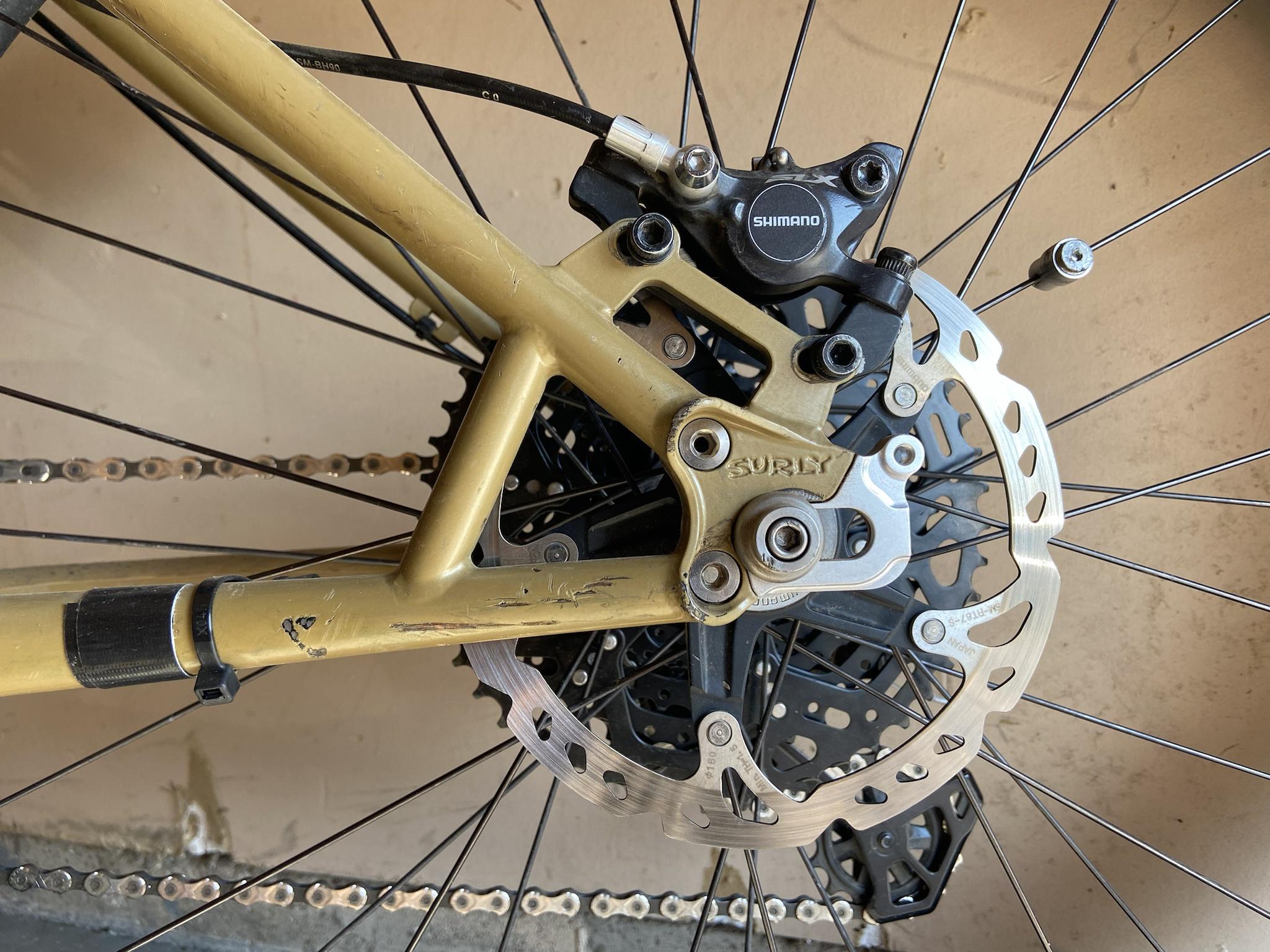

The new dropouts let me slide the wheel back nearly an inch so there shouldn't be clearance issues. I would probably go to a 2.6 or so.

This bike was designed for "26+" which has the same diameter as 27.5, so those would even fit on a stock, unmodified bike. However with new dropouts I should have room to run an even larger 27.5 tire.

So I threw the 29er fork on there and it's definitely a no-go - feels completely wrong. Glad I could try before buying. Well actually all I did was sit on it since the headtube was about an inch too short, but that's enough to know I don't want to go down this route.
