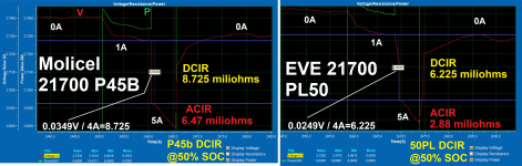

I tested the EVE 50PL sent by ZEUS-FL and I was impressed by the result. At 10C ( 50A ) and minimal air flow I was capable discharging these from 100-0% and got 4750mAh(10C) capacity out of the standard 4900mA at C/5.
I also got interesting ACIR and DCIR results. ACIr 2,88miliohms at 50% SOC and 22 degree C You can compare with the P45B
DCIR curve of 5 samples vs SOC @23c
capacity test cycling profile:
