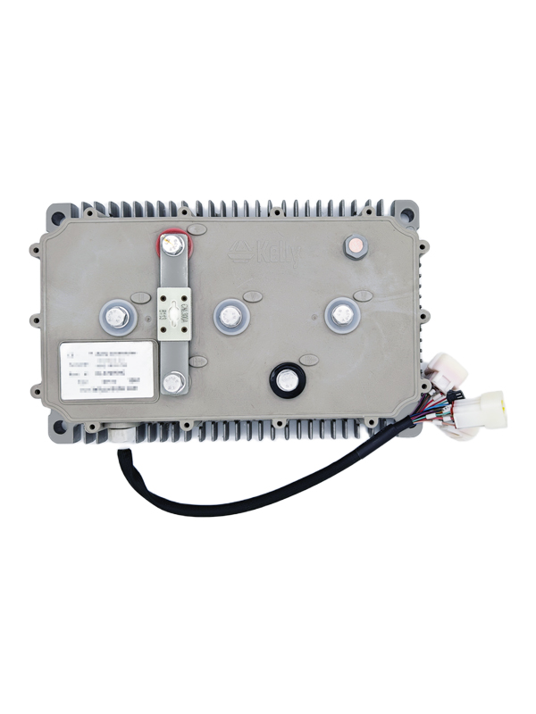

I'm getting a 2-2 error code on my Kelly Controller when I add my head lights to the accessory wire. The motor works correctly when the lights are not added in. The lights work correctly when they are added in, but the motor stops due to the fault.
The manual describes the 2-2 error code as an Internal Volts Fault. It tells me to:
1. Measure that B+ & PWR are correct when measured to B- or RTN.
2. There may be excessive load on the +5V supply Kelly KLS-H Sinusoidal Brushless Permanent Magnet Motor Controller User’s Manual V 1.2 29 caused by too low a value of Regen or throttle potentiometers or incorrect wiring.
3. Controller is damaged. Contact Kelly about a warranty repair.
4. If this error code occurs, the relay function on plin9 will be deactivated.
My guess is option number 2, since it only happens when I add in the light. But, I don't fully understand what it's talking about. Can you all help me understand what the problem could be, give me ideas for trouble shooting, and/or just throw anything at me that might help?
That’s what doesn’t make sense to me. The light is on the 12v accessory line.

What voltage is the light intended to run on?
How much current (amps) does the light take?
The 12v in the controller is usually used to run the gate drivers that turn the FETs on and off to run the motor, *and* to run the 5v regulator that then runs the MCU, halls, throttle, etc.
If the current draw on that line is too high, it won't be able to do the job it's meant for, and if it's high enough it can damage it. It is not intended to run lights or other accessories, only controller-critical items. .
Normally lighting is run from a separate DC-DC powered directly off your traction battery. That DC-DC has to be able to supply *at least* as much current as all the things it has to power; I recommend getting one that can handle more than twice the amps all those things will take, total, since many of these are rated higher than they're actually capable of.

Ok, well, if your'e still using the same controller as before, it only has 40mA, or 0.040A, available on it's 12v line.
So it cannot run the lights and controller, etc. You'll need a completley separate power supply (DC-DC) that takes your battery voltage and converts it to 12v**** for the lights.
****If the lights are intended for cars, motorcycles, etc., they are actually "automotive 12v" which is really about 13.6-14.4v, so make sure your DC-DC outputs that much, or the lights won't be as bright as they should be.
Also note that light says it has a blue halo. In some places, blue lights are illegal except on emergency vehicles, so you may want to check your local laws about that, or just leave the halo disconnected and unused. The item also has some bad reviews that indicate you're likely to have to take it apart to either rewire it or to physically modify it so that it works as it should.
