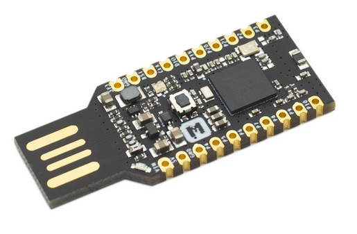

Developing the ANT+ and Bluetooth board firmware
And for developing ANT+, I don´t find almost nothing on web. Seems there are no one DIY their own sensors...

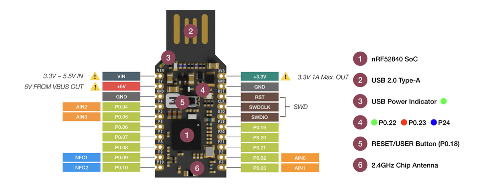

At least there are small and cheap NRF52840 boards on ebay, as also Arduino with NRF52840.
I was looking at NRF52 SDK and I fond there and example of firmware that runs both Bluetooth and ANT+, this is what what we need!!
Here is the example on SDK: nRF5_SDK_12.3.0_d7731ad/examples/multiprotocol/ble_ant_app_hrm and the notes on main.c file:

@Casainho the nRF52840 board arrived today. It looks like we need the S340 softdevice for concurrent BLE+ANT support which needs registration and manual activation for the download. I hope our usecase counts as "Evaluation Use". :eek:
i dont think we are allowed to redistribute the softdevice, so every user may have to register and wait for activation for their own :(
if the project reaches a working state, we may ask for an open-source exception, as we are not evaluating for commercial purposes. The non-ANT softdevices (like S140) allow redistributon. maybe it is easy to have two builds, one BLE only with S140 and one with BLE+ANT for ANT users.
That was fast!!
So they say:
Evaluation Use:
• Not to be used for any commercial or revenue-generating purpose.
I will not be selling anything and not having any revenue-generation purpose, so, I have not problem with it.
I hope we can distribute our firmware final HEX file and put a note on download, explaining that users should not use for any commercial or revenue-generating purpose, otherwise they should license with ANT - this will be the case of current shops selling TSDZ2 with the OpenSource firmware installed.
My suggestion is for you to reuse the project of the SW102, because it uses an NRF51 microcontroller and has a good Makefile to deal with softdevice, etc. The current version implements UART over BLE with pairing - the code for the cycling profiles are not active but I think they should work simultaneous if you enable the code again.
This board should be like a SW102 display but without the display itself.
And for ANT+ and Bluetooth, then follow the Nordic example of SDK that has both Bluetooth and ANT+ working simultaneous.
Maybe the easiest way to start, would be to read an ANT+ HR band/watch sensor (that are cheap and maybe you even have one) and just bridge the motor communications to your current display AND overwrite the motor temperature value byte with the HR data - then you can see your heart rate on your 860 display, even plot on the graph :) -- I know this seems out of the topic of this project BUT this would be a good way to expand 860C and SW102 displays, to add support to some ANT+ sensors like heart rate -- I would love to have heart rate, I want to train for heart rate zones and I have heart rate always on my pulse watch that is always broadcasting the value over ANT+.

@casainho: i had no time to start playing around with the dongle yet and i dont know when i will find the time. :?
Using the SW display source tree sounds like a good idea - it would be nice to add the wireless dongle as 4th display and keep it in the main Color_LCD repository.
orangecrumble said:

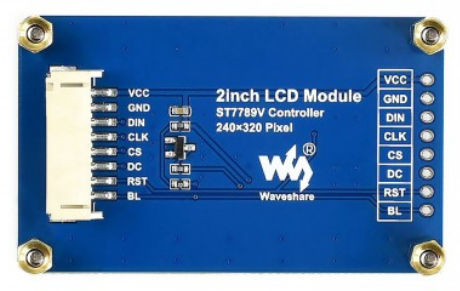

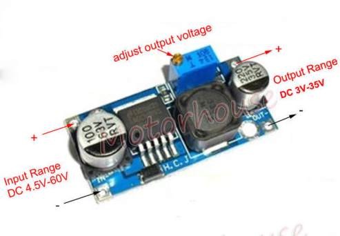

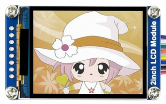

I was looking for how to build a cheap wireless display and DIY, and with small size if possible, 3D print enclosure and with battery or power from the ebike battery.
Costs
1. wireless microcontroller board: 12€
2. display 2'' IPS screen, 240×320: 10€
3. 60V to 5V converter module: 2.5€
4. 3D print enclosure and other bits: 5€
TOTAL: 30€
I like to idea to have a relative small, cheap and very flexible display - one that If I burn for some reason, I can easily repair and exchange only the damaged parts.
Wireless microcontroller board
This is always the same board based on NRF52840 microcontroller with BLE and ANT+, 1MBytes flash memory (8x more memory than the SW102). This board can be used to connect to the TSDZ2 motor, for a remote button or display.
The wireless board costs 12€ with the full flexibility for us to implement what we want:
It can be powered from 3.3V up to 5.5V, meaning directly from a lithium battery or 5V. It has also an RTC, meaning while it is powered it will keep the clock time. And this board should be very low power, I think it can be powered from a coin cell, for when building an ANT+ remote button:
Display
There is a 10€, 2'' IPS screen, 240×320 resolution that seems good, not to big and not to small: https://www.waveshare.com/product/displays/lcd-oled/lcd-oled-3/2inch-lcd-module.htm
60V to 5V converter
The 60V to 5V converter module is this one, found on ebay:

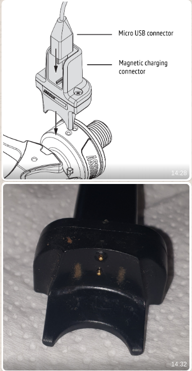

The wireless board is ready to have the VLCD5 button wires soldered. Then, the coin cell powers the board and the firmware will have the be optimized for the button to work at least 1 year with the same coin cell.
Optimimizations
- the wireless board can be cut to remove the USB connector (will be 30% smaller)
- I think a 3D print case can be built to replace the VLCD5 base part original one (the one that attach to handle bar), but keeping the buttons board and the soft keypad that also provides water proofing. This way the wireless board and the coin cell could be inside the full button case, this way making a fully wireless water prof button for about 20€ and not 80€ (seems the Garmin ANT+ specific ebike button costs like 80€ or more).
This display can be fully water prof if there is no connection to outside.

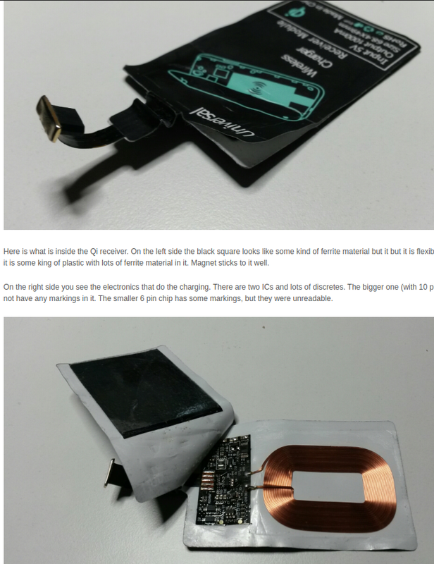

If we put a battery inside and a board for wireless charging, then, there will be no need for connection to outside.
https://www.epanorama.net/blog/2016/04/27/qi-receiver-teardown/

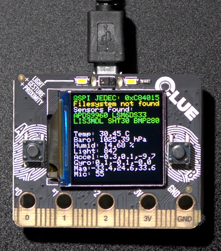

Here is an good example of an cycling computer done with the exactly same microcontroller NRF52840:
[youtube]viR-2dUP55g[/youtube]
That board is nice however has a small screen and to large board, so, BIG bezels and not good looking.
That is why I decided to buy this display because the microcontroller board is smaller than it, so, hopefully the bezels will be much smaller.
casainho said:
Another interesting thing is that they are using metal contacts for detecting touch, this is the capacitive touch detection with the microcontroller libraries.
Maybe we can take advantage of that, by using small metal screens on the 3D printed enclosure and use the metal contacts on outside as button, to make buttons but water prof.
Other idea for charging from outside, using the same metallic screws as pins:
[/quote]

i finally had 2 hours time to play with my dongle. sadly i did not get very far as i had problems flashing the firmware.
basically the same as here but nothing helped to get the usb flashing to work. dongle was recognized by OS, slowly red pulsing - nothing worked. i tested it on linux and windows. on linux i also applied the udev rules and added my user to the correct group.
my "fix" now was to add some layers of electric tape to the back of the usb plug so it fits tightly into the USB port. After a reboot(!) it started to work then on linux. strange that is was recognized and identified so i could select it on the connect application but was unable to communicate.
