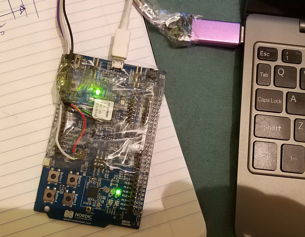

i finally had 2 hours time to play with my dongle. sadly i did not get very far as i had problems flashing the firmware.

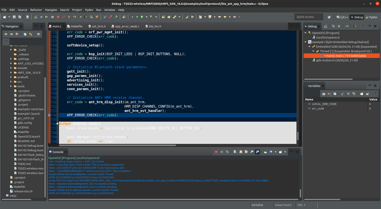

What I would do:
- make a copy of TSDZ2 firmware folder and change the Makefile or the needed files to build for the NRF52840
- make a very simple main loop code to control the RGB led on the board
- flash and debug using the STLinkV2, just like on the TSDZ2
Using STLinkV2 is very fast for development, for flashing the firmware! And debug!
I would not use the Arduino but the Nordic SDK example code that implements both Bluetooth and Heart Rate sensor on ANT+. We do not need much more than this: control the motor as if we are a display; implement ANT+ LEV display and send and receive Bluetooth UART data to mobile app. All of this is already done on SW102 except the ANT+ LEV.
For the wireless display, I would reuse the SW102 code, because it has the custom fields code.

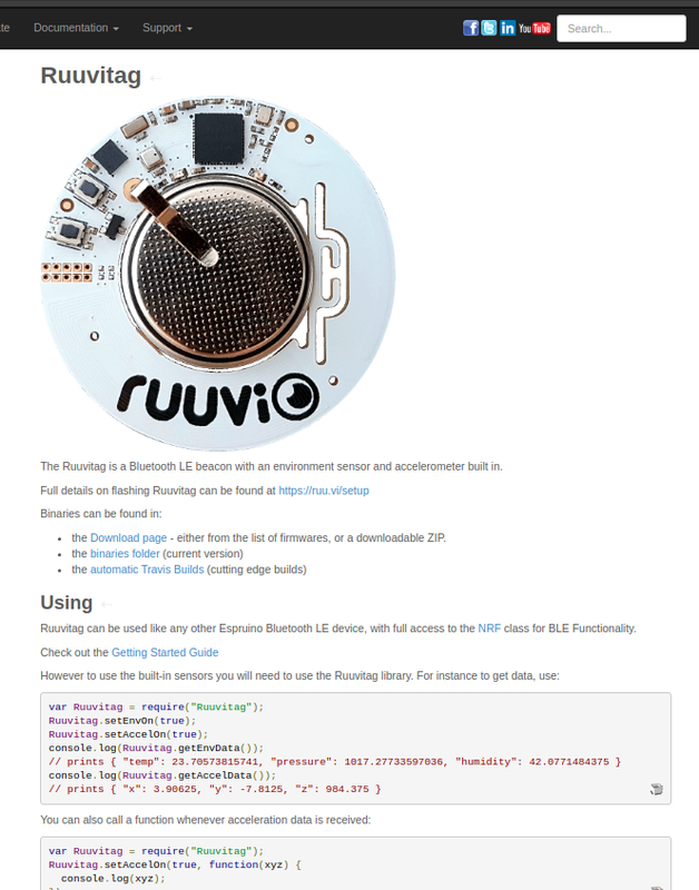

High level languages for fast development of UI display
I was looking for high level languages available for NRF5840, because this is very popular and have 1Mbytes of flash memory, which is a lot hence the high level languages available.
The potential advantages I see comparing to use current SW102 display firmware:
- faster developing and more advanced graphics (I hope there is a graphical framework)
- faster developing
I am not an high level developer so this is new to me. Maybe there are more developers here more experienced that can help.

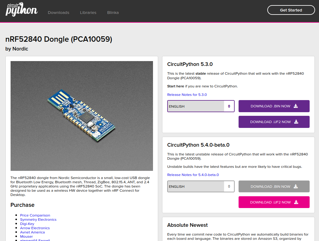

Python
Seems there is no support for ANT+. There are guides about creating C code module for Pyhton so I guess it could be a way to have ANT+ implemented using the example from Nordic.
Javascript
Seems there is no support for ANT+...

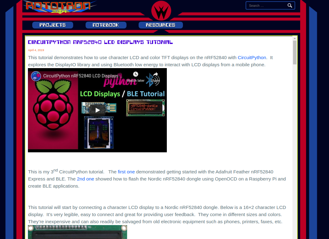

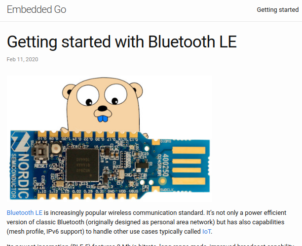

Go
Article for embedded Go using our microcontroller:

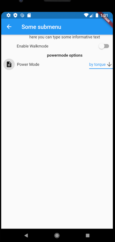

in my opinion, it would be better to make an smartphone app that works over bluetooth as bike computer and configuration interface, because
  • Smartphones are cheap and getting cheaper every year. Most people already own one so the cost would be just an phone holder and maybe a waterproof case. Most people use their bike as tracking/street bike and not for MTB. but even MTB user can use old low-value phones, ebay is full of old phones with some scratches on the display. there are also brand new phones for <50€ example1, example2, a lot more on ebay search. so if you damage one you can always and quickly get a cheap replacement. I have tested 3 phones in this price class last year and was impressed by what you get for the money.
  • Developing for android or even better multi-plattform would be more future-proof as android hardware is manufactured independently. if we stick to one hardware it may be abadoned by the manufacturer sooner or later. i think it is safe to say that we will still have android phones in 10 years. also supporting multiple boards/screens means a lot of work which is already covered by android (adapting to different screen resulutions, cpu models and so on).
  • I think many DIY ebike batteries already come with a usb charging port, so power should be no problem. getting an 60v-to-USB-Power adapter should be also pretty standard.
  • there are already multiple bluetooth bike buttons in the <20€ price range. i expect their batteries to last for years, but if you are afraid you can get yourself a replacement battery or a full replacement button just in case. also with smartphone, you have a touchscreen as fallback. the button can directly connect to the dongle so if your phone breaks, you will still be able to control the motor.
  • there are already open source bike computer solutions out there that we could adapt. BoD/bikey, inv2004/cycle-computer (supports ANT+ somehow) and more.
  • even if we start with a new app (for cross-plattform and a clean codebase), development on smartphones is more easy, quicker and has more possibilities as smartphones come with a lot of sensors and connectivity. also a very important fact is that we can use many libraries that make progressing easier like the osm android SDK and gadgetbridge and also a full-featured emulator with debugging.
  • the ANT stuff can be handled by our dongle and passed to the smartphone.

I will do the dongle, I have some professional experience with NRF52.

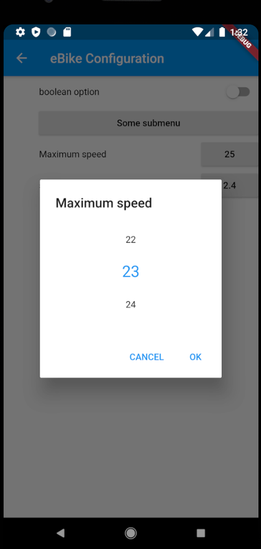

i have not finally decided, but this is what i have in mind for version 1 of the app:
  • configuration of the motor settings
  • a main screen with similar in informations and features as the current 850/860
  • maximum portability (android/iphone at least)
  • possibility to use the main screen as application overlay (similar to google maps or youtube in background mode)
especially with the overlay feature, you can use any navigation app you like and still have a display of speed, assist level and more on screen.
one thing i currently think about is the communication protocol; my idea is to not just send the uart package over bluetooth but to create a new easier to understand/debug and more portable and extensible protocol based on JSON. afaik currently the display and controller firmware needs to match very closely because they need to have the same definition of how the binary uart data is parsed into its struct, even on data type level. while this is fine for cable-connected hardware, for wireless stuff it would be good if everything works even if the versions do not match closely. i.e. if a want to ride a friends bike with older firmware using my phones app.
maintaining backward compatibility in a structured data format like JSON is easier because you can add new fields at any position without breaking old stuff.
i will take a look at the esp32 project how they have solved it.
im also currently not sure if we stick to BLE or if we should support bluetooth4 (for the old phone use-case). on bluetooth 4 we would exchange packets over a serial channel while in BLE we can exchange data by defining characteristics endpoints.

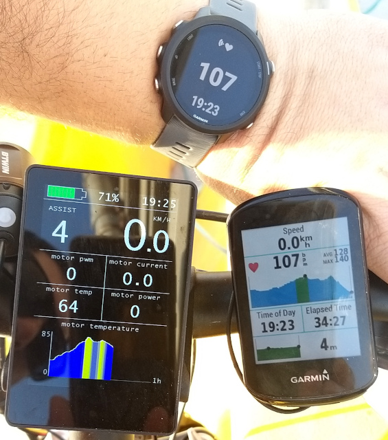

And with Android, I guess is possible to build DIY, a specific display to run Android and the Ebike app.
For me is really important the fitness metrics of Firstbeat/Garmin, so, I have no choice to buy and use a Garmin device. And so, there is no point to have big expectations for the mobile app on phone or display.
But when I ride on the city, I would like to have discrete, easy removable, small and cheap display. That would be Garmin Edge 130 with a 1.8'' display:
But that model does not support ebikes nor custom apps.

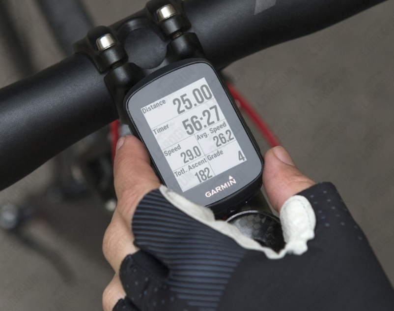

So my plan is to make a display similar to Edge 130 in size but with my firmware based on 860C/SW102, with customized fields. And additionally to 860C/SW102, I want it to be ANT+ ebike display, automatically connect to heart rate sensors and show the value on a field. The heart rate will be from my Garmin watch and the display will be bale to work as ANT+ extended display of my watch, so my watch does the fitness metrics and I can see on the display in real time + TSDZ2 data + send TSDZ2 data as cycling sensor to the watch.
I do not expect to ever implement navigation and advanced fitness metrics.
The last point is nice and could be optional for a first version, the other points are the minimum.

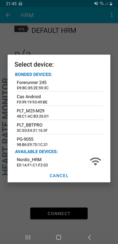

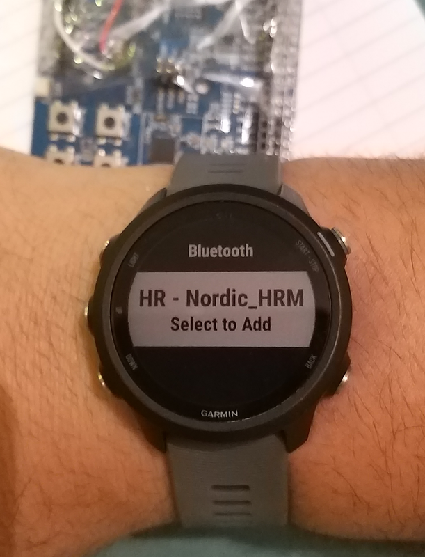

I have no idea about this... and on NRF52840 board, I will try to use the sample code of Bluetooth firmware they provide. On SW102 is BLE because I could not use most of the terminal UART apps available until I found that the issue was that only new apps with support to BLE would work. So, if possible, we should go with BLE.

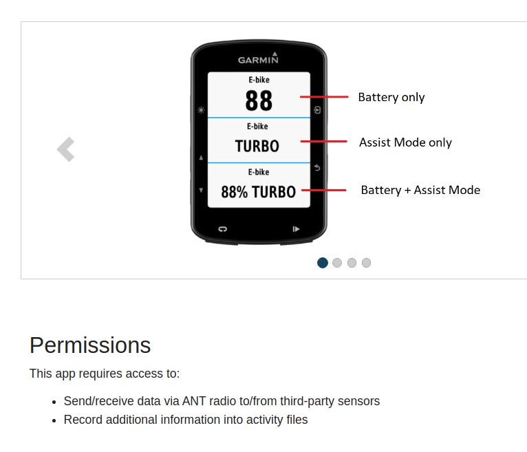

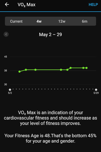

yes, long battery live (1 week+) and always on is something i am used to now. is there a garmin model you would call a real pebble alternative? my pebble works fine, i have repaired it a bit (screen connector loose problem) and made my own strap :) i am just missing a pulse sensor.
Garmin are way more advanced right now, mainly of the fitness algorithms. On Garmin line, you need to decide if you want a watch for some oriented sport or a more casual watch. I decided to buy one for running for 210€, the Forerunner 245. If I want even more advanced metrics for running, I need to buy the Forerunner 945 for 600€ (there is a middle one 645).

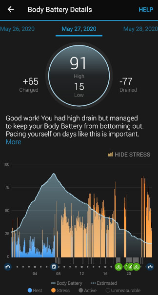

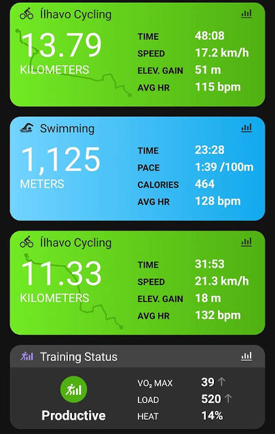

Yesterday I went with my TSDZ2 ebike to the beach and did a swim:
With a multisport watch I could probably have one activity with that ones, because they have triathlon activity type. Still, the two cycling activity were recorded with the Edge on the bicycle that was receiving my heart rate from the watch. The integration of different sensors and devices, is very good.
So, you pay for the features. And select a model that have CIQ apps, the custom apps we can develop. This ones can communicate with a Bluetooth and ANT+ devices, etc. There are no watches with ANT+ LEV ebike but we can make a app for it.

Here is my use case for wireless TSDZ2 ebike.
My body battery, changes depending on my sleeping quality, stress (or being hill, detected on heart HRV) and sport activity:

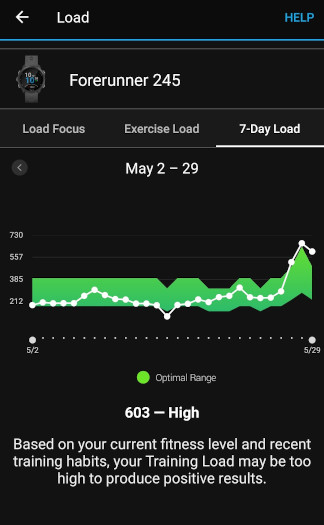

Training load, tell me I should probably rest on next 2 days:
And my VO2 Max slowly increasing since I started to run and doing the rest of efforts like swimming, cycling, eat less:
Now I am merging all this with cycling, where I can see my heart rate while cycling and deciding to use lower motor assistance as I want to workout more / be on a specific heart rate range:
Yesterday I went again to the beach at the end of the day. I wanted to workout, to be at a specific heart rate value and that is why I need a display to show that to me - look at that graph, that is where I took the idea for wanting graphs on TSDZ2 display. Note that my watch was measuring my HR and broadcasting to the Edge.
I also wanted to do the 17 kms from home to beach relatively fast, specially on long, plane and large cycle paths. I also had to manage the TSDZ2 max temperature, to avoid the motor power reduction, as seen on the 860C graph. Note that 860C has a very bright and good quality display!!
With this project in future, I will remove the 860C and use only the Edge. Edge will be able to control the TSDZ2 as a wireless standard EBike (ANT+ LEV). And because Garmin Edge support custom apps, I will be able to create a custom widget that is a graph to specifically show the TSDZ2 motor temperature - so, using Edge will be like having 850C/860C customs fields and graphs + Garmin health / fitness metrics.

i have finished my concept of the configuration screen and JSON structure. i expect it to change a bit over time, but now we have at least something we can discuss about.
here is my draft of how the configuration that is sent from the dongle to the app looks like:
Code:
  "version": 0.1,
  "config": [
      "type": "bool",
      "label": "boolean option",
      "key": "enable_walkmode",
      "value": false
      "type": "menu",
      "label": "Some submenu",
      "key": "some_submenu",
      "children": [
          "type": "text",
          "label": "here you can type some informative text"
          "type": "bool",
          "label": "Enable Walkmode",
          "value": false
          "type": "title",
          "label": "powermode options"
          "type": "enum",
          "label": "Power Mode",
          "key": "power_mode",
          "value": "TORQUE",
          "choices": {
            "TORQUE": "by torque",
            "POWER": "by Power",
            "SLOPE": "by Slope"
          "info": "Some description\nof the power modes\n\nRTFM!"
      "type": "number",
      "label": "Maximum speed",
      "key": "max_speed",
      "value": 25,
      "min": 0,
      "max": 50,
      "step": 1
      "type": "number",
      "label": "something with two decimal places",
      "key": "some_decimal",
      "value": 2.4,
      "min": 0,
      "max": 5,
      "decimal": 2
the configuration screen that gets generated from this json looks like this:
the "info" field can be added to any field type and is optional. i thought it would be nice if you could give some info for more complex options.
everything that has a value also has a key so we have something to reference when sending the configuration back to the dongle. i have not yet decided if the returning configuration values will be nested in the same tree or just one flat key:value object. for the key:value object, the keys need to be unique while for the nested stuff the submenus need a key too.
having a key on the submenu will also allow it to be translated later (a translation definition could override the labels based on the keys).
the enum type is currently only a string-enum. it would be possible to implement an int-enum but i was not sure if this makes something easier.
the number type can either be decimal or int (defined by the decimal field). currently, if it is decimal, the step field is not supported, it only works for int. min and max value is always required, step and decimal is optional.
while the configuration menu on the 860c is used for configuring the motor, the display and to show diagnostic values, the configuration menu expressed by this JSON is only used for dongle/motor configuration. if the app is started or the config screen is opened, the configuration will be fetched once. when the configuration is closed, the values will also be transfered to the motor once.
for diagnostic and frequently changing values (assist level) we will use different endpoints.
if you want to try youtself, here is the apk: https://easyupload.io/cgasmh the example config file is compiled in.
any comments or ideas on this?
my next step is to add bluetooth functionality and design the bluetooth api by adopting some Nordic NRF example with my dongle.

On my side, testing the sample code for receiving HR from an ANT+ HR sensor and send it as a BLE HR sensor:
I have an old board with NRF52832 and I flash and debug with the cheap STLinkV2:
Flash and debug:
The important line added to Makefile, to make a hex file that include the Softdevice and the application:
Code:
	$(SREC_PATH)srec_cat $(SOFT_DEVICE) -Intel $(OUTPUT_DIRECTORY)/nrf52832_xxaa.hex -Intel -Output $(OUTPUT_DIRECTORY)/TSDZ2_wireless.hex
And the HR sensor on BLE, on mobile phone:
I could not yet understand how to connect an ANT+ sensor to the board... the instructions of the example code says about using another board running another example code, which I don't have. Anyway, I was exploring on my watch and at least it could see and connect to the BLE HR sensor:
This testing code is here: https://github.com/OpenSource-EBike-firmware/TSDZ2_wireless
My board is missing the antenna, there is the connector to it but I lost the antenna.
I tested 3 different example codes of Nordic SDK ANT+ (with 2 different softdevice versions) and none of them worked, still, the code that implemented Bluetooth and ANT+ simultaneous, the Bluetooth works as expected. My plan now is to wait for the NRF52840 boards I bought for this project, that will take probably more 3 weeks to arrive. I will take this time to learn more about the ANT+ LEV profile, as there is no sample code on the Nordic SDK.
casainho said:

If you really do tours, maybe you should go with a Garmin Edge because it supports ANT+ LEV profile and you can have your custom fields and apps to get the specific TSDZ2 data, show graphs on display and can record an cycling activity where you can inject some TSDZ2 variables that will be shown on the Garmin app graphs, like other regular variable as heart rate, temperature, elevation, etc. -- this is the FIT file, also part of ANT. FIT file is a record from an activity where you can also inject your variables other the ones that the Edge already records.
Other option, could be a DIY display. Maybe with a powerful processor to be able for fast development and nice graphics. Or just low processing power and just simple data as you say.
Even other option could be the Edge 130:
- 860C display on EU costs 100€
- Garmin Edge 130 on EU costs 122€
[youtube]j_Q8xvdUsIA[/youtube]
Advantages of Edge 130:
- shows EBike data
- almost for sure can show TSDZ2 specific data
- Ebike control would be with wireless button that connects directly to Ebike wireless board (so Edge 130 is optional, you don need to be using it always to use your ebike)
- Garmin common features like many customized fields and layouts (where we can develop our own TSDZ2 Ebike fields)
- record cycling activities with added TSDZ2 motor data that can later be seen on Garmin mobile app graphs
See this ANT+ ebike field developed by an user: https://apps.garmin.com/en-US/apps/1532f0d9-fd19-4b63-b038-435d8fd670a4
