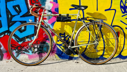

Hi everybody, I just mounted my very first TSDZ2B on my vintage 1975 Motobecane bike.
The bike rides like a charm despite its old age. I dont plan on going faster than 25kph on street mode and sometimes 30kph on off-road mode.

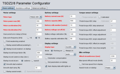

I'm pretty happy with the stock firmware but I'm planning on switching the display to an SW102, so i must flash the motor with OSF (as well as the SW102).
I could use the default OSF config but I would like to exploit the optimal capabilities of my setup by tweaking the parameters via emmebrusa JavaConfigurator.
My motor is a TSDZ2B 36V 250W and the battery is a 36V 7Ah.
How sensitive are the parameters in red?
Can you confirm the first 4 parameters in motor settings and in battery settings are correct?
- motor type : 36V
- motor power max : 500W or 250W (i am not sure)
- motor acceleration : 35
- motor deceleration : 35
- battery current max : 16A
- battery capacity : 252Wh (7x36V)
- battery cells number : 10
- battery voltage cut off : 29
Also, display type, it doesnt have the SW102 but if i set it up to 850C (bafang display), it should be compatible?
Also, if you have any recommendation, i'd be glad to read them!
Thank you very much in advance!
