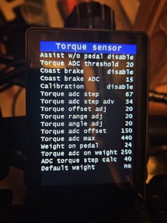

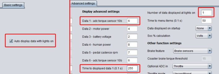

Regarding the OSF testing, the assistance is way smoother after calibrating the torque sensor to the 160-450 range and changing the motor deceleration to 80. However, I didn't have time to test it thoroughly. I only did two short rides.
I don't know if @mstrens mentioned that, but when I checked the torque sensor readings on my unit, the values for no-load and max load were 160 and 450. The TSDZ2 has a default range of 150-300. The OSF uses that range by default. This might also cause the motor assistance to be too sensitive.
It would be good if someone could check this on their unit. To do that, you have to set the displayed data 1 to "adc torque sensor 10b". Set "Number of data displayed at lights on" to 1. And set "Time to displayed data 1 (0.1s)" to 255 in the "Advanced settings" tab. Please also check that "Auto display data with lights on" is enabled in the "Basic settings" tab.
When the config is flashed, power up the display. Turn on the lights (click the power button on VLCD5 or hold the + button on 860C, EKD01). Read the value. In my case, it was 16. Position the right crank arm horizontally to the ground and step on the right pedal with your whole body mass to see the max value. In my case, it was 45.

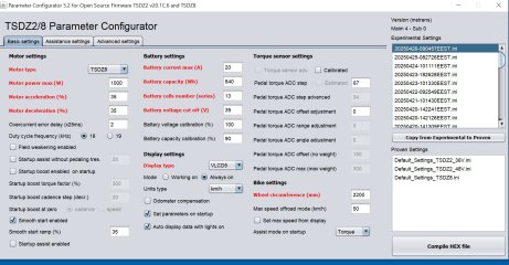

Perhaps you can try to change some settings in the javaconfigurator (for VLCD5 version). It seems that max torque value for TSDZ8 is around 450 instead of 300. It seems also that increasing the value of deceleration up to 80 or 90 also help.
Some other users could perhaps share here their settings.

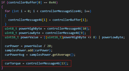

@mstrens I am not sure what exactly you did to port osf to the tsdz8. So i don't know about the differences to the tsdz2. And i have absolutely no knowledge in the whole project so far. Right now i am diving into the code to understand how it works.
I did not find any multisampling or averaging over time of the torque sensor in the code. Can you confirm this?
My current hypothesis is, that the torque sensors of the tsdz8 and tsdz2 electromechanical behave differently. I assume that the "old" sensor took a few hundred ms to read its real value whereas the "new" sensor is way faster and nearly immediately reads the real value.
I just checked the "adc torque sensor 10b" data on my tsdz8 and it is kinda instantly changing when appying force.
The funny thing is that running the original firmware and reading out the torque value from the 0x46 messages it easily takes 3-5 seconds to go back to zero after hitting the pedals really hard. So i assume, tonghsheng added some sensor multisampling here...
I will setup my dev env now... :)
Edit: I proofed myself wrong. I added a 1s averaging to the torque sensor but it is still jerky. But it helped a little bit...
I made 72 km trip today. Last 40 km I rode 2.53 gear ratio (38 teeth chain ring and 15 teeth cog) and speed was 25 – 30 km/h. firmware worked very very well. Motor was working very smoothly. No jerking at all.
I made little changes to yesterdays configs. Set amps from 16 to 20, and increased max power to 1000 watts and rode on torque mode. I didn’t notice big difference on motor behavior. Assist values are too high on turbo level. Assist do not get any better from sport level.

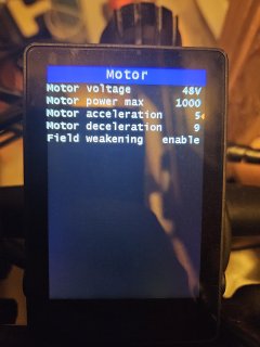

After the first tests of 860c on the original settings in power mode there is jerking but changing dec in the motor settings to 8-9, acc I also increased it to 7, I increased the torque sensor range to 450 from 300 and it works very well, I uploaded hex 860c yesterday, all night without a battery and nothing happens with the settings after turn on today. I also tested if it will work with sw102 version v20 5.hex but there is error e06.
I rode with 860C display first with settings of TSDZ2 which was in display. TSDZ8 motor worked well. Then I checked torque sensor calibration. ADC value on pedal without push was 157 and standing on pedal 223 (From TSDZ2 which was on bike before TSDZ8). Then I checked TSDZ8 values and those were 176 and 423. I set them and start riding and assist was very poor. I set back old values of TSDZ2 and assist was good again.

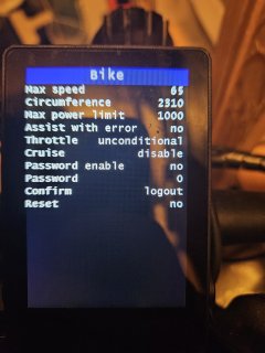

Hello everyone. Last weekend I tried OSF on my bike. This is my first experience with OSF. I use the EKD01 display. I can confirm the findings that others have gained, especially the unevenness of the assistance. I will continue to try, but for now I put back the FW from FB, which I am quite satisfied with.
The same file as on ebikestuff.eu: "TSZ8_750W_test3.0_20240802.hex"
After few days of tests the osf version with 860c also has similar problems as the previous ones, they do not always happen and to varying degrees but the situation on my bike is that after a longer standstill with the battery turned off despite the previous good work of the set even in power mode, after turning it on again the engine fluctuates to a greater or lesser extent in all modes related to the torque sensor, only cadence and throttle work ok. I tried to change various settings to find out what is causing it but I did not succeed, changing the settings after the error appears helps a little but not much and the engine does not work as smoothly as before turning it off, and today I had such a situation that no changes in the menu helped. However, resetting the 860c to the factory settings and re-setting the original settings (which I am posting in the attachment) helps and then it works well in all modes (including power mode) until the next turn off.

After few days tests the osf version with 860c also has similar problems as the previous ones, they do not always happen and to varying degrees but the situation on my bike is that after a longer standstill with the battery turned off despite the previous good work of the set even in power mode, after turning it on again the engine fluctuates to a greater or lesser extent in all modes related to the torque sensor, only cadence and throttle work ok. I tried to change various settings to find out what is causing it but I did not succeed, changing the settings after the error appears helps a little but not much and the engine does not work as smoothly as before turning it off, and today I had such a situation that no changes in the menu helped. However, resetting the 860c to the factory settings and re-setting the original settings (which I am posting in the attachment) helps and then it works well in all modes (including power mode) until the next turn off.
I noticed you have temp sensor. Does TSDZ8 go to to the limit (85 degrees).
Have you calibrated torque sensor?
I have also noticed fluctuations in different situations. Sometimes I come quite steep uphill and have of course quite lot of assist and have to stop pedaling for some reason and immediately start pedal again then there is jerking. One time on similar situation strange noise come out of motor and assist was gone and there was motor blocked error on 860C display. I rebooted display and assist was back. Also when I use lot of power from motor on steep hill and pedal standing there is jerking. Maybe cadence changes little bit when standing and that's why motor fluctuate. I've been riding on torque mode.
