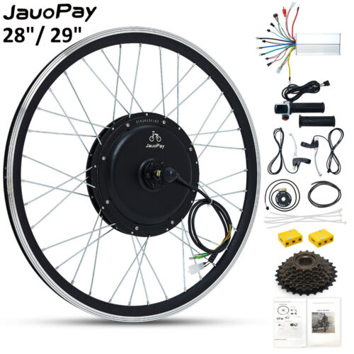

I am ordering a 1,500W hub motor kit for my Christmas present. I already have a 1,500 watt kit on my full suspension with the chain up front but this is a way better kit. I will not be adding a chain on the front with this new kit.
The first kit came with a wimpy 30 amp controller. Maybe 9 mosfets , not sure. It was advertised for 35 mph but only did 33.5 mph. The rpm of the motor was rated for 490 @ 48V. It was a 26" kit. With the front chain the first kit will be 2,500W total and suitable for off road with both wheels motorized.
The new kit will be on road only , preferably smooth roads. It will have narrower smoother tires for less resistance and hopefully the 37 mph it is rated for. Maybe even 40 mph with 56V of LIFEPO4.
It will never be bogged down with 50 pounds of LTO. The LIFEPO4 should only weigh about 25 pounds. It is for my Giant Roam so the build will be as clean looking as possible. It should look like a factory built e bike. All pedal gears and both brakes will be fine tuned to work flawlessly.
Check out the specs. on this 700c 1,500W kit. A 45 amp 12 mosfet controller , 37 mph and 560 rpm. @ 48V. If it is true then is a sweetheart of a deal.
Looks good. Everything you need, competitive price.

What was wimpy about it? Not actually 30 amp?
I guess it is not that it is wimpy. It is not really 1,500W @48V.
48V * 30 amps = 1,440 watts. It states that it is 30 amps and 1,500W on the controller and has a 35 amp inline fise.
The controller in the 700c 1,500W kit I am ordering next month is 45 amps continuous. so
48V * 45 amps = 2,160 watts. Therefore it is really a 2,000 watt hub kit.
2,000 - 1,440 = 560 watts. That is a big difference. I will be lucky to reach 35 mph even at 55V of LTO with the 30 amp controller that came with the 26" kit.
If I were selling them it would be advertised as a 1,200 watt kit and 33 mph. It did 33.5 mph when I tested it. A 26 amp controller would be advertised as 1,000W and 28 mph.
If the 700c kit is as advertised I might hit 40 mph with 56V of LIFEPO4. We shall soon see.
Also I now see Jauopay 2,000 watt kits advertised. My guess is it is really a 1,500 watt motor with the 45 amp controller.
A dead give away is the rpms for the 700C - 1,500W kit is 560 and is the same as the Jauopay 2,000 watt kit. Jauopay just does not have an amp rating for their controller. It just states it is 2,000 watts.
I used to think that the 1,000W motors were the same as the 1,500W motors but typically a 1,000W motor will be rated at 430 to 480 rpm where a 1,500W motor is 490 to 560 rpm. I think a true 1,500W kit should have a minimum of 35 amps and 500 rpm.
48V * 35 amps = 1,680W.

looks too good to be true. It is $100 cheaper than the 1,500W - 700c kit with the 45 amp controller.
That is something I just cant ignore. It could be a black Friday deal. Not sure.
It will probably not be available when I get my $$$ on the third.
If it is then might order it and use the $100 toward more 26650 cells from Battery Hookup.
I would like to hear some opinions on it.
Thanks.
Skyler.
Kind of scammy to sell it as a 2kw kit, then put in the description:
> Restricted to 750 W and 24 mph by default as a road-legal kit
Last time I bought a kit like that, the included components were garbage too. Like the brake levers were these cheap plastic $5 Wuxing ones:
Do they technically work? Yeah, I guess. Felt very unreliable, though, so I swapped them out after one day, myself.

yea. I messed up.
I should have realized that black Friday deals would happen on ebay. I did not have the $$$ to order a hub motor kit.
I sent a message to the seller of the Jayuopay 2,000 watt kit.
Looks like only 1 rear kit left. They have a front kit by another seller for $165 but not doing that. Those kits are > $300 full price so not ordering it unless there is a rear kit available Friday < $200 but seriously doubt it.
I am not at all happy about it. I guess I will order a 56T 9 hole spoke sprocket kit for the 20" Diamondback Cobra 20. I am reinforcing the rear rack with bed frame and flat steel for the 3,000 watt brushless motor.
