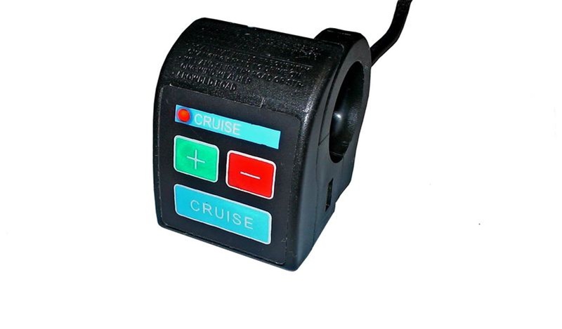

Certainly all in for DIY projects! But just checking if you'd seen a this product. Have seen good review.
As seen on this web site... just an example, many about.
http://electric-bikes.com/betterbikes/throttles.html
Regards,
T.C.
