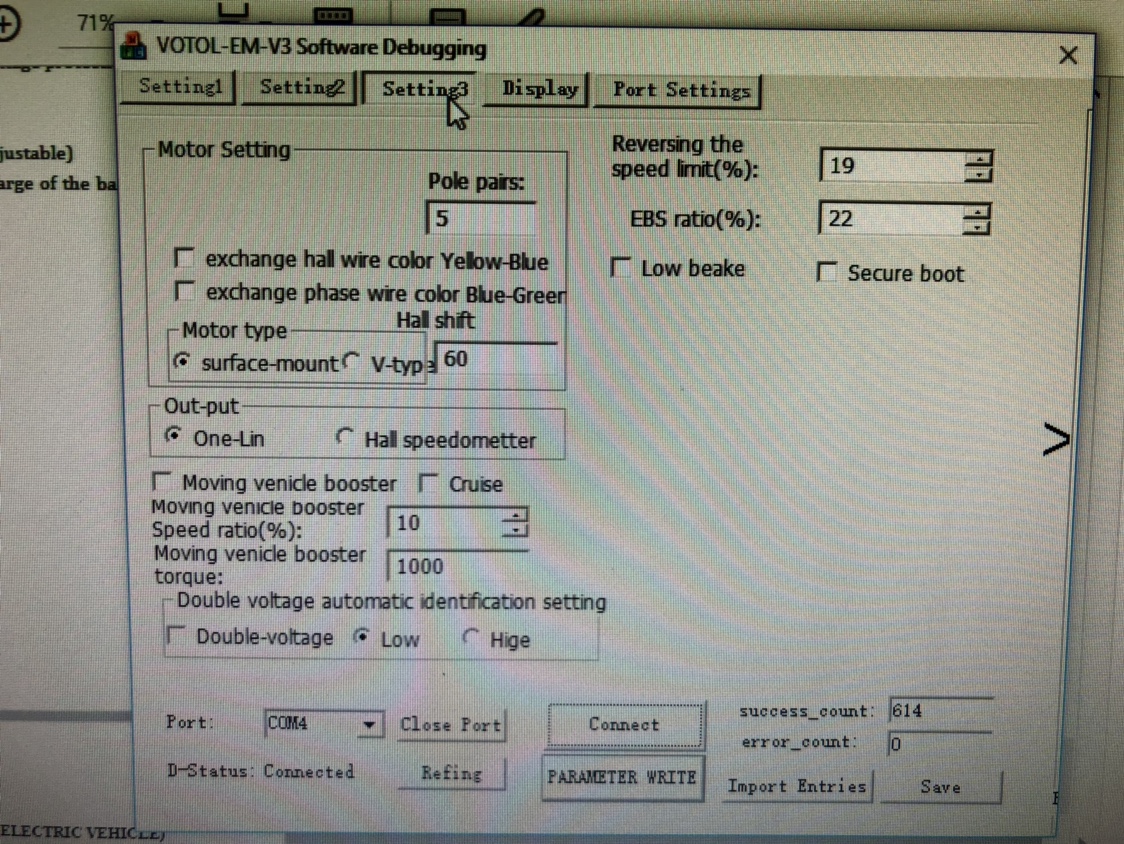

Hello guys, As mentioned before I have the QS 3000W motor with the Votol 150 controller and I’m trying to get the right settings.
It’s build in a little car with weight of 280kg without 2 passengers so max weight is 430kg including passengers and battery.
I’m going for a max speed of 47km/h.
Long range is important.
Acceleration speed is not important, similar to a 50cc 4 stroke standard scooter is good.
Battery is 72v 100ah, capable of 410A output.
Currently my range is 80km, during 150 minutes, had not hills in test. This seems low to me and could be improved, what do you think?

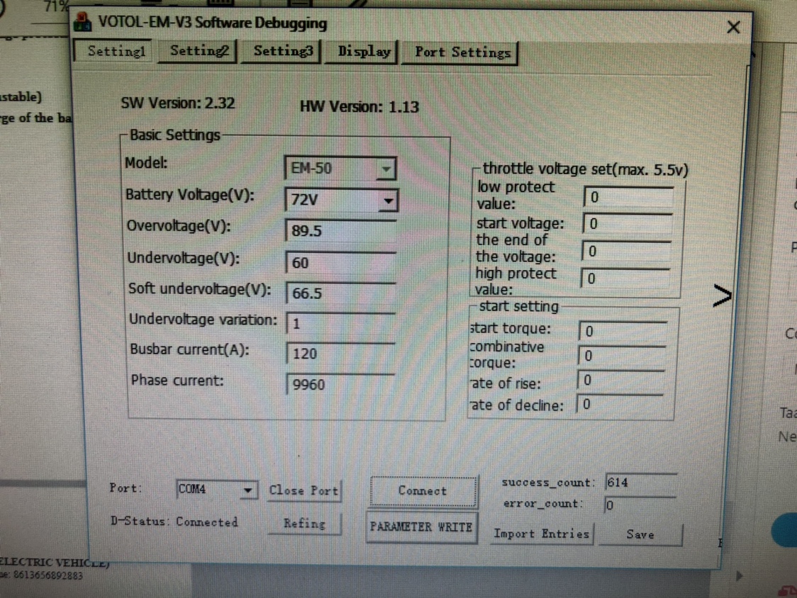

I’ve got access to the controller and have been fiddling around with the settings. Some I understand but not all, below pics of the settings.
Phase current on settings page 1 is on 5000 (what does this number mean?
On page 2, all three speed % is set on 67% ) gave me top speed of 47km). Why are there 2 columns?
I have no idea what flux weakening does.
I’m hoping for some help and advice, many thanks in advance!
Some answers are in the manual, did you check it?
I could go 60km on 72V35Ah with this combo on my moped. You have triple the weight and 4 times the contact surface on the tires. Hard to say what's reasonable in range. Does motor get varm?
The phase current setting is just a representative value, my controller was set at something like 9600 when i got it, i think this is max setting since controller returned to this when i tried to increase the setting.
Field weakening increases possible speed of the motor, often at the expense of torque and efficiency. There's an ongoing discussion if this motor is good for field weakening, since it is interior magnet motor it could be efficient and gain torque in field weakening if motor design is optimised for this. I don't think it is but cannot prove it.
The three value settings are set related to the voltage level, if you have low battery then controller will adapt the output according to these three settings.

About the phase current the manual says: (2) phase current limited value: if limit controller phase current out-put, it will limit the motor torque out-put. Setting Range (the biggest value full power out-put, don’t suggest adjust )
Doesn't say anything about what the unit used is.

The phase current setting is just a representative value, my controller was set at something like 9600 when i got it, i think this is max setting since controller returned to this when i tried to increase this setting.
Standard setting when first connected was 9960. I changed it to 5000 to limit the acceleration and speed up a hill. I think I'm going to lower this setting. During testing I noticed that below 1000 the motor wouldn't turn with wheel off the ground.

This I could have seen in the manual, it's there:
The range for flux weaken value on left/right side refers to in dual voltage mode, the speed is different
because of the different voltage. Left side option refers to low voltage, right side option refers to high voltage.
For single voltage controller, Please keep the left/right in same value.
But how to tell if I have a single voltage controller? I think this won't give me a better range, so not that important.
