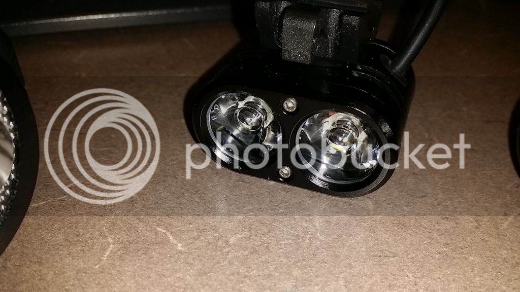

Finally got my 3 LED bike lights as shown in the picture. Two cheap ones $7 and a slightly more expensive $25 dollar one. Went up to $32 today, but probably will go back down.
The dual LED yinding 900 simply blows the other two away in every way.
It is much lighter and smaller than the other two. Much brighter. The dispersion is great, it isn't like a spot light like the two others. This one has a neutral white option and it looks really good. Neutral White is supposedly a better and safer light to use.
This particular light was recommended in the mountain bike forum as the best bang for your buck light. It was actually produced again at the factory in china to a high spec and only offered on gearbest.com.
It looks to have decent optics in the light to help disperse the light pattern.
Highly recommend this one in neutral white, only offered at gearbest.com. Weighs only 60 gram.
http://www.gearbest.com/headlights/pp_133573.html
Can even get the gopro adapter for it.
http://www.gearbest.com/led-accessories/pp_240917.html#customer_review
Here is a good write up about bringing it back on the market.
http://budgetlightforum.com/node/36929
There is also a BT40S light that is also recommended. May be a bit brighter, but it is a bit larger. Something to consider. I'm looking into this light right now. These two lights are probably the best china made lights out there right now. By far worth the extra cost over those cheap $7 dollar ones.
