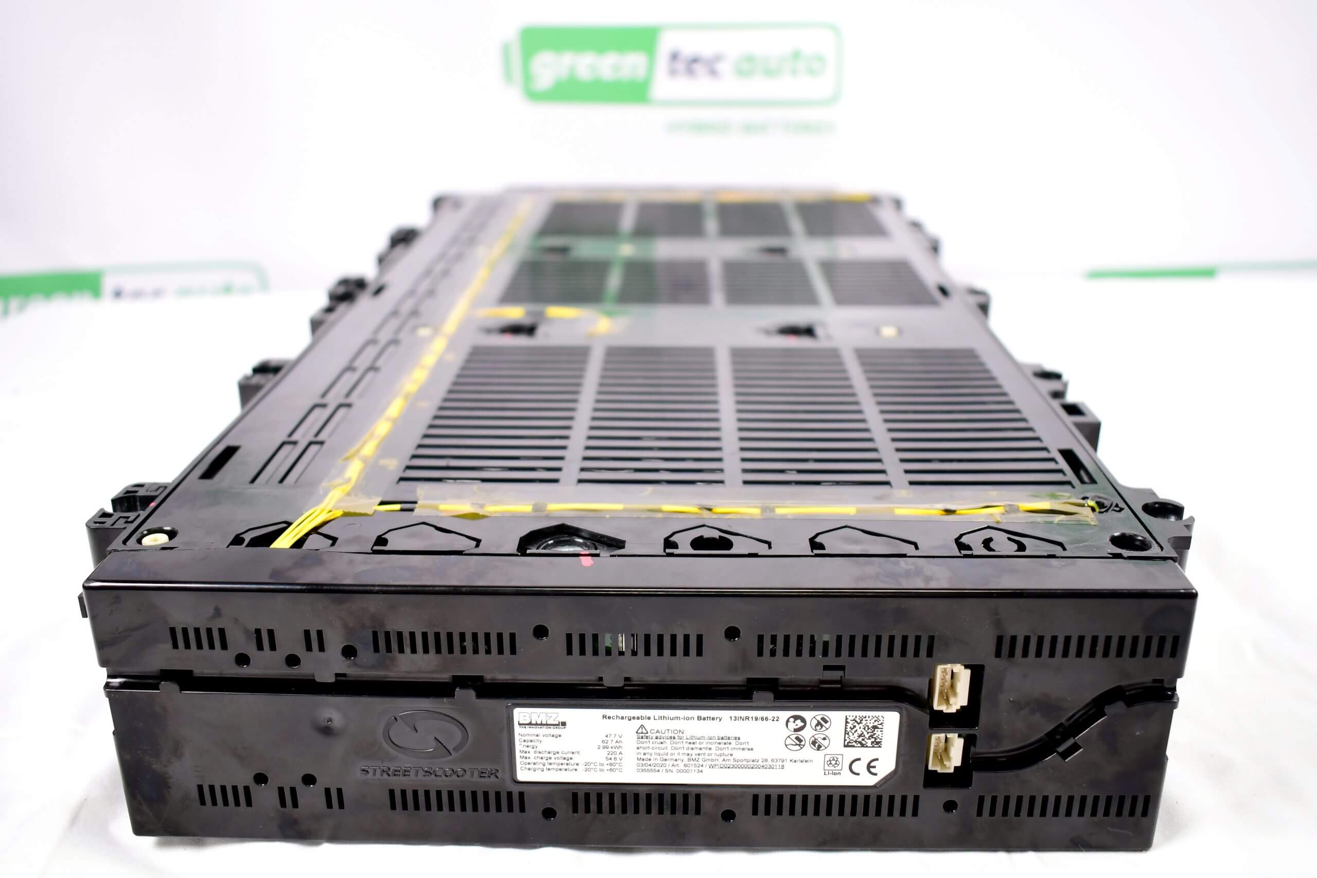

Or buy a recovered ex-EV battery module, and keep the cells in groups as much as possible for the shape you need them to fit in, and just add new interconnects to the existing ones. Like these, among many other examples:
