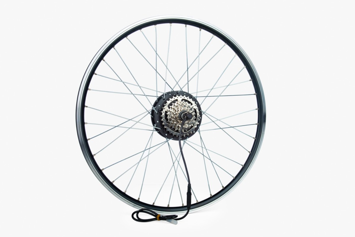

I'm looking to convert one of my old mountain bikes to an e-bike. Typically 68mm bb, 135mm dropouts. I would like to do a smaller diameter rear hub motor and ideally still get a little oomph off the line. This would be a fun bike for zipping around. I (200lb, 6ft) currently have a knee injury so need to be able to get going without much pedaling. I do plan on recovering and would like to be able to do 30-32mph with pedaling hard. I can play with gearing to get a gear that I can pedal that high. I wanted regen braking as I enjoy it in my vehicle but I've let that go given my budget.
For power/price I was targeting 1500W at 52V, though I'm seeing this may not be the best metric to meet my goals. In early searches (I started this last year) seems to me I could get a cheap kit for low $200 (AliX, etc) and then batteries start at around $200, so $400 total. However, I'm reading these direct drive hubmotors will not provide much torque off the line and generally people are recommending to get higher quality components.
I came across this kit from calibike and appreciated the compactness of the rear hub but upon further inspection it seems it may not actually be a 1500W setup. It doesn't say that anywhere but it just seems like all motors that size offered elsewhere are lower wattage. And if I'm getting a lower wattage setup, I could probably pay less.
Is this a good kit or will I be disappointed? This is more than I initially wanted to spend but if it was really a compact motor that put out 1500W and got up to 37 MPH I could potentially push the budget. Even if that were true, I'd imagine the acceleration would be poor given what I'm reading.
Say I am willing to spend about $375 on the kit. What are some great options available now or maybe soon if out of stock given my goals?
Also not opposed to buying a used kit so save $ if available. It's likely this be ridden hard and infrequently, and not needed for commuter reliability
Thanks for your consideration
That's a geared hub motor wheel you linked, and that's why it's a smaller diameter. I recently put a 500w geared hub motor on a bike, it gets fed up to a 1000w. Built it for a guy with COPD, so not much pedaling. It will go 28mph on the flat, and climbs well. Heat build up on long climbs can be a problem with geared hub motors. Where I ride there are short steep climbs, and I have not had a problem. It would best to have a motor (& controller) temp. sensor.

@gromike I'm not opposed to geared motor, but would like to know what I'm getting motorwise and the one I was looking at doesn't seem to give all the info (i.e. peak power vs sustained). Use will be mostly flat with some hilly sections (typically no more than 1/2 mile) followed by downhill and flats

The kit you linked should work well for you, as I get that performance from 500w rated motors. The controller, of course, gives more power than the motor's nominal rating. You would need a battery rated at 30+ amps.
The geared hub bike I built cost a total of about $350. That was with a battery and a motor from a scrapped Adventon Pace 500,
me lacing the motor wheel (rim and spokes about $100), a new controller and display ($100), and tires and tubes ($150). The bicycle was harvested from a pile of free bike parts. I did splurge on good tires.

@gromike thats excellent you were able to salvage parts like that and build a legit bike. I guess my question with this kit I linked is it just 500w AliX parts with hyped up description that I should buy for less and try out or is it a unique worthy offering?

PS. there's nothing wrong with the kit you posted a link to. looks like it uses a KT controller too. it's a geared hub, so will make more noise than direct drive. But for the same money, you could probably do better.
