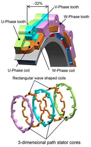

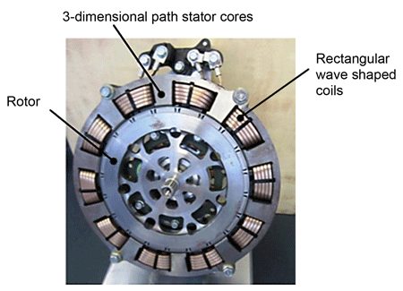

Kinda like Hondas winding in this early tranverse flux prototype that failed due to soft-magnetic-core material limitations. If the core of that same transverse flux honda motor were made from an amorphous glass-metal magnetic material it would be a game-changing motor topology with respect to efficiency, native torque density, and power density. If you want to know why this winding rocks, recognize that the copper in the slot is what's the critical performance metric, and all the copper outside the slot (end-turns, end-turn-losses) is just added resistance and heat to your motor that isn't making torque for you.
The objective in a winding is to complete the magnetic circuit with as great of percentage of the copper in the slot itself, with as little as possible outside the slot.
That's why this is such a sexy winding, and how to do it right:
Even more-so than the beautiful bus-bar origami from that accord hybrid 4t bus bar winding, or this new Toyota winding.

Beautiful sexy origami end turns, but still end turns.
Absurdly high fill factor, but still a decent chunk of end-turns.
That is like a 30% lower copper loss winding that amazingly achieves the same copper slot fill %
We need Miles/Biff/Farfle etc to make some pattern segment that can be wound by stitching through some strip of coated copper bar-stock.
It seems relatively DIY friendly to make a jig that smashes the barstock into some special bend.
