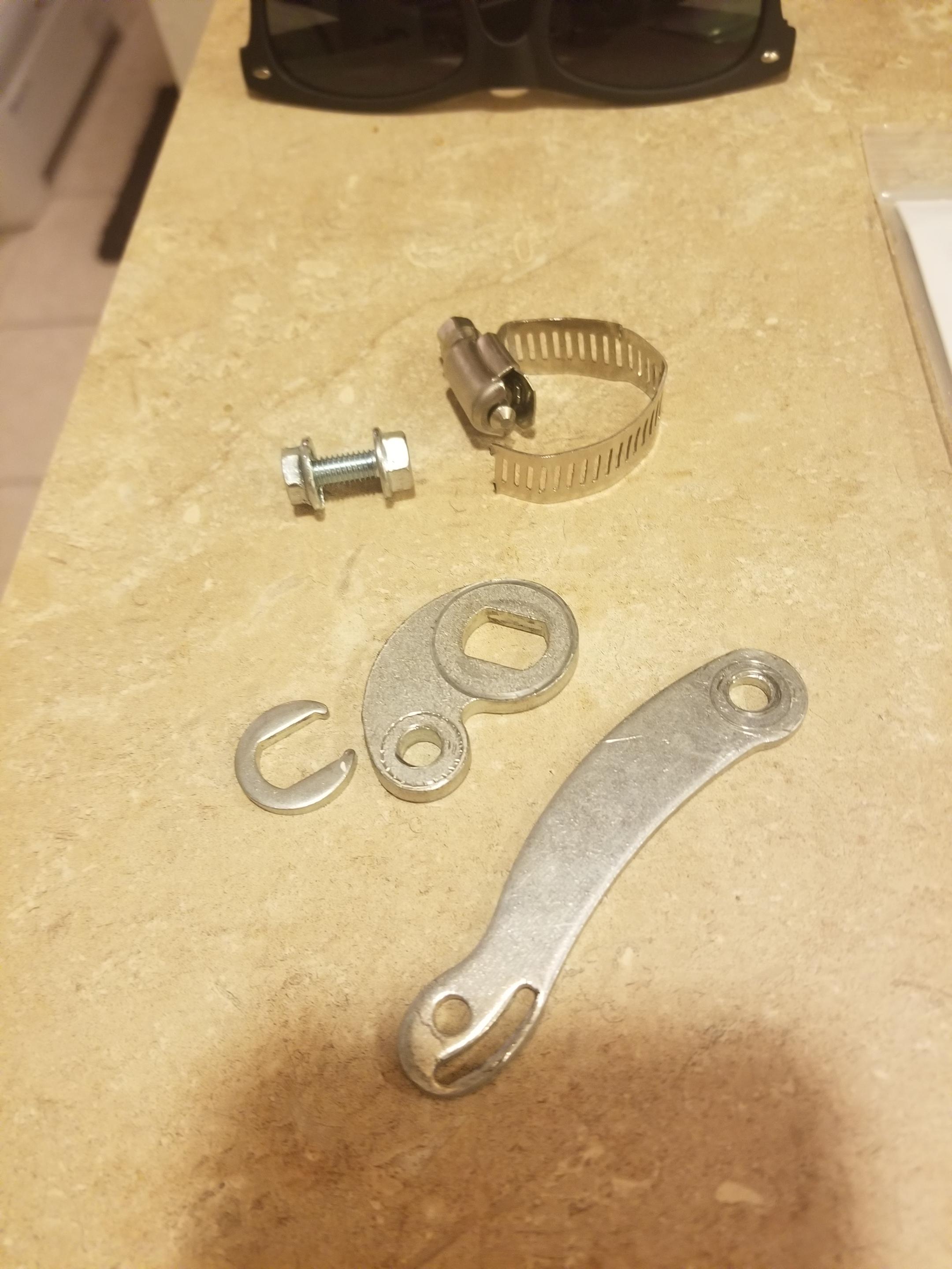

Don't care much for the looks of torque arms and garden hose clamps that I see around. Grin and such.
I"m thinking about titanium. Costly to produce and what volume would be needed - thinking about 10k and $80 would yield a proper margin.

I think the answer for most will be no when a Grin V7 is cheaper and better. The problem with torque arms and why they always look ugly is you have to make them to fit a very wide range of conditions. For instance that style probably won't fit as many bikes since you can't rotate the angle. And the fact that it's not clamping which one of the only ways you can really make a torque arm better. If someone really cares about looks the solution is often to just make a torque arm that fits the frame/fork perfectly. Also combined with the fact that the vast majority of hub motor builds are cheap builds, that is to say the Grin stuff is already way to pricey for the majority of the market. It's not a market that values premium products, it's a value market.
Ditto what @scianiac said. Take a look at the Torque Arm Picture Thread.
Here is my torque arm posted there. These rear dropouts posed a pretty difficult problem for many conventional torque arms. So I custom made my own.

I would buy a grin torquearm on the basis that it has dropout clamping. This has a greater effect of transferring torque than choosing a harder/better metal. This is because axle width in hubmotors are highly variable.
Grin is some decades into solving this particular problem & i know they have an excellent product. I'd be hesitant to try anyone else's unless it had clamping and angle adjustment also.
I think from a business standpoint you would have a hard time competing with them.
I suggest you put your efforts into doing something nobody else is doing well. That's where the good opportunities exist.

Judging by the majority of TA questions we get from posters requesting help with TAs or reporting problems, they are almost all using the cheap ubiquitous knockoff of Grin's long discontinued TA v1:
which is unsatisfactory on so many levels, but is ubiquitous, cheap, and seems to be almost universally offered in kits. Evidently most buyers don't know its pitfalls, at least until it fails.
So that is where the market is. Would need to make your TA cheap, efficient, easy to use, and (most importantly?) well-marketed.

I'll point out that like almost all uses of titanium in place of steel, this is an inferior material for the job. It's only 60% as stiff as steel, which matters in this application. And it's only as strong as fair-to-middling steel, so maybe less failure-prone than cheapo Chinese cheese-grade torque arms, but less effective than Grin's stainless steel TAs-- let alone some custom item made from 17-4 stainless, AR500 steel, or heat treated CrMo steel.

If they're installed on both sides, rolled all the way forward before tightening down, and not used with regen braking, those are almost always enough.
The problems with them are either from reversing torque (regen), not sufficiently tightening the axle nuts, or anchoring them in a way that allows movement at the anchored end.

I don't see that titanium is a good choice for the part that contacts the axle flats - that is about resistance to deformation and ingress:
Tensile yield strength: 350 megapascals for steel; 140 megapascals for titanium.
Stiffness: 200 gigapascals for steel; 116 gigapascals for titanium.
Fracture strain: 15 percent for steel; 54 percent for titanium.
Hardness on the Brinell scale: 121 for steel; 70 for titanium.

I've also received the cheap grin knockoffs in one bike kit. As Chalo says, the small piece that fits around the axle does better if it can be screwed to the frame.
No, I wouldn't pay $80 for a torque arm because I don't do monster motors. Aside from the front drives, they're probably overkill on a rear drive 500w project,
