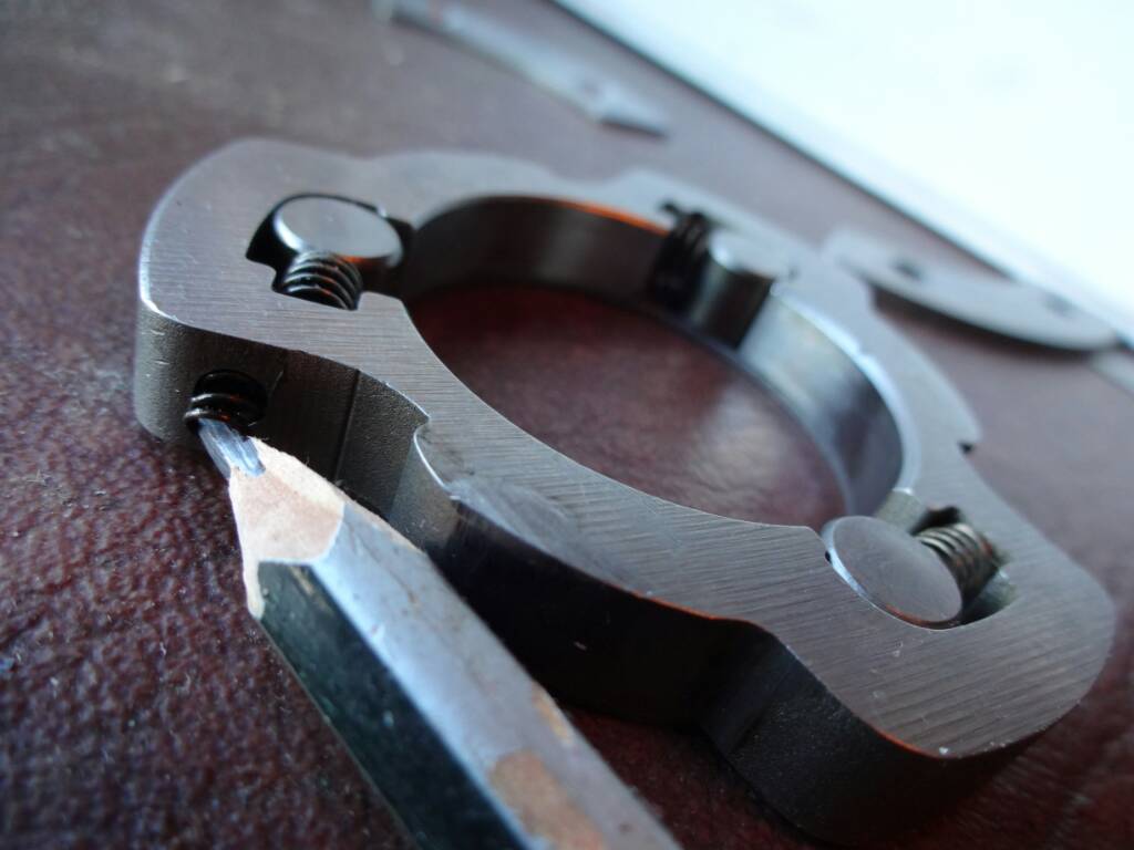

The very first Xiongda 2-speed motors had very hard waxy grease in them, that made them noisy. Since then, they changed it to something more normal. I don't think the grease has anything to do with gears breaking. It's still possible (though a lot less likely) to get the same failure on a normal bicycle as on the recumbents by pushing it backwards - worse if you're sitting on it.
I bought mine just after the grease had been changed.So did not open it from new.When it broke and I opened it up it had the hard grease in it. It was rattling the most I had heard it rattle the day it broke.Mine is in a 2 wheeler,just can't help rolling back sometimes.it broke at around 1400 miles new gears now on 500 miles.Stretching this spring has made the rattle much less.
There was only one spring this drawing shows 3.
Yona at xiongda said one was OK.I always try to not to roll the bike backwards.Mine striped pulling off from rest,I changed gear and it striped the 2nd gear.Still think its great.
