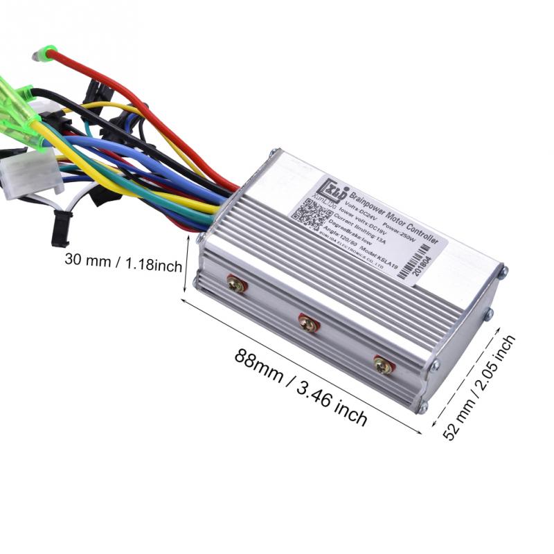

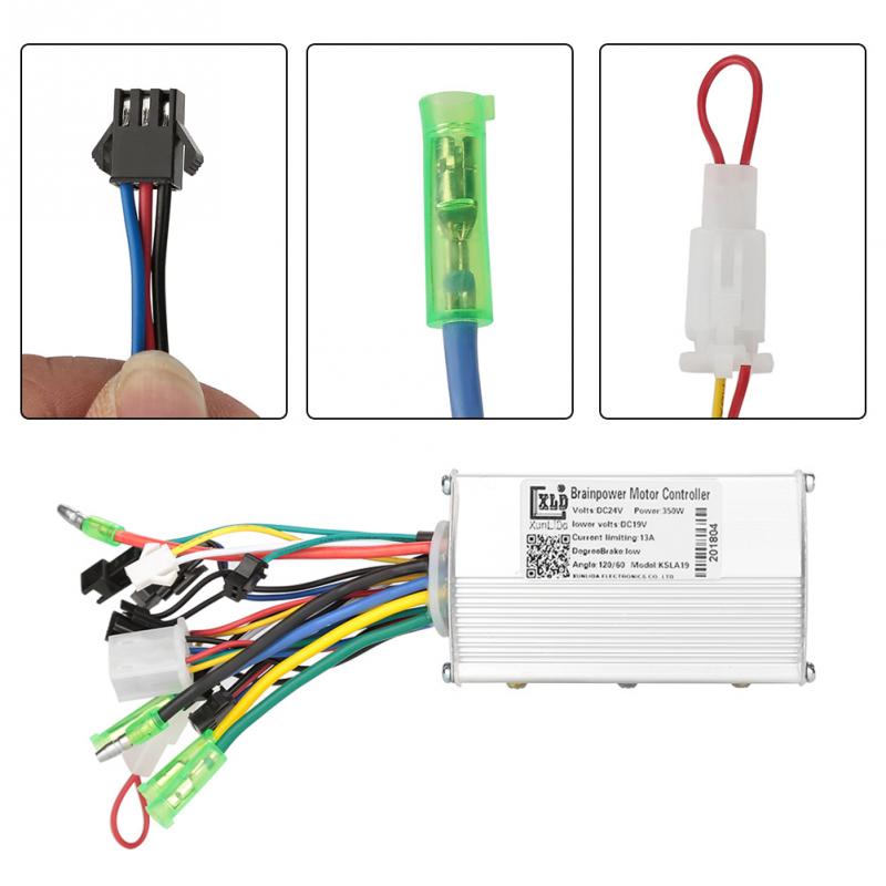

Hello.
I would like to ask about Current limit: 13A at this controller.
The thing is this limit is seen on both 250w and 350w versions (tried to hide images under the spoiler but it didnt work):
file.php
(from this topic)
So having different voltage and power all have 13A current.
I've checked other manufacturers and they have the next specs:
24v/250w = 13A
24v/350w = 15A
24v-36v/350w = 16A-18A
36v-48v/350w = 16A-18A
I want to buy the one from the last image and wondering how could it be 13A?
I know P = UxI = 24x13 = 312 so its more like 300w? Plus, like I shown 250w version also has the same 13A limit.
So maybe this limit is set to meet some regulation and could actually be unlocked?
What do you think?
Could also simply be marketing. Make the same product and stick labels on it for 250w for sale in areas where that's the max limit, stick a 350w label on one that goes to a different area. Etc.
Happens all the time with various kinds of products, including ebike motors and controllers.
That's what I also thought. But which figure is real 350w or 13A?
One case is that it is the same 250w product and they sell it as 350w. But another is that they show lesser current to meet some regulations and the full current can be unlocked.
Someone here owns a 350w / 13A version. So I hoped they would tell if it's real 350 or 250w in fact.
