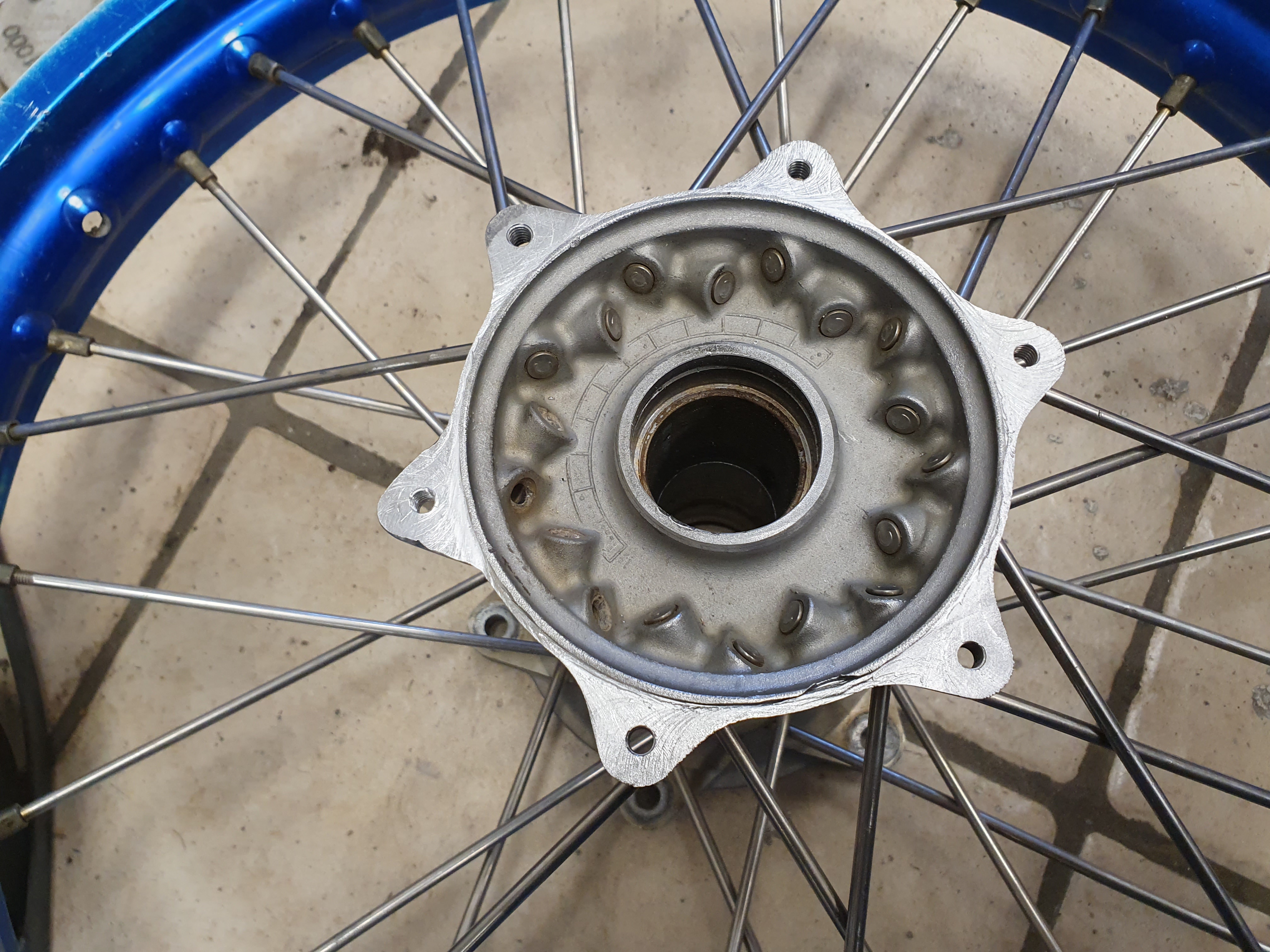

I noticed a problem last week after I was out riding:

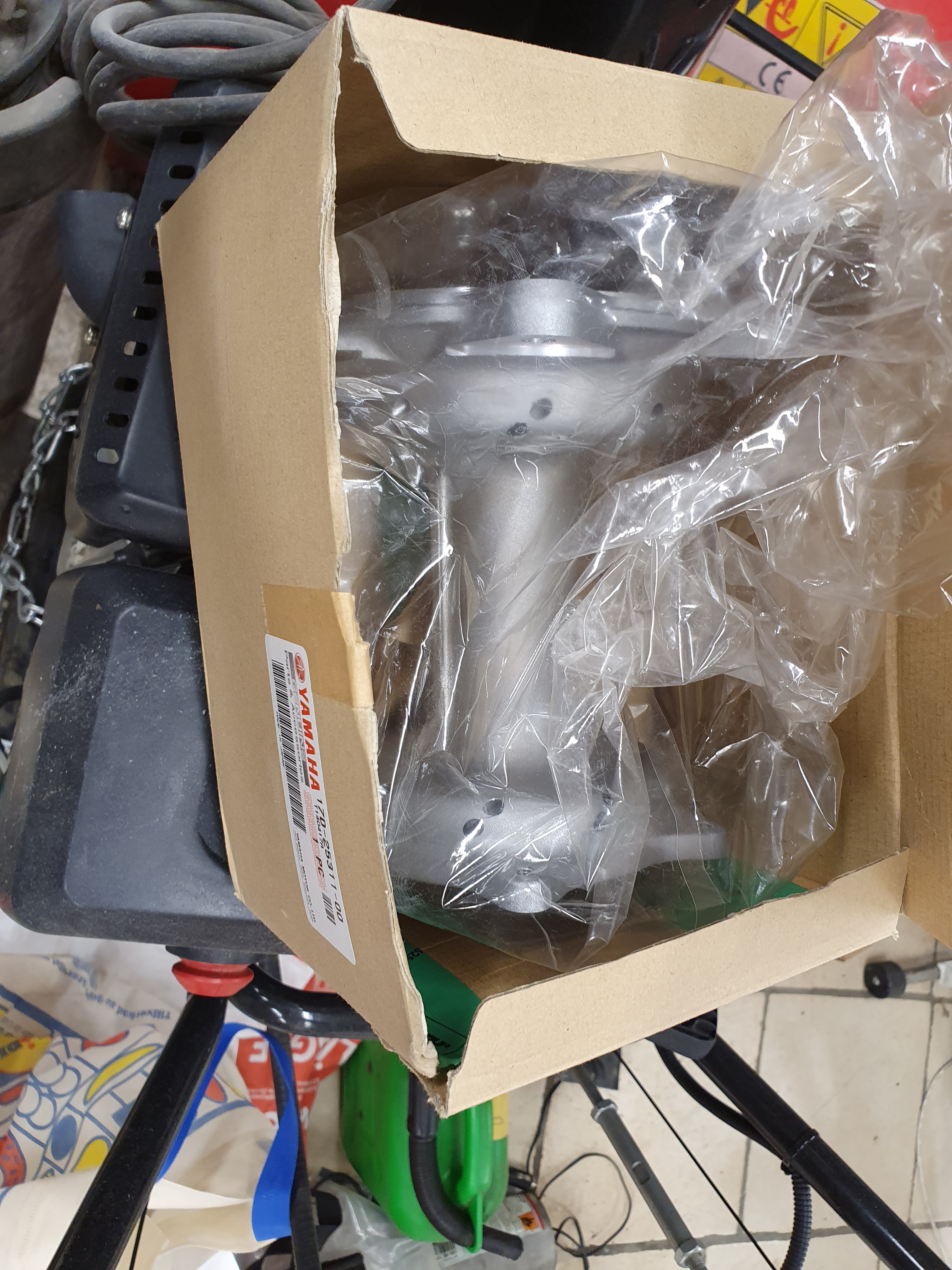

I thought that cant be good, and remembered I had seen a new hub on an ad some time ago.
Found the ad and bought it:
But I also tested how it was to weld, and it welded up just fine:
The wheel was to big for my lathe, so I left it with a friend.
It tured out it was to big for his lathe too, so he milled it instead:
I did hope for a little better finish, but at least I didnt pay for it ;)

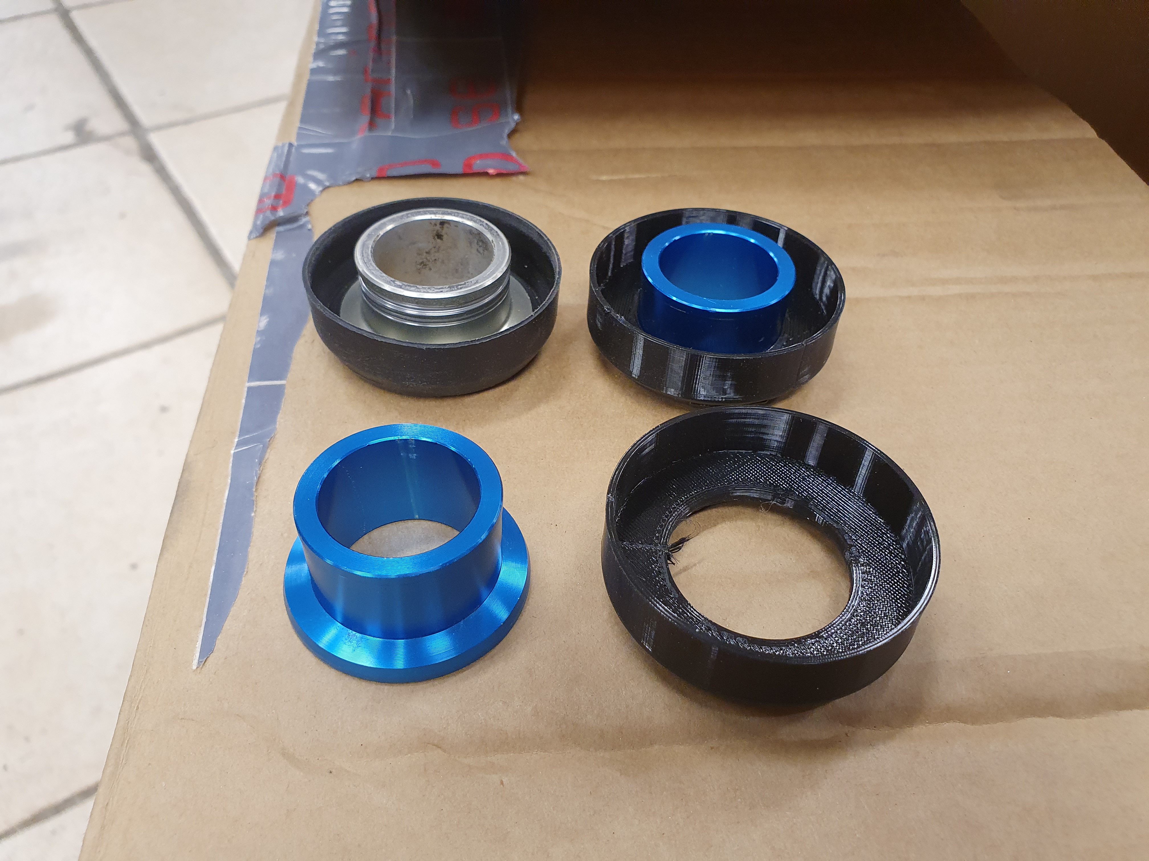

It was also time for new bearings, they had never been changed before.
I think they lasted this long mostly because of the covers on the wheel spacers, but it seems hard to find new ones with those covers.
So I made my own:
I first made one of ABS, but it broke when I tried to press it on.
These are of TPU, printed without problems :)

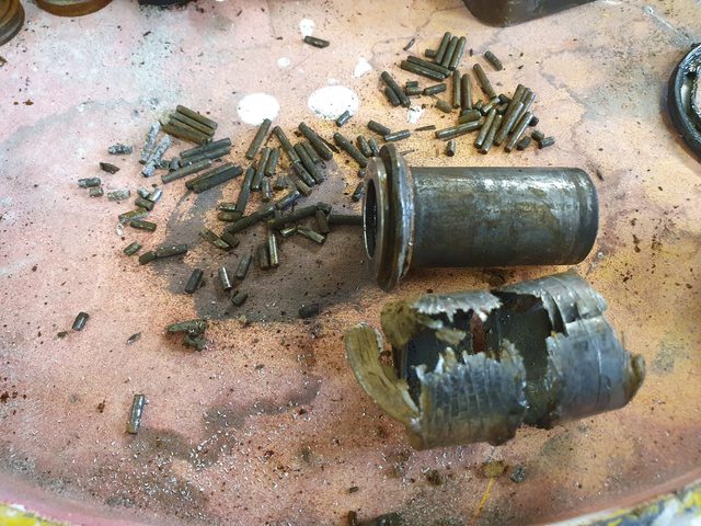

I was riding again today, and noticed the bike got noisy.
Back in the pit I found this:
I decided it was time to change there and then, luckily I had a used one in better condition 😬

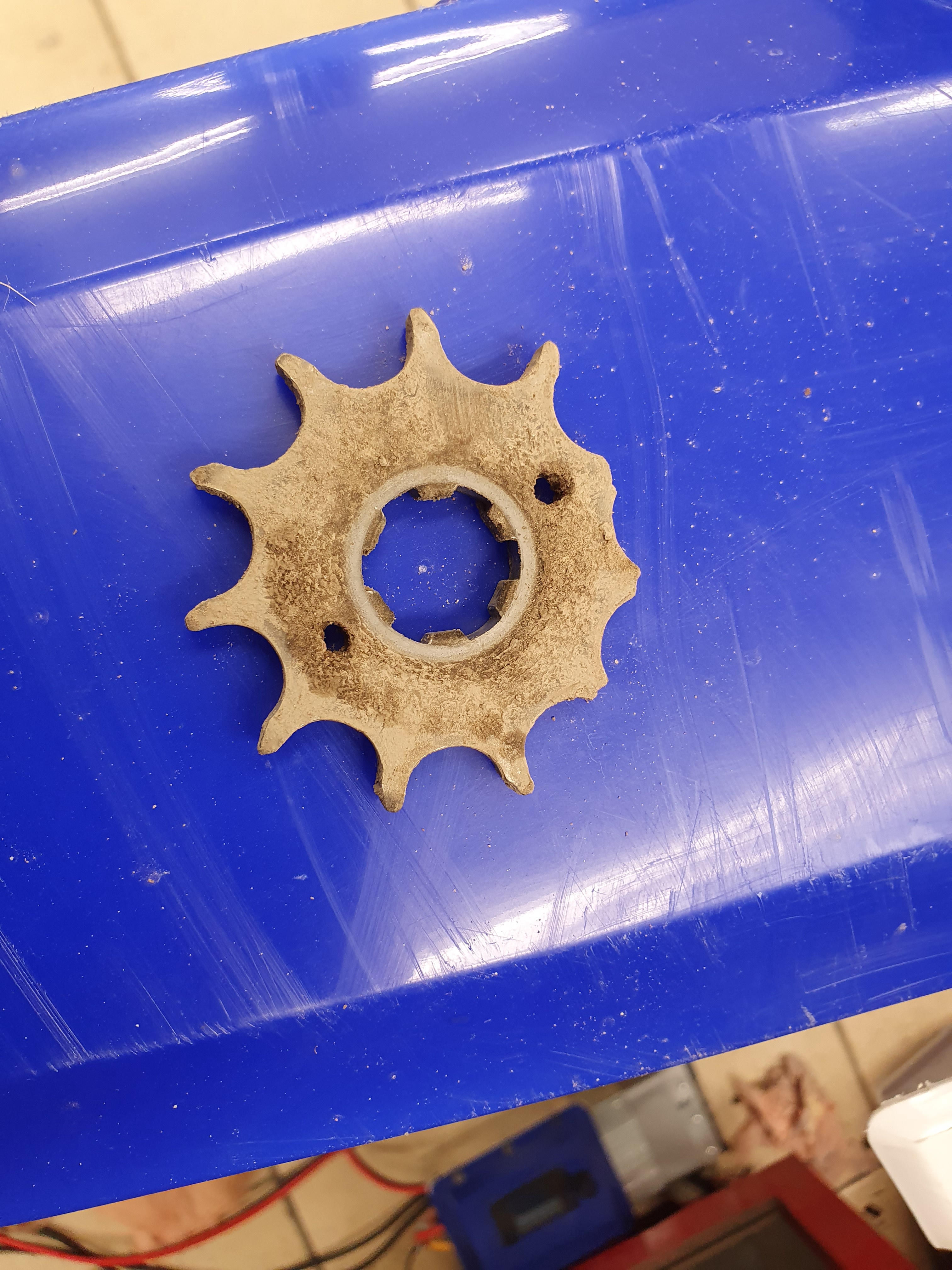

I was about to change chain and sprockets, but I am out of new front sprockets..
I have ordered some, but still waiting for them.
After todays ride I noticed that the chain is pretty much done as well:

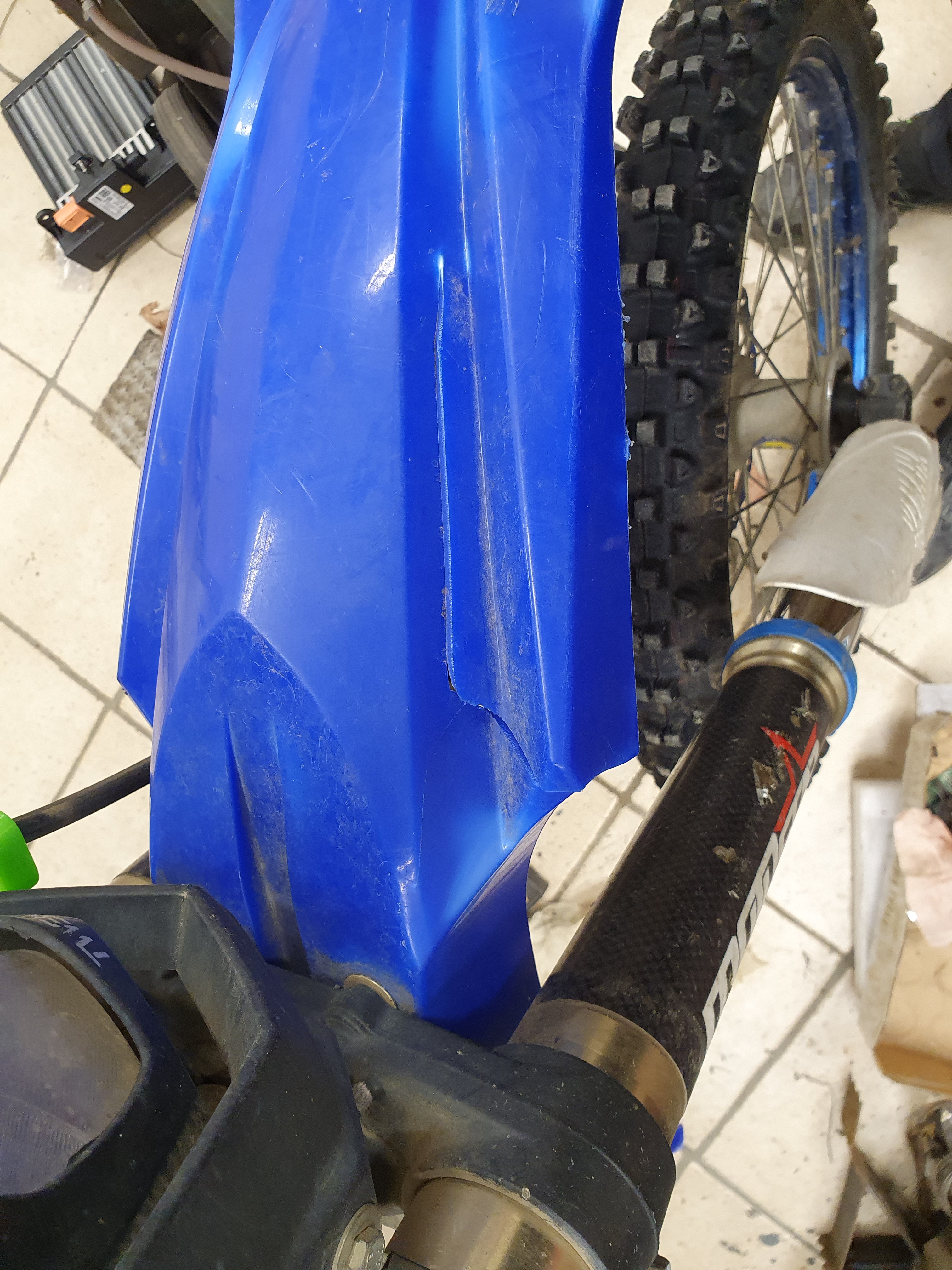

Yesterday when I was riding I broke the front fender instead:
That's unusual, I have only broke one before when I rammed some trees..

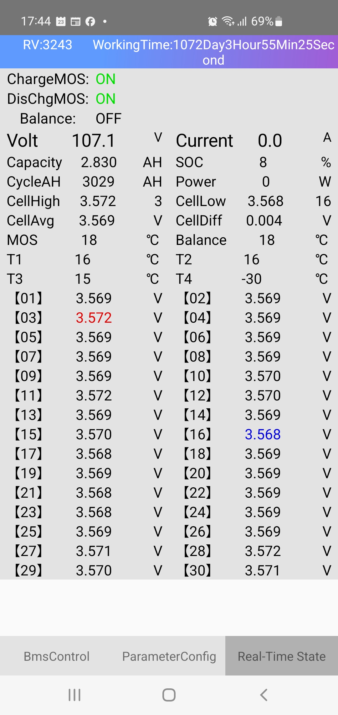

At first I thought it must be a motor position problem or similar, but then I remembered I saw some voltage difference at first when I stopped. I think it was cell 9 reading low. They all look ok now though:
Some difference but not too bad. I'm thinking it could be a balance wire that is starting to brake off where it is squeezed at the cable lug. I think this battery has done about 100hours, so it is not impossible.
If the bms sees a big voltage difference and cuts there could defiantly be some problem when the bike starts up I think.
I guess I just have to test the battery again and see if the problem comes back

I had an issue like that last week with ANT BMS: loose wire that the computer interpreted as one cell being 2v and the next being 5v, and shut down.

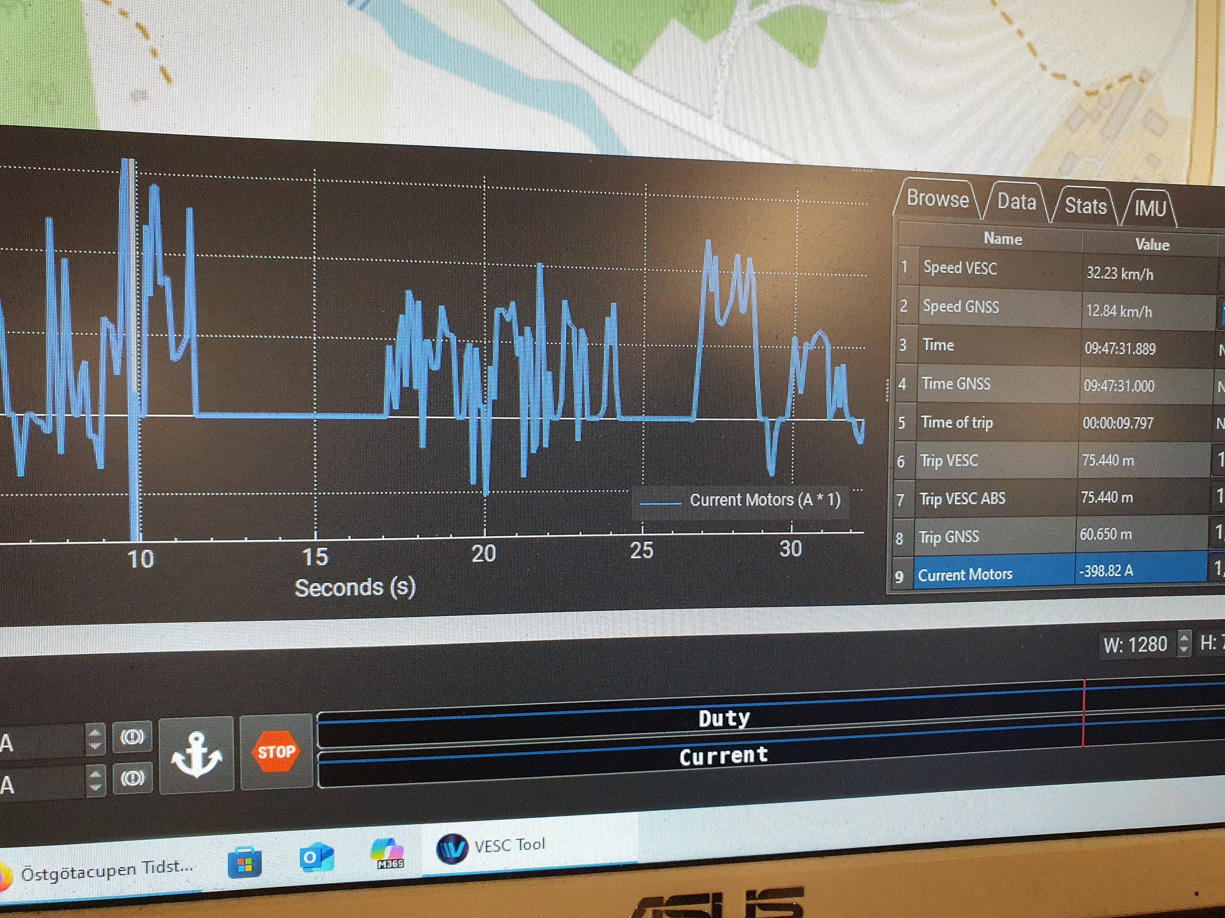

I was racing today, first heat went fine.
Then at heat 2 it started running rough and cutting out. If I stopped and released the throttle it was fine again.
It continued like that several times. I thought it might be the reverse switch, like if it got connection, then not, connection again etc.
Then after lap one the problem went away.

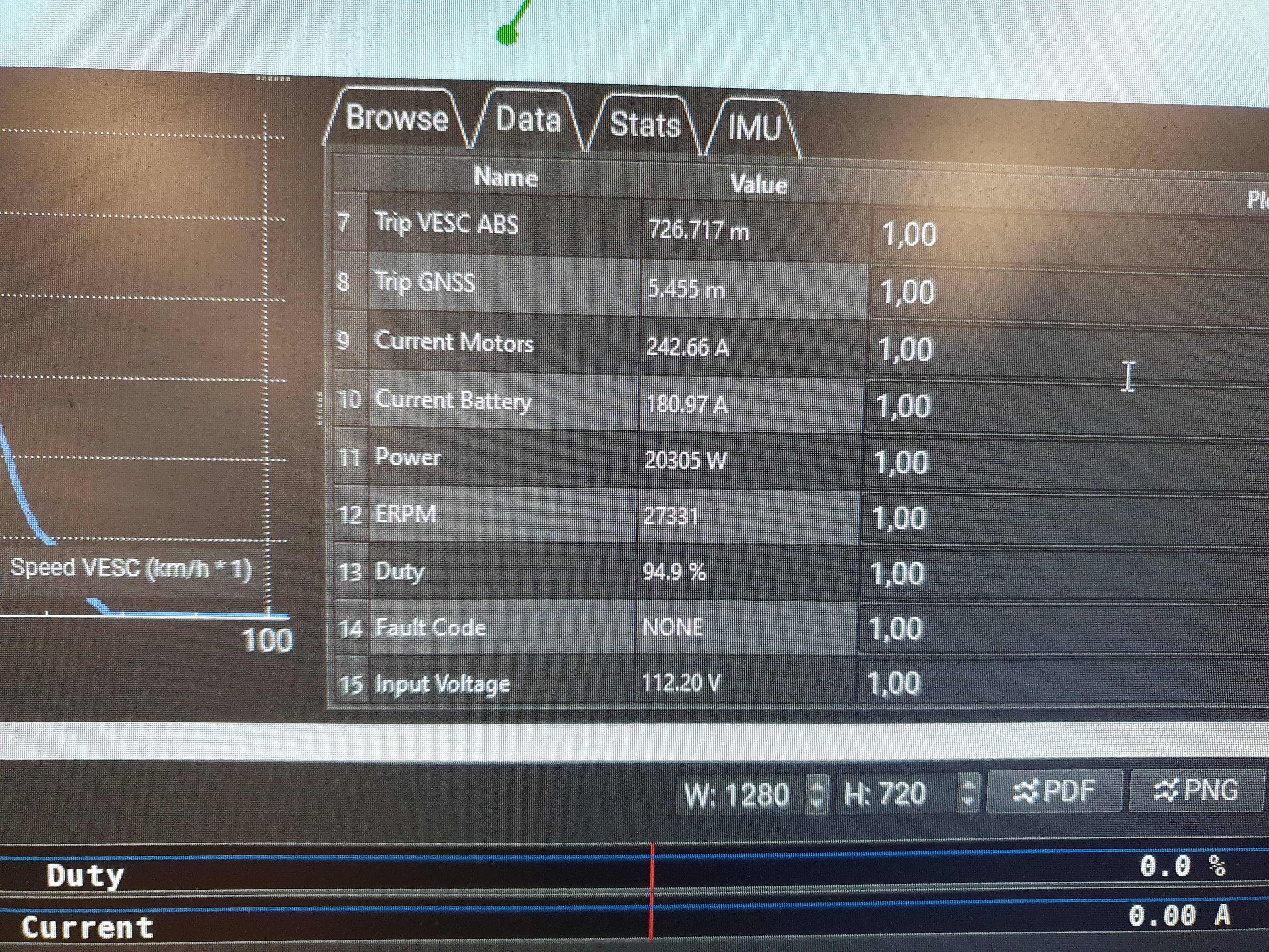

Luckily I was logging, but as usual it doesn't seem to show much:
I think I caught 2 cutouts here (the flatlines), it shows 0 fault as usual. But I think it is interesting that I get -400pA soon before the cutout. I could have been braking, but the brake is set to max 200pA..
A bit of an update on this issue, I also posted it on 3shuls facebook page, and Hackey asked me for the log.
I hoped he would be able to see something, but he only replied that there was no fault code (I knew that).

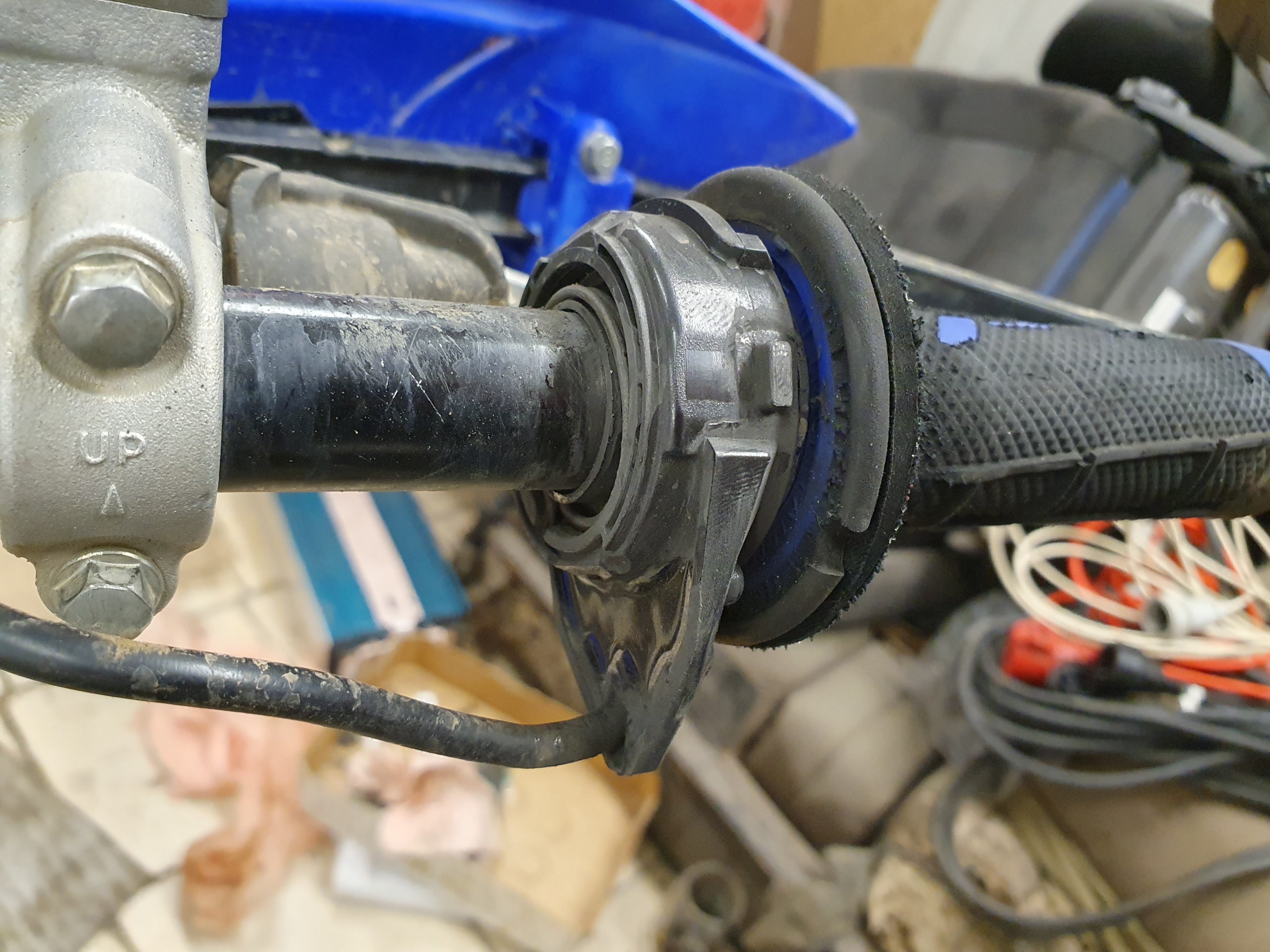

Anyway, he seemed to think it might be an throttle issue. I opened up both gas and brake throttle to have a look:
Both were potted, so I couldn't really see much.
I changed both, and disconnected the reverse.
I also took off the cover over the hall sensor in the motor to check that there was no moisture, and it wasn't.
Today I was racing again, and had 2 cutouts.
No rough running, just clean cuts that I had to release the throttle and stop the bike for it to take throttle again.
(not turn off or anything)
It seemed to me as a overcurrent cut, but I shouldn't be close as I run 1200pA with 1400pA max with 100% setting.
But I ran a 75% profile, so only 900Pa. Or at least, that is what I thought..

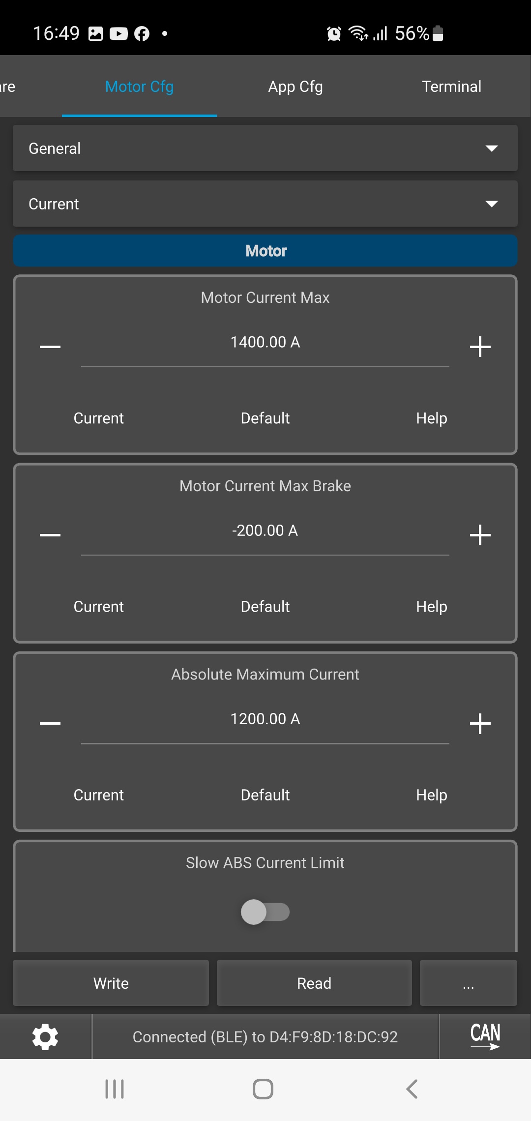

I was making a new post at 3shul, and took some screenshots when I saw this:
Find 2 faults in this picture ;)
It is the other way around, 1200pA protect, and 1400pA max..
I suppose it has worked mostly as I have ran the 75% profile (1400x0,75=1050pA, so should work I suppose)
I wonder how it has happened though, I dont think I have touched it for a long time.
Can it have changed itself?

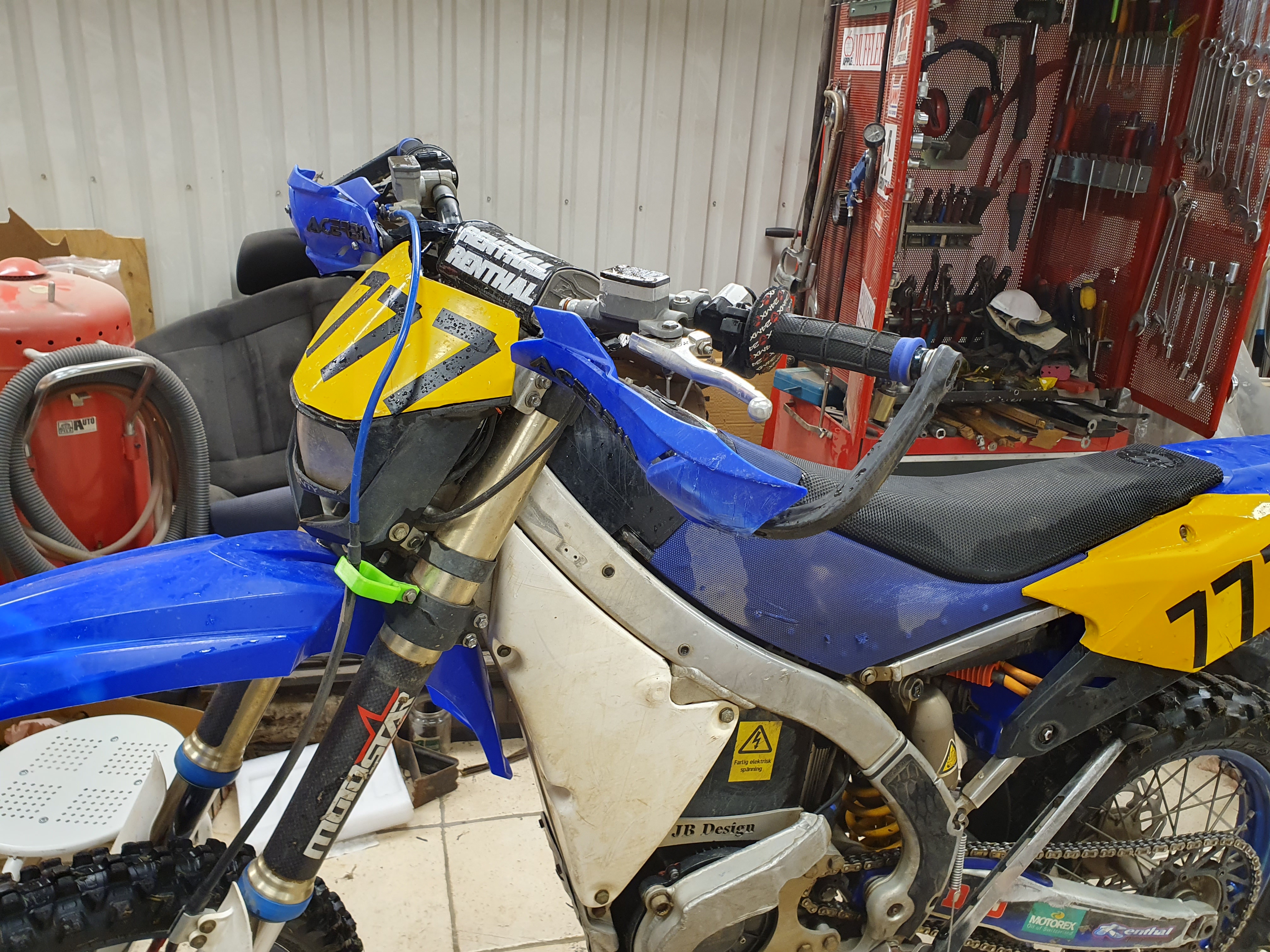

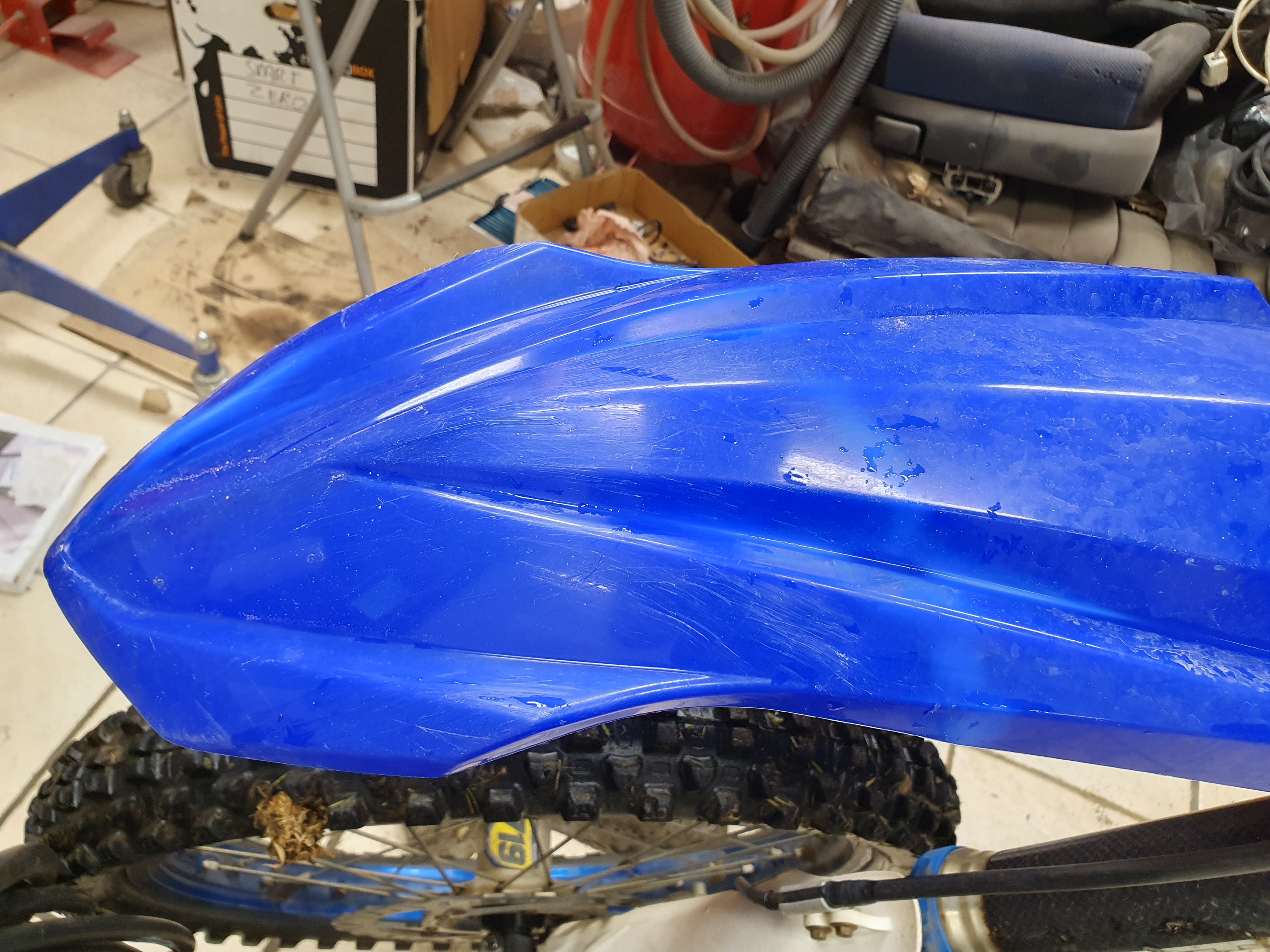

I had a scary crash today at the race, on a fast sand uphill with loose rocks (cat sculls) I got one of those front wheel hits that just sends you in another direction. I then hit an old stump after a tree, and got a root in the front wheel somehow :oop:
I went flying, and more or less landed on my head, in the sand luckily and not on a rock😬
Both the bike and me was surprisingly unharmed, I think the front fender got hit pretty hard judging by the "white stripes" in the blue:
It doesn't show very well, but there is a line from left to right, and some front to back.
Have some straiting out to do on the handguards too.

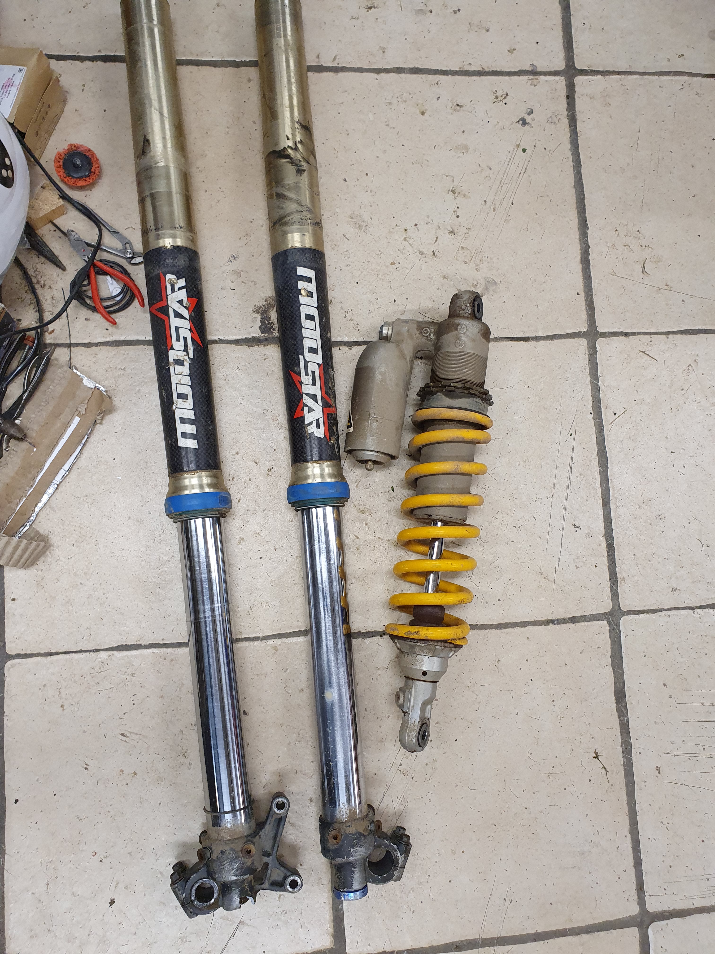

It sure is time for some suspension work:

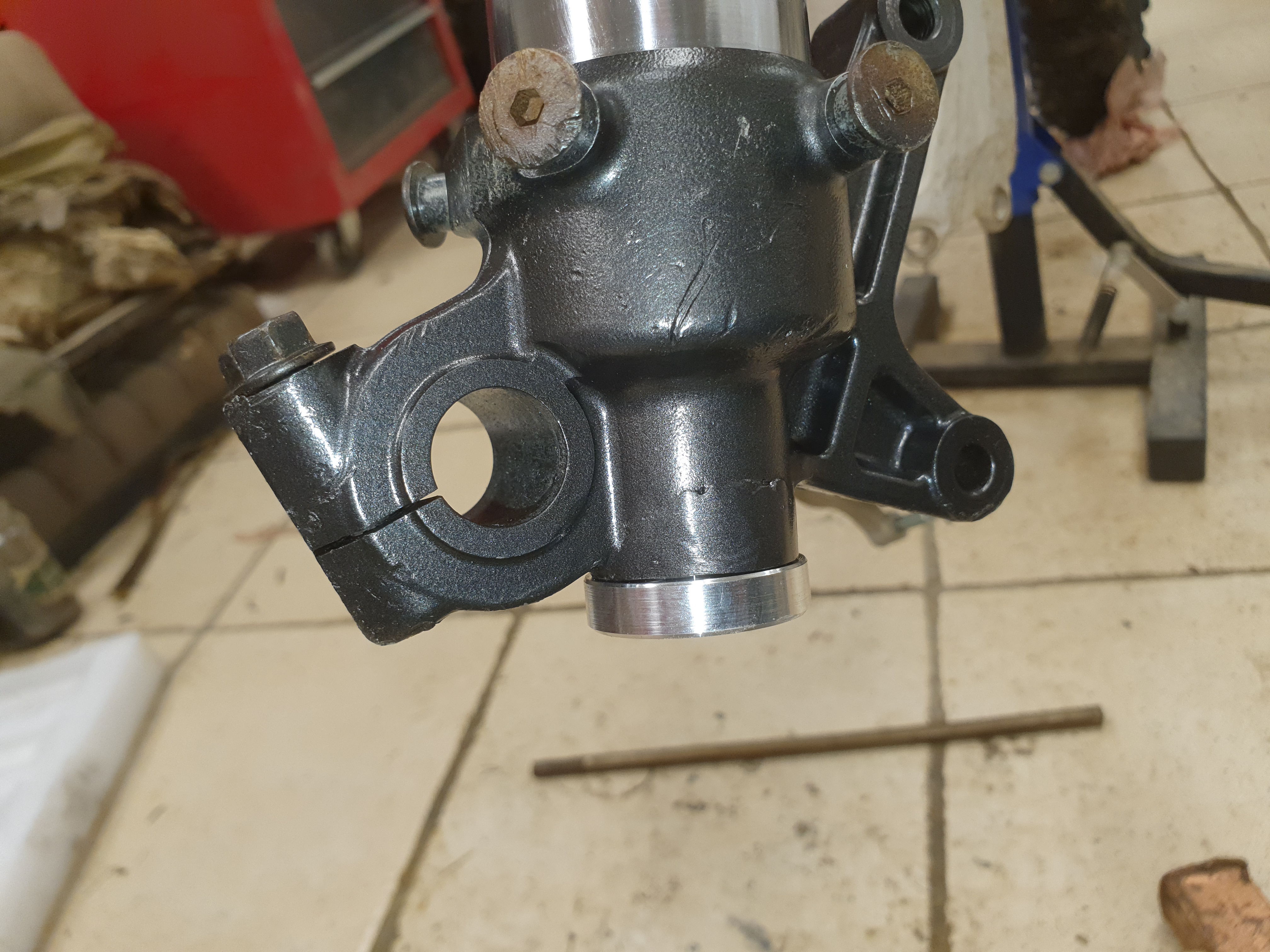

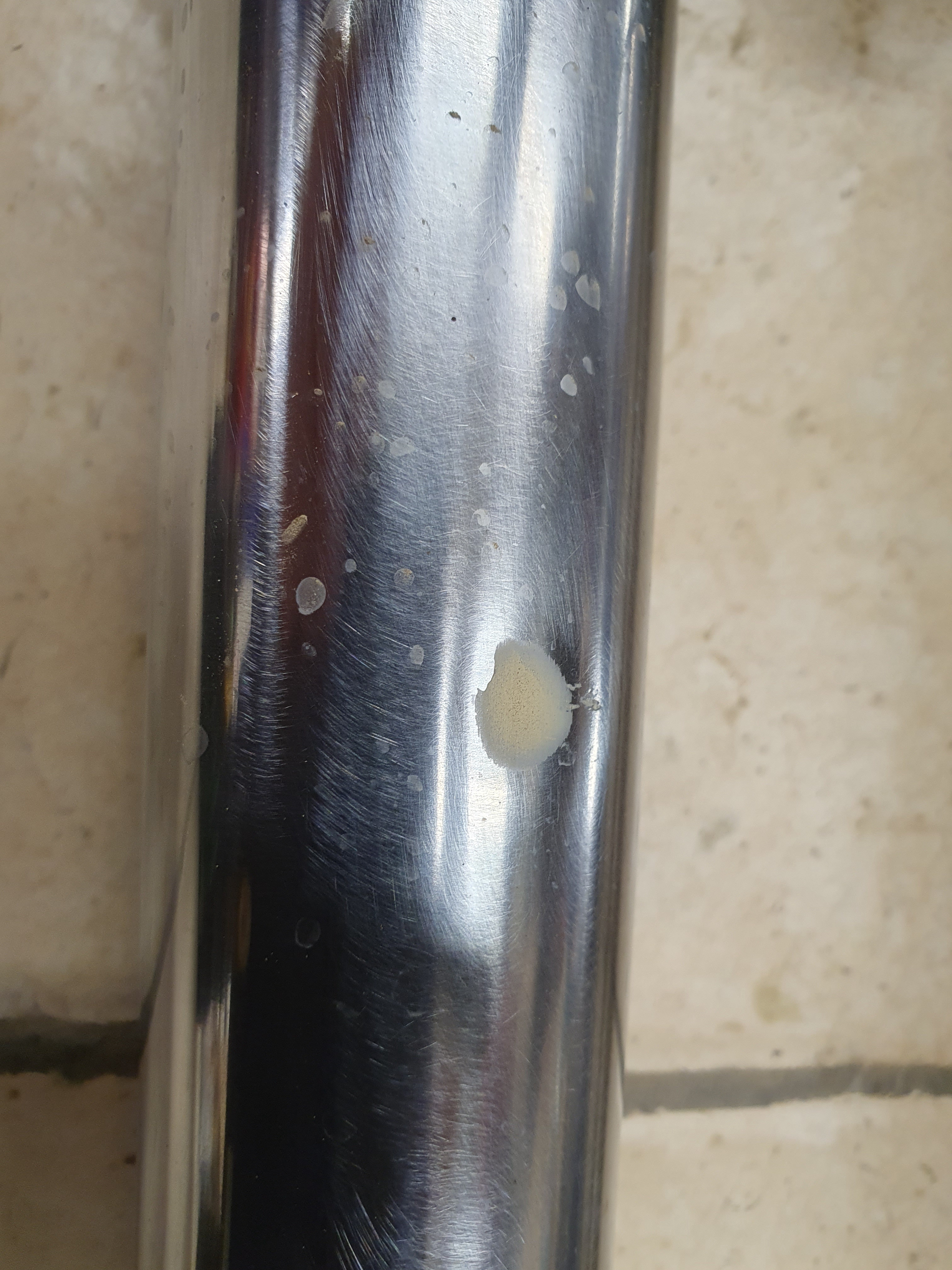

I have had a bump in the inner pipe for some time, I just fixed it temporary with filler..
"My" suspension guy seems to think he can push it out, so I hope he is right.
There is some scratches too that I have sanded down as good as I could..

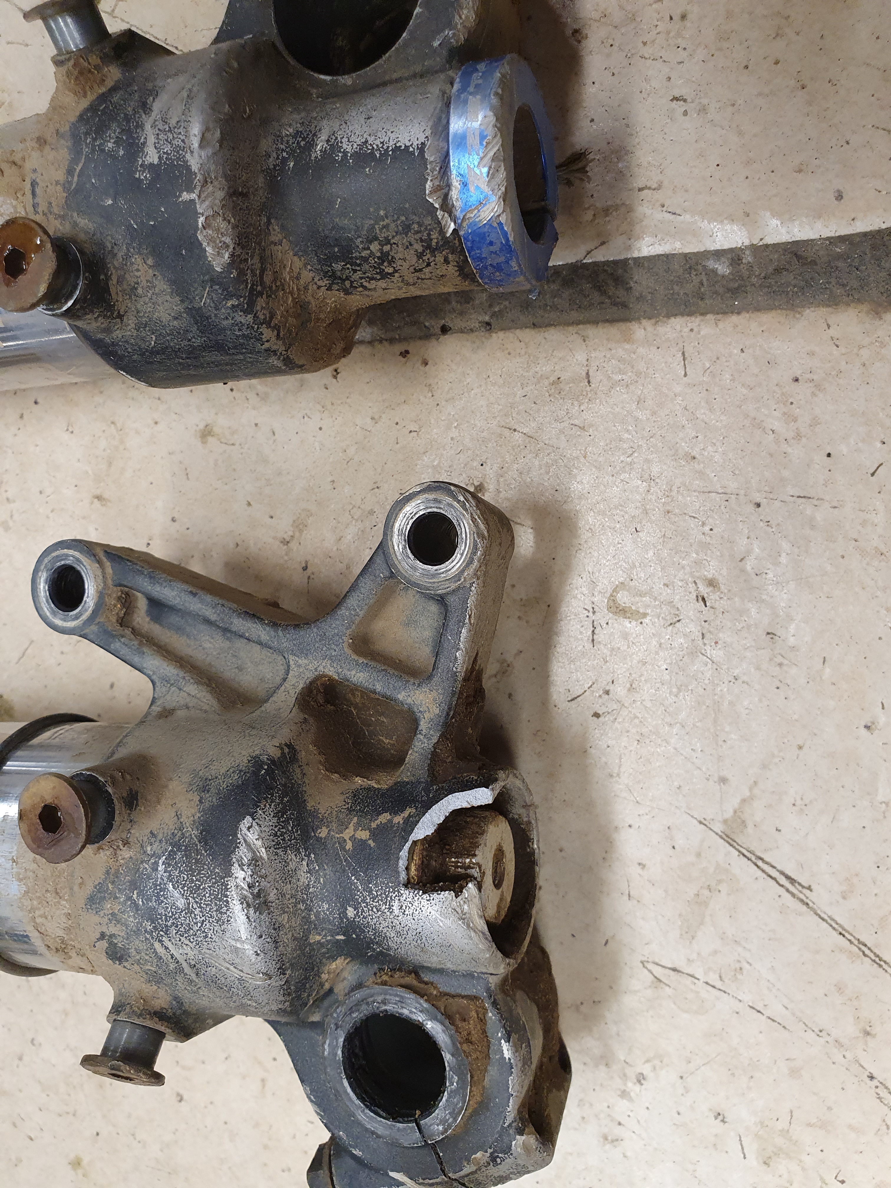

I used to have these blue protector rings on both legs, but I have lost one some time ago.
Now a piece of the leg itself have fallen off obviously, that probably happened today :rolleyes:
Took some sag measurements before I took it off:
In the rear it is with about 10mm preload on the spring.
I haven't updated for a while. I have been a little too busy. I got the suspension back and have ridden with it twice.
He fixed the bump, and he also repaired the broken off piece of aluminum:
He made a new protective ring too, I guess he thought I needed it ;)

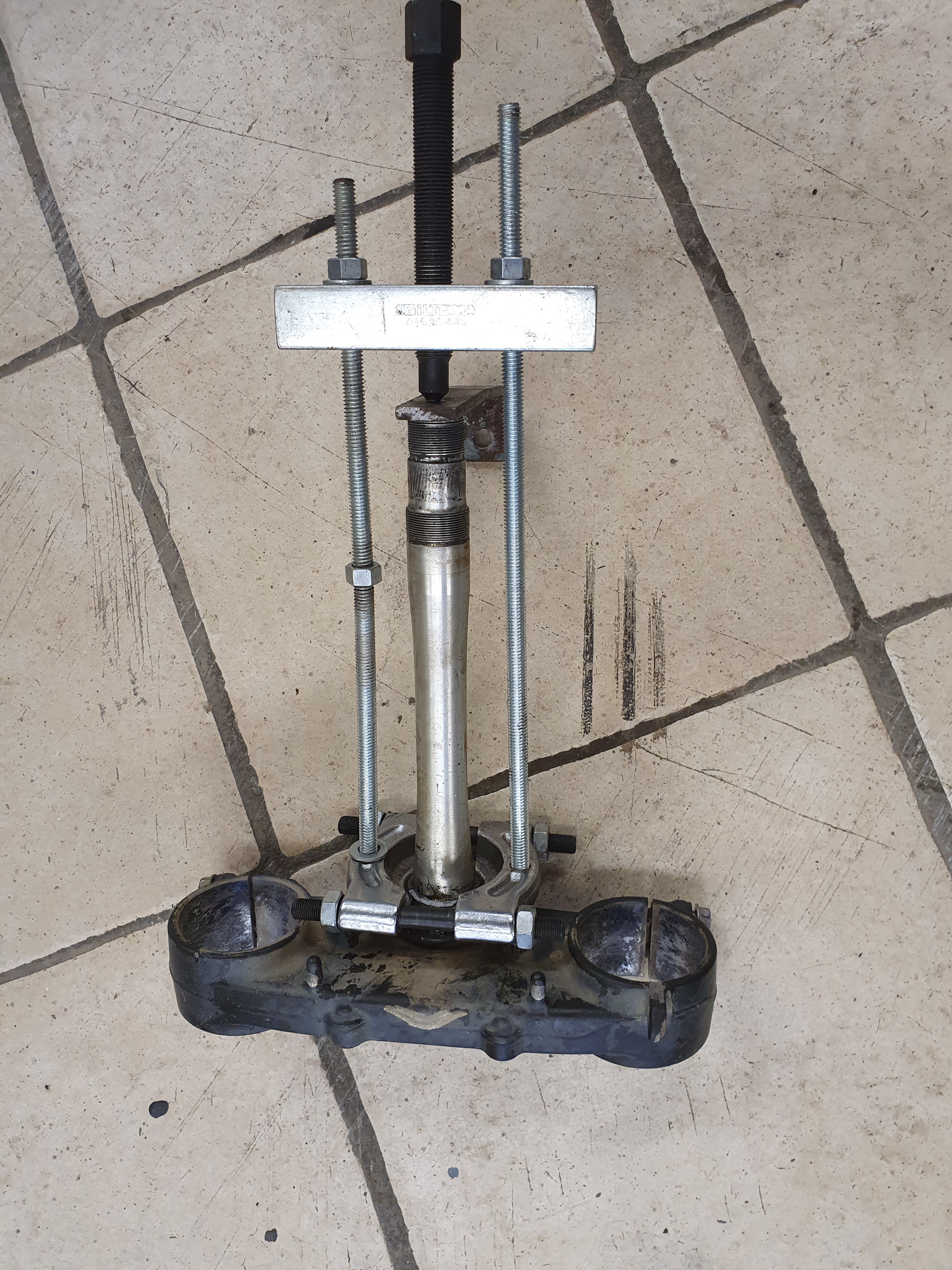

Before I put it back on I changed bearings on the steering crown.
It turned out not to be easy to get the lower bearing off, this attempt failed..
I ended up cutting it to release the tension.

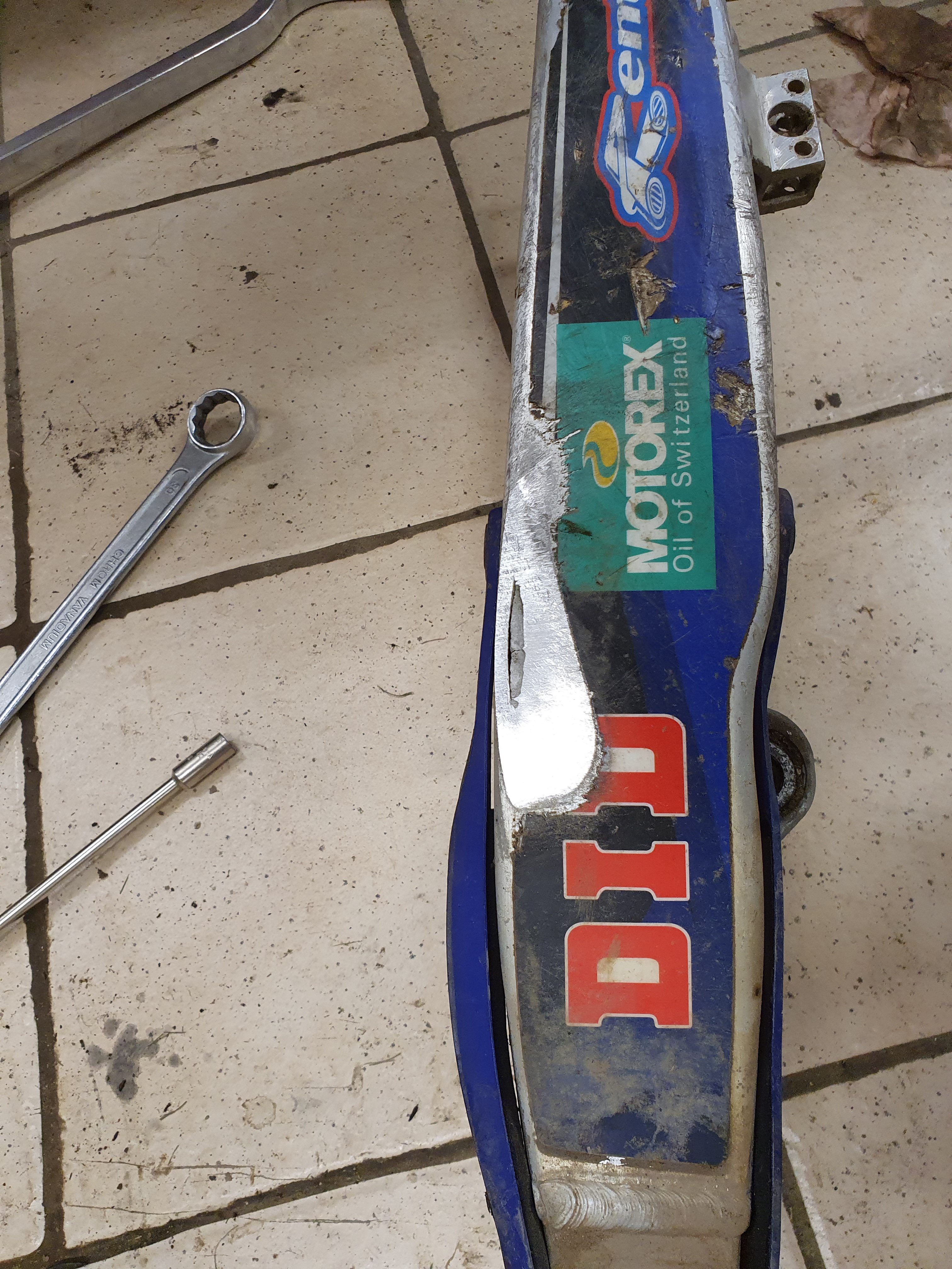

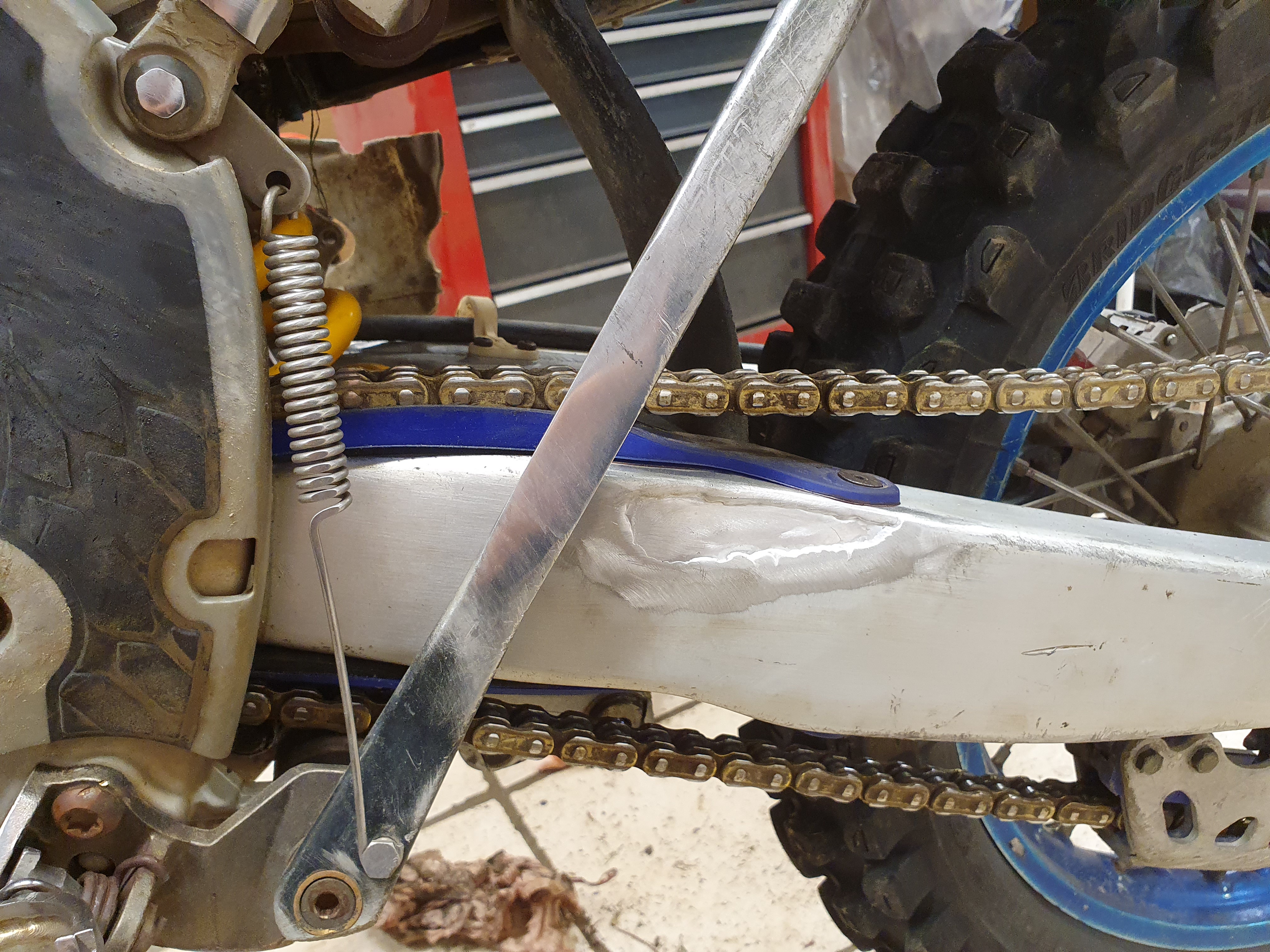

I didn't have time to repair the rear before installing the suspension, so I did it later:
This scuff mark started to be a bit much, so I repaired it:
I cut out a piece and mounted it a little lower to give some extra room.
The plan was to grind down the weld so it wouldn't be very noticeable, but then I decided to keep some weld for wear.
That is why it is so ugly now :rolleyes:

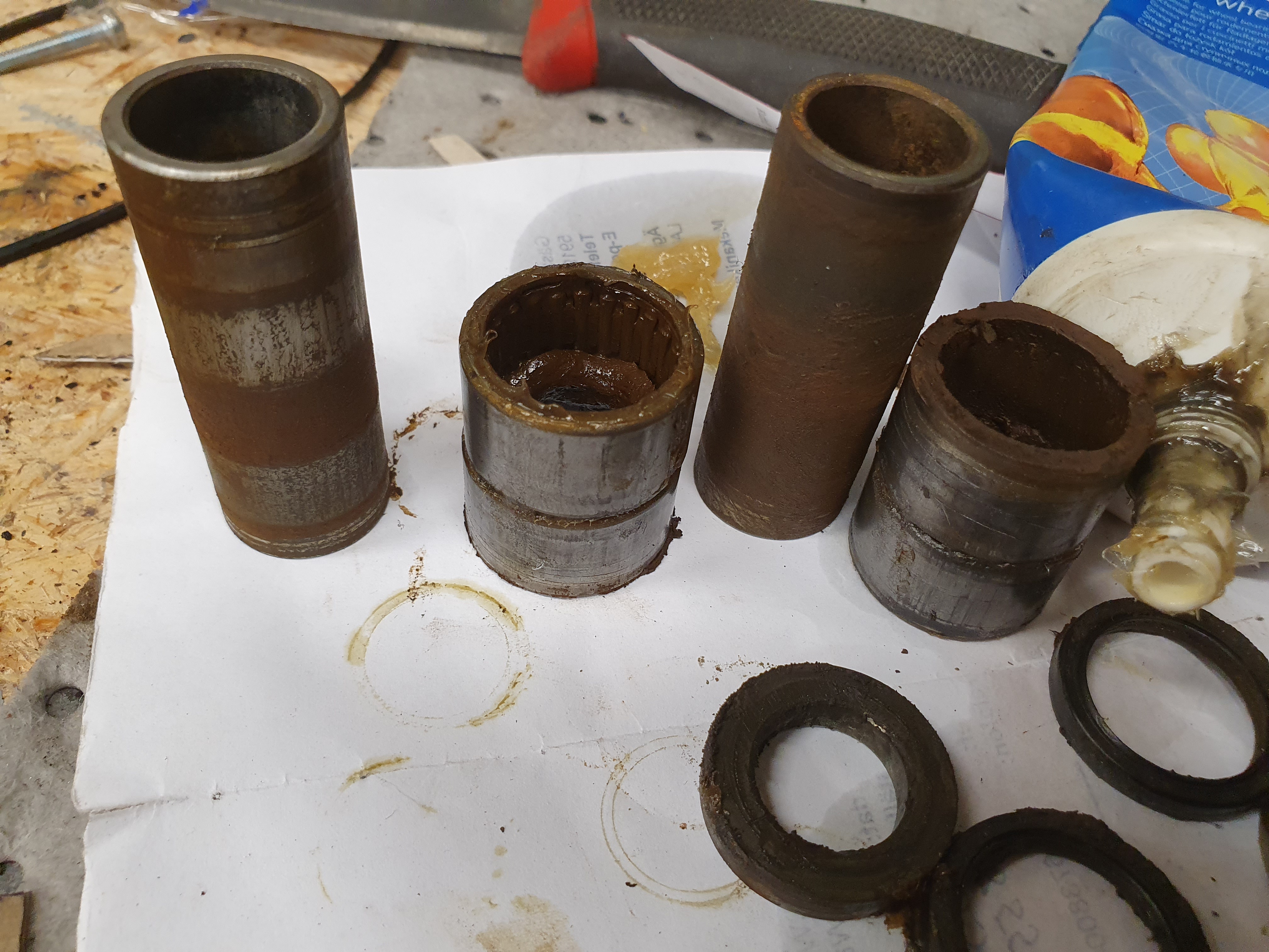

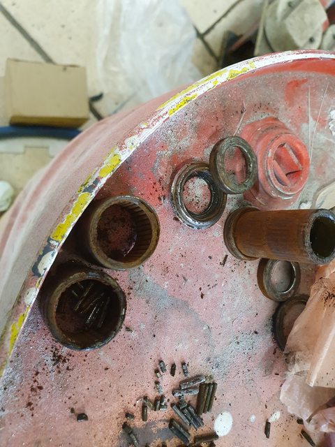

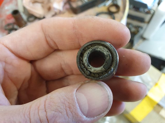

Swing arm bearings, pretty bad as expected..
Bottom shock bearing, worse. I little worse than expected..
Linkage bearings, the worst. A lot worse than expected :oop:
That took a little work to clean up the hole in the linkage..
I also found that the outer bearing on the output shaft had rotated on the shaft.

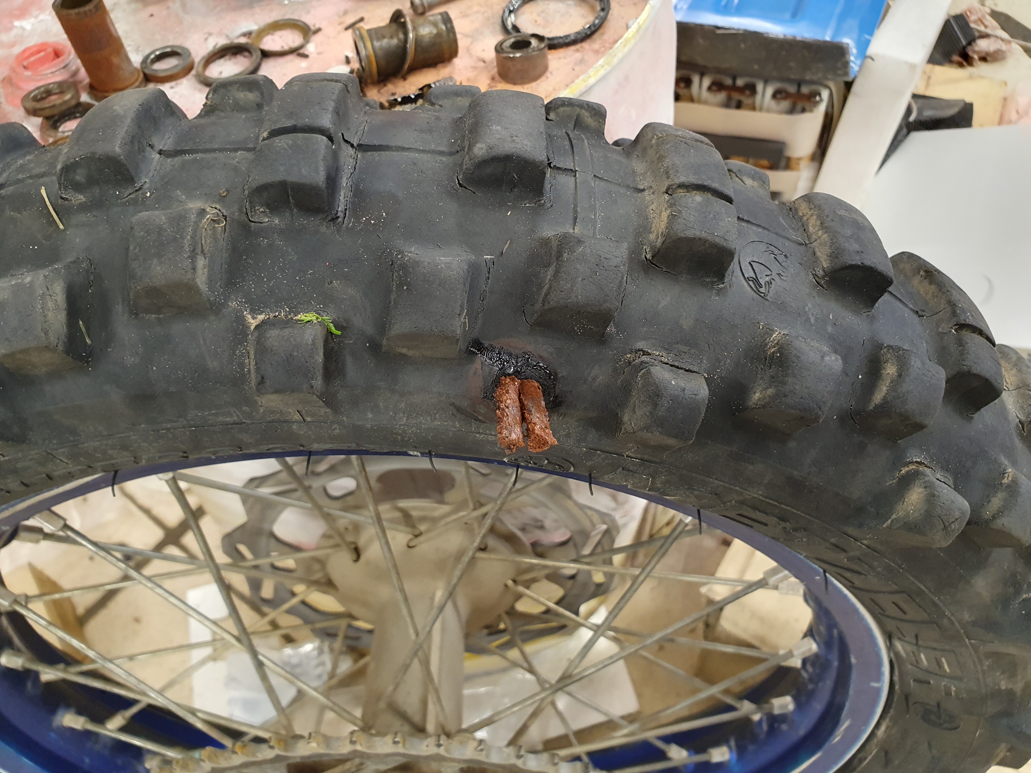

A damn flat again:
On the wheel with tubeliss, so I guess I will try to plug it like that as it was just a small hole.
The plan was to use this wheel in a competition next weekend, maybe I should rethink 🤔
It is nice to be able to set the pressure for the type of riding I will be doing, but those flats are a problem.
At least the tire stays on the rim with the tubeliss..

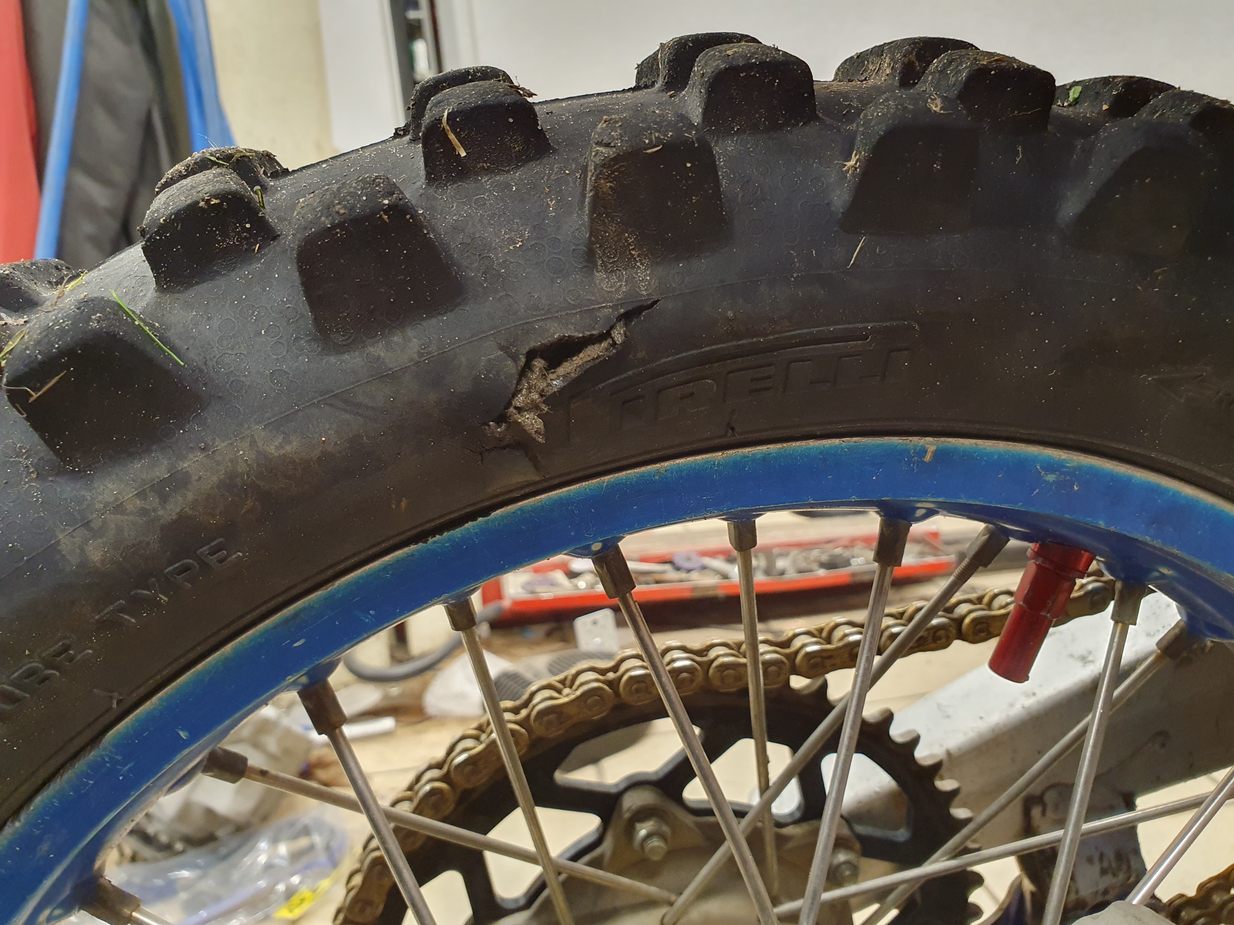

A damn flat again:
Looks like someone shoved a couple giant dog chews into it. :lol:
Or actually like they're growing out of it, trying to tease a dog into chasing you. :p
That tire is looking a bit worn anyways, could be a good opportunity to treat yourself with a new one for the race?
