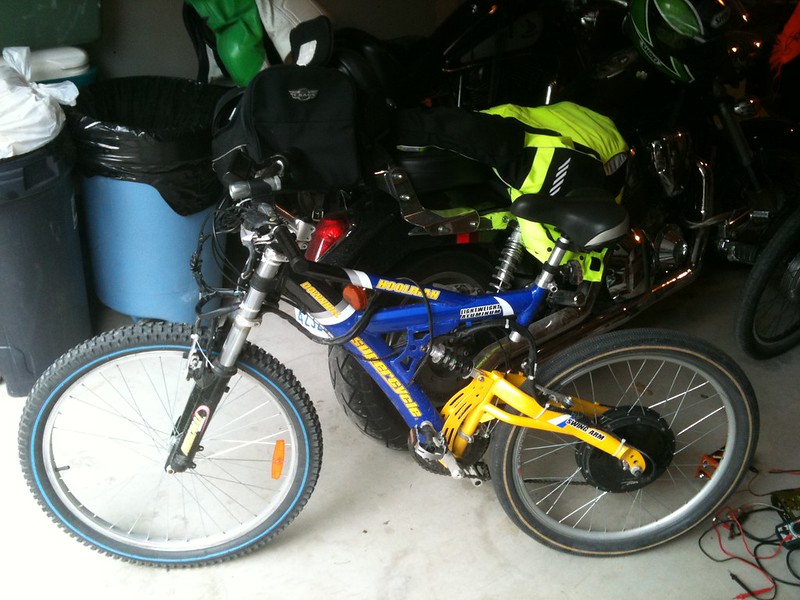

We bought this FS bike for my son's 10 birthday 9 years ago. He now drives a VW Jetta diesel.
I asked him if I could ELECTRIFY his bicycle. He smiled and said: "Sure!"
FS Hoolagan Supercycle 26" Mountain bike
9C 2810 DD Hub Motor

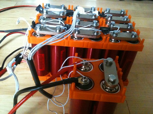

89.6v nominal 28S1P Headway 38120HP with 0.25 T6 Aluminum busbars with stock Headway busbars stacked on top

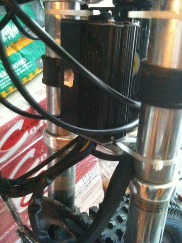

C7225 Controller (running at 30amps)

This bike handles very well. Max speed so far is 40mph/64kph and can sustain 34mph/55kph up a grade with headwind

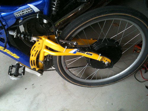

The Aluminum frame seems to have good rigidity with triangles in all the right spots and the rear swing arm is steel
Steel Swing Arm
C7225 mounted up in the triple tree (triple clamp) for good cooling
Steel Swing Arm
