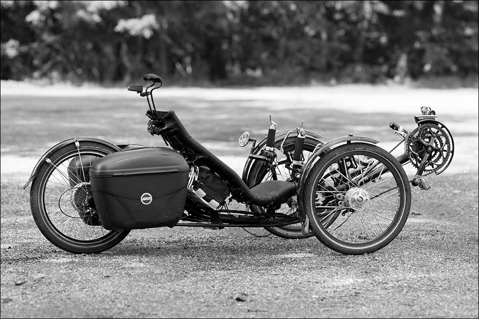

This is my ride, an ICE Sprint with a little Bafang SWXH and 36V/11Ah LiMn battery under the seat. It is allready great fun in this legal but quite restricted setting.
After experimenting with some 50-60V RC LiPo batterys in the last couple of month (way more fun!) I've got a Bafang BPM in 26" rim on order.
Then it will look more like this:
Thanks! 8)
Unfortunatly the ICE trikes have a bit too 'lightweight' aluminum rear frames. Not a good base for a strong and heavy motor like a Crystalite I'm afraid. Apart from legal reasons here in Germany that was the main reason to go for a lighter BPM.

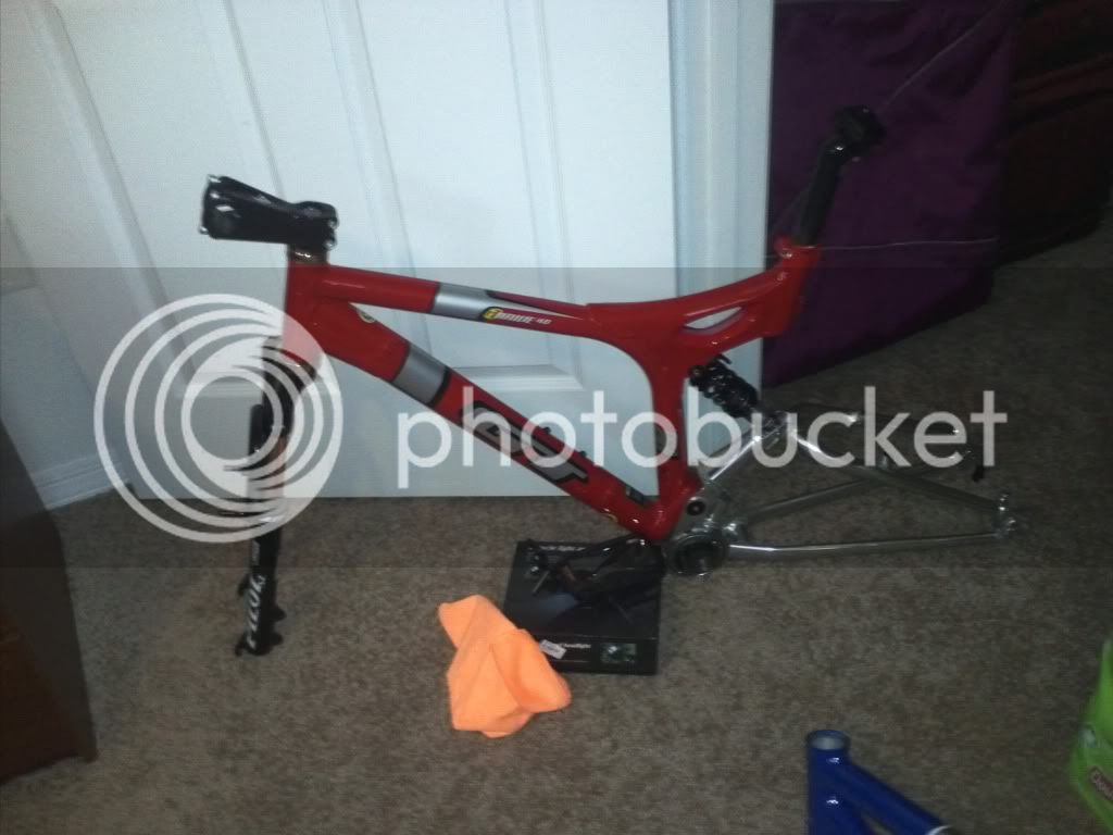

This is the only before picture I have, showing the reinforced dropouts welded on the fork.
This bike is very stealth and most people can't even tell it is electric.
It has a 36V 10Ahr battery, Cycle analyst, BMC 30A controller, and it does about 27mph with BMC V4C motor / 200lb rider. The whole system adds less than 20 lbs so it still pedals very easily.
