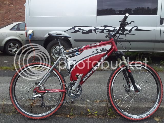

yea really nice build mate... where's the batteries though? is it just a small amount in the triangle?
seems really quiet too, or is that just the moovie? love to know more detail re the slipper clutch too.

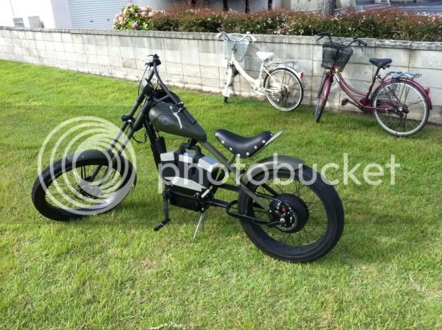

Belize E-chopper 48v 12ah sla
After Upgrades include,
Faux tank with storage bags inside
Custom 2.5 inch thick all black front rim 26er with 3 inch kenda flames (just barely squeeze in the forks)
New full coverage front fender
New all black fat pedals
Added two chain links
New front and rear bb5 disc brakes, inner rings painted all black except the braking surface
Brakes required removal of v brakes, hand sawed the stems off the forks, also bought a disc brake adapter for the front forks (cycles us)
Bought a a2Z disc brake adapter for rear dropouts, both adapters allow installation of brake caliper for frames without caliper holes.
Vintage mechanicla speedometer (still waiting on the cable drive in the mail)
Cree bright led headlight
Painted chain guard and sprocket black
Painted rear rim matte black
Painted top tube of the bike frame olive drab to match
Painted forks olive drab to match
Painted all chrome either black or green, chrome on bikes (motorcycle or bicycles) are more tack than stylish because they are overdone.
Also not shown installed is a rear rack with a speaker box and brown canvas panniers
THe stock bike cost 6-700 bux from amazon
and prolly parts and paint materials and tools and shipping add up to maybe 5-600 bux
i can upload some more pics that show a new leather seat and speaker box rear rack
