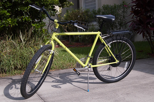

I finally finished my second build and have been enjoying commuting with it for a couple weeks now. The goal was a short-distance commuter with good handling, and a clean look. If anyone is interested in details, let me know and I'll post a detailed write-up on the build.
Unfortunately, I didn't get any shots of the donor right after I bought it, but it was in rough shape (as you'd expect for a 25 year old bike). Here's one post tear-down:
Reconditioning in progress:
Base bike reassembled and motor installed:
Build complete!
Motor is a 500W Bafang BPM2 (code 10) with a KU93 controller. The battery is an Ebikekit.com 36V 9Ah LiFePO4 that I reused from my previous build.
