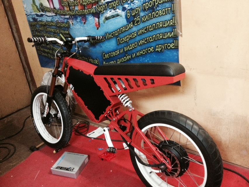

Hello, I'm Anek from Thailand land of now no body smile anymore. It's my e-bike but not finish yet!!!
Thats a neat build stormer.
Few questions from me:
Is this a custom bike or is this frame available for DIY people?
Where is the battery?
How does the rear brake operates?
It is custom bike. Start from drawing in actual size by Ai. And then send out for water jet cutting or milling. fork, swing arm, rim & tire i bought it from honda MSX parts.
Some parts from milling & water jet cut
Battery & controller
Brake hose is too short, I'll cut and resizing it. May be draw a new disc make it wider and send it to laser cut use stainless steel 1.2 mm.
(Sorry about my english)
