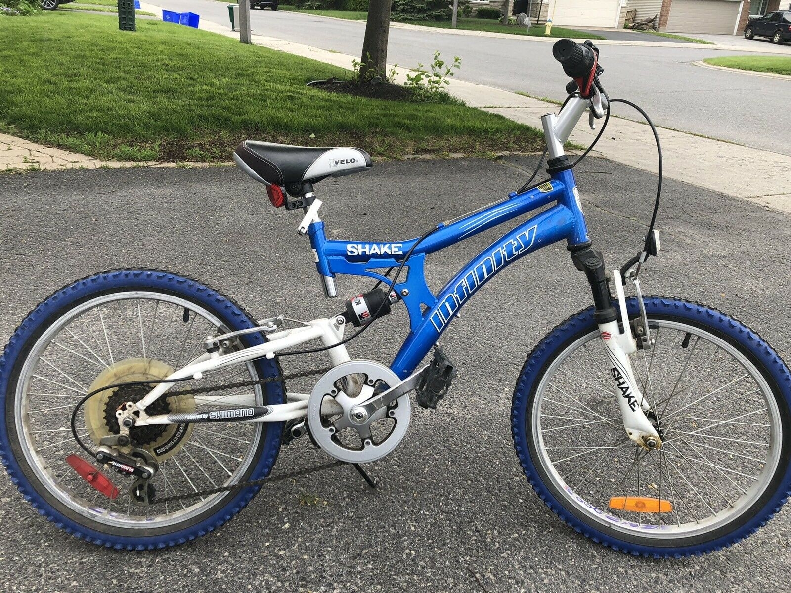

first pic shows bike soon after it was bought and it mostly sat with plans for rather far future or doing christmas tree's job meanwhile.
every pic must be under 500kb or 400kb not sure it must got green tick if its ok to upload
if its a 20" get a 16" motor bike tire 120/70 for rear =]]

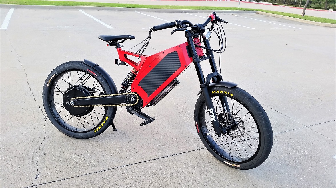

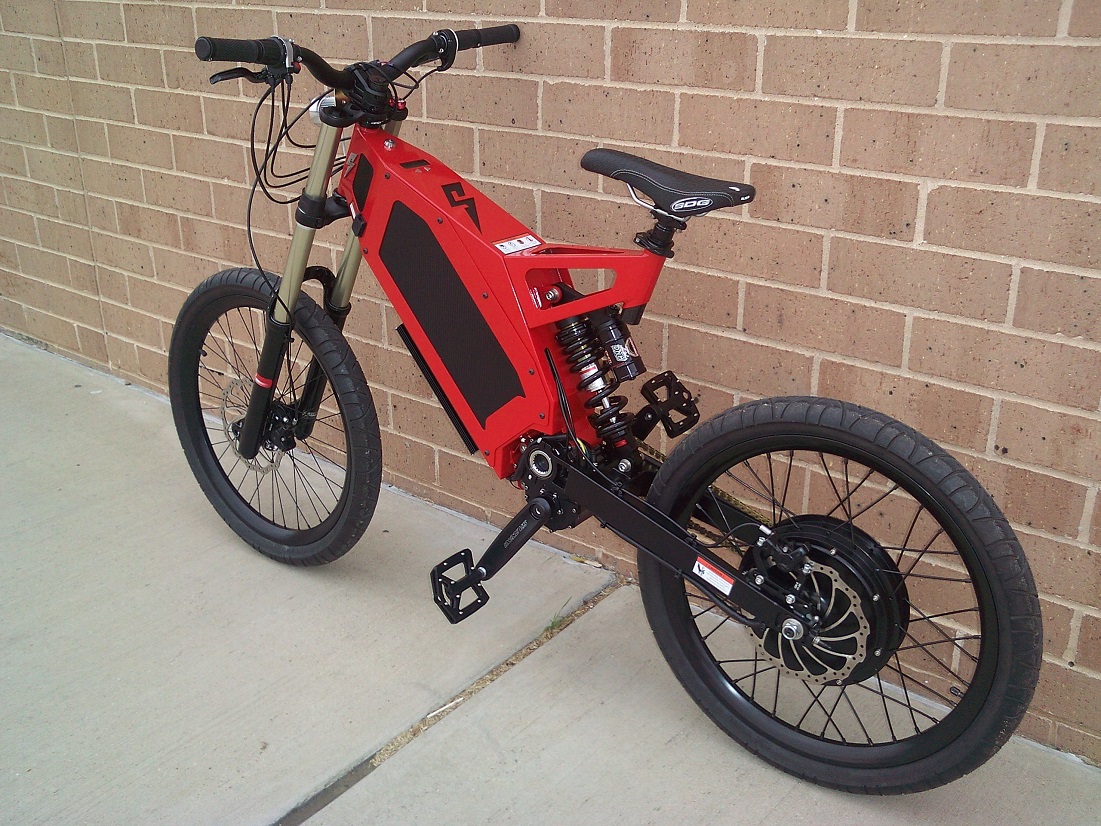

2x hub motors front ~20A back ~30A
new battery 13S 4P Samsung INR18650 25R /high drain/
this where i am at now :twisted:
not finished i had work to do redid my old battery and sold it to a friend =]]

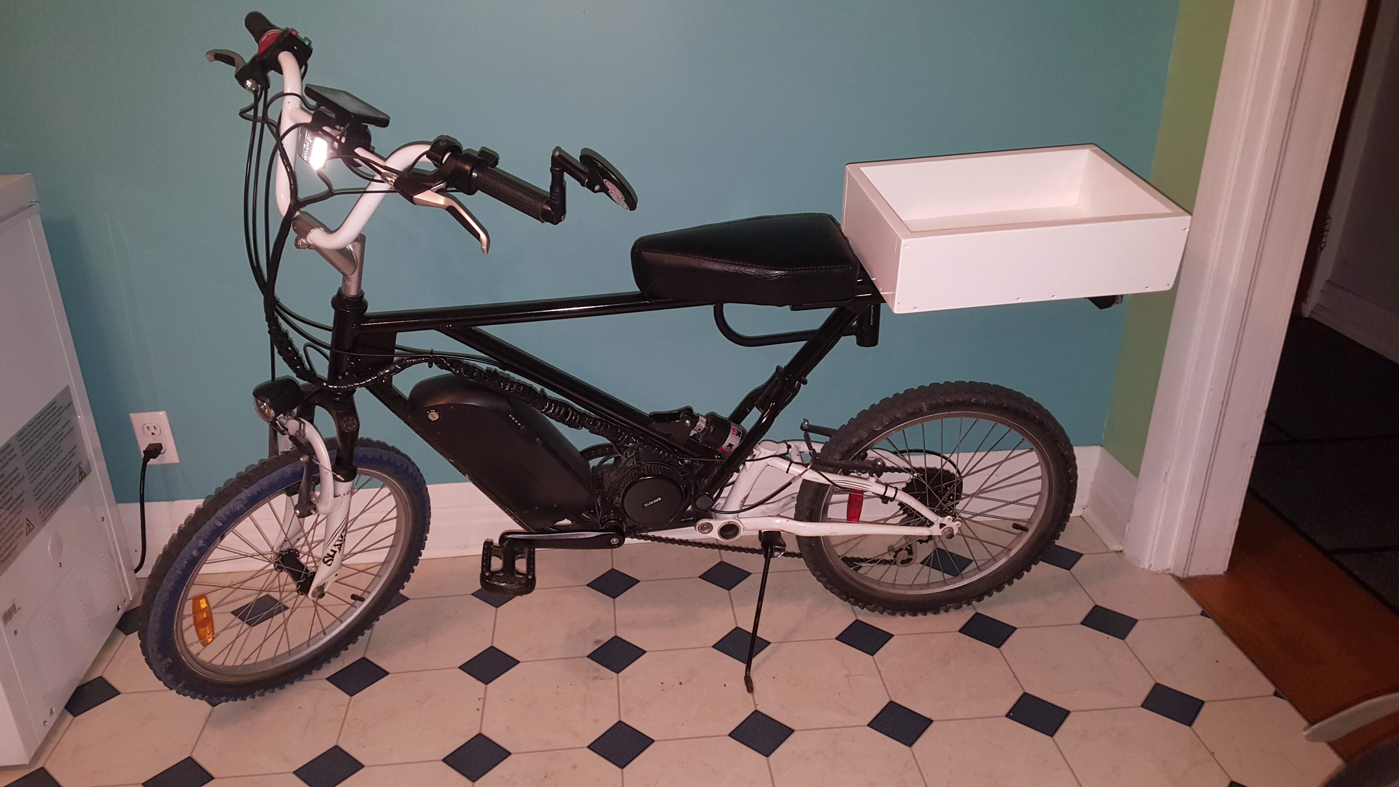

i got a invertor welder Raider RD-IW21 , 20-120A
when my batery is at 40v 13s/3v/ when i start charging with the welder it puts into the batery 16-18A then slowly start to drops
the amps when the voltage get up and near 50v and up is under 6A and near 54v is under 5A
so i got full charge from 3v to 4.3v on the volt meter for 55min and i waited 15min the battery voltage drop to 4.2v
this is sooo cool but not all battery packs can be charged like this this inverter outputs 65v on open
and if your pack is higher voltage than 54.6v you will not charge the entire battery if batt voltage is more than inverter voltage
