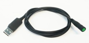

These instructions on updating the Bafang BBSHD firmware, to fix the problem with using 52v packs, were sent to me anonymously. I rewrote them to compensate for filename changes of what's actually on the first site, and the filename of the actual firmware file sent, and combined the two separate sets of instructions given as they cover the same things in different levels of detail. Some steps have been broken down into individual steps for clarity; not having one of these units I don't know if I've done them right.
If anyone with the equipment that has done (or can do) the steps finds anything incorrect or insufficient, let me know and I'll update the instructions, to make this as easy, painless, and foolproof as possible for anyone that needs to do this.
I don't know what the "programming cable" itself looks like at the BBSHD end, presumably the same as the Display cable.
EDIT: here's a pic of a bafang usb-serial cable:
bafang programming cable.jpeg (14.02 KiB) Viewed 19149 times
I've also included the original instructions at the end of the text file attached to this post (which also contains these instructions).

1-- Download the file stc-isp6.86.rar from http://www.stcmicro.com/rjxz.html
(file also attached to this post, or skip step 1 and 2 and download the stc-isp-15xx-v6.86E.zip from the attached file)
stc-isp6.86.rar
(3.5 MiB) Downloaded 689 times
(3.54 MiB) Downloaded 1177 times
2-- Extract stc-isp-15xx-v6.86E.exe from that file (using WinRar, 7zip, etc; a google search will locate the appropriate websites for those, and instructions how to use them) and run the program
3-- Insert the programing cable (USB-Serial Adaptor) into the computer's USB port, and install whatever software it requires. (Note says that FTDI based USB-serial adapters work well, but I assume you MUST use a USB-serial that's got the right connector for your BBSHD, presumably the round 5 pin green Higo). A COM port (often Com5) will be assigned to the port--if it tells you which one that is, write it down.
4-- Open the STC programing software.
5-- Select "Single Chip Microcomputer Type":"IAP15W4K61S4" (which is under "STC15W4K32S4 Series");
6-- Select the Com port that was assigned to your preferred USB-Serial Adaptor. (If you're not sure which one it is, it shouldn't hurt to try any of the ones it lists until one of them works)
7-- Change the settings for Max Baud to 57600 and Input IRC frequency to 18.432 Mhz
8-- Press "Open a Program File" (may be labelled "Open Code File"), and browse to the location you saved the attached file CRR10E4830E105001.1_190413-1.bin, and open it.
9-- Plug in the programing cable (using the EB-BUS; one end of the EB-BUS is linked to the EB-BUS cable at the controller, and the display cable at the other end of the EB-BUS is linked to the programing cable);

this is my cable works for this firmware fix just posting this to help anyone that needs tips on a quick easy programming cable could be done with no soldering iron or heat shrink.
video link usb cable:[youtube]https://youtu.be/gdmv0JjRdL4[/youtube]
uk ebay: https://www.ebay.co.uk/itm/CH340-Gold-U ... Swn8pbGiuK
uk amazon: https://www.amazon.co.uk/DSD-TECH-adapt ... pons&psc=1
silicone wire:https://www.ebay.co.uk/itm/Flexible-Sil ... 34dd12c815

Just be very careful to plug the wires into the right pins on the Higo.
I've also had problems with some of the cheap ftdi adapters. The Bafang controller needs the logic "low" to be really low, like less than 0.5v. Some adapters only bring it down to 0.7v and you have connection problems. This can be fixed by putting a 1k or so resistor from Tx to ground to pull it a little lower.

I'm confused, can this be done with the normal programming cable? I was under the impression this was different.
amberwolf   100 GW
Posts: 32152
Joined: Aug 17 2009 6:43am
Re: BBSHD Voltage Problem Firmware Update & Instructions
Post by amberwolf » May 17 2019 10:28pm
furcifer wrote:
May 17 2019 6:04pm
AFAIUI, that's what the instructions say--the bafang USB-serial cable, that plugs into the LCD port on the wiring harness to the controller (in place of the LCD). Some days back I updated the instructions with a photo of a cable from another site that described the settings changes process (different from the firmware process, but using the same equipment apparently).
furcifer   10 kW
Posts: 647
Joined: Dec 21 2018 12:36pm
Post by furcifer » May 18 2019 10:16am
amberwolf wrote:
May 17 2019 10:28pm
furcifer wrote:
May 17 2019 6:04pm
I saw that, and the post from Cbisbaf. I just wanted to make sure before I brick a 48V controller, they're annoying but functional.
