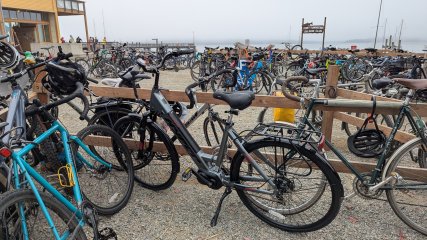

We had festival in my town this weekend and the Hyper bike got a lot of use going up and down hill.
It doesn't look all that cheap, does it?
The bike's electrics worked well, but the brakes are abysmal. Out of the box this thing needs a decent saddle and new brakes. Already replaced seat, a set of hydraulics reside in the bike parts pile.
Wider tires would be good, so would new wheels (which would probably come from a used bike, if at all.) Bought cheap, keep cheap, but up the quality.
My baseline hope was for this bike to be a better all around mid-drive motor than the 36v TSDZ2b. It beat the TSD hands down. Which happens now to be on sale at Electrify Bike for $495.
I'd call it a pretty good mid-drive for $350, even if you were to dump a couple of hundred more into it.

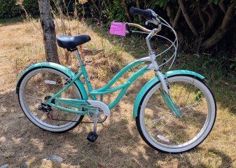

Without the motor the bicycle would be junk. The step-thru frame is nice, but step-thru bikes have rained down me of late, like this one:
