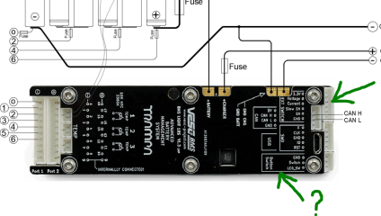

Anyone have more information about ''external power switch''?
I think the "Button Switch" sounds like it's for a switch that you can use to turn power to the ESC on and off, hence the LED_SW which is probably for an LED on the switch to light up when it's on.
The inputs for an external shunt though seems to indicate there is a way to have an external contactor, since why would use you an external shunt other than to pass more charging power than the internal shunt can handle so that would indicate that's more power than the internal charging FETs can handle too.
I think maybe the "EXT Switch" area might be what you are looking for? If there isn't anything about that port in the documentation I would ask VESC labs about it.

for some reason my head autofilled that picture being of the VESClabs BMS
I think you could use the charge output to enable a contactor or similar for charging.
I have thought about that solution too, but I worry that if the bms only cut the charge mosfets the contactor might still stay closed off the discharge fets :unsure:

Answer from Trampa about the BMS external power switch 😕
There is no more development for the Trampa VESC BMS, unfortunately the external power switch function does not work. You will need to make your own solution for that.
