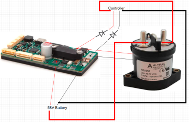

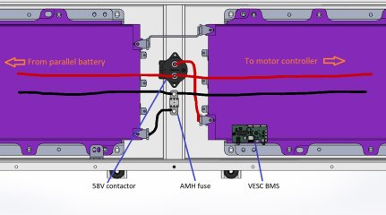

Is that can work in order to use the VESC 16S BMS, but bypassing the mosfet to allow my need of 100A charge and 250A discharge?
I also joint typical wiring diagram limited to 15A charge.

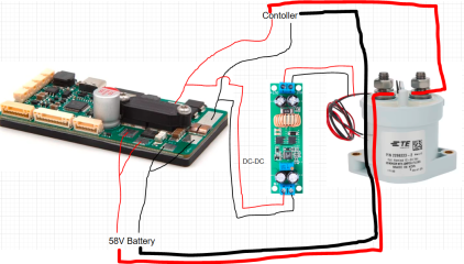

Ummmm! I don't even need DC-DC as contactor with 58V coil voltage are available :)
That probably works tbh but you'd need to remove the link between the vbms and the controller otherwise i don't think it would ever turn off
Is it because current between VESC device will not match?
My goal is to have the battery protect from overcharge from MPPT or grid (charger) and protect from over discharge.
If this contactor bypass work for over charge, but won't work for over discharge cause of no communication between VESC ESC and VESC BMS, I'm ok with that.

Is this will still work despite I'm bypassing the fet's?
My concern:

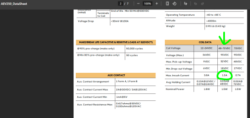

If I understand correctly, the contactor need up to 1.3A to close and the BMS precharge at only 0.8A...
What he means is if you wire it how you show, once the contactor is on it will just be feeding power back to itself so will be latched on.
The precharge not being enough will probably mean the contactor just won't fire until after the precharge phase, idk how the precharge works, does it limit the current until the output voltage to the controller is to a fixed point or is it timed based.
If you just only wire the BMS to the contactor and not to the controller it will solve the latching the contactor on problem but you will have no precharge function. If you wire it like you have but install a diode so to the contactor cannot power itself as I mentioned a few posts back that would work and the precharge may work probably just not quite as well as inteneded depending how it works because the the contactor is sucking up some of the power but the contactor won't draw 1.3A right away. The precharge will limit the current to 0.8A which means the contactor plus the capacitors in the ESC will mean starting at a low voltage (where the contactor will no draw much current) and then increase as the capacitors get charged, doing the pre-charging and as that happens the contactor will draw more power maybe triggering in that phase but probably at a point the capacitors are already charged enough. The timing of all that depends on how the precharge system works.
Oh! I catch it. So, yeah, with a diode (or two?) between controller and contactor coil that can work.

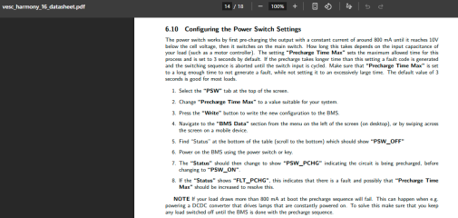

Based on BMS spec sheet: pre-charging the output with a constant current of around 800 mA until it reaches 10V below the cell voltage.
It's adjustable via “Precharge Time Max” in VESC tool and default value is 3 sec.

I think my biggest problem can be if the contactor can close with as little than 0,8A and scrap the precharge.
Is it possible to simply slow down contactor closing procedure?

No you can't use the discharge port, I mean you can it will charge just like regen but it won't be able to stop the charging which is kind of the whole point. The body diodes of the big Mosfets will just allow current to flow even when they are turned off. Common port BMS have two mosfets wired in series in opposite directions to solve this.
So, if I've understand everything correctly, I can use the VESC BMS 16S with a contactor to allow my need of 100A charging and 250A charging.
Downside:
-Coulomb counter is screwed.
-SOC only related to Volts.
-Contactors consumption up to 0,08 kWh / day 😬
-Precharge can be compromise (manual precharge can be need).
-Non polar contactor is needed as it can open under charge or discharge
-Other?

You only need one diode on the positive.

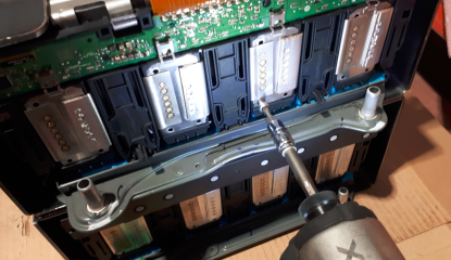

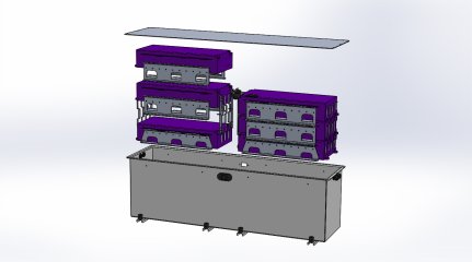

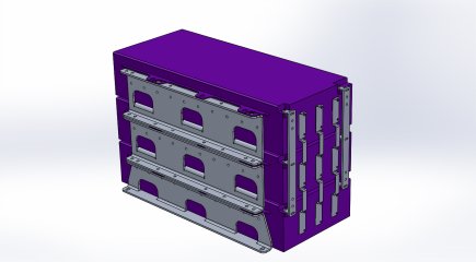

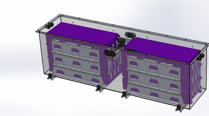

Not exactly related to motor-controller-technology, but here is the 16S battery I plan to build out of a Caddy Lyriq battery.
51 kWh, so two in parallel will give us 102 kWh.
To connect 6 modules to 1 VESC BMS, I have to connect 3 modules in parallel at cells level with busbars.
GM start with three 97Ah cells welded together to create a 291Ah cell. Then, I create a 873Ah cell out of 9 cells.
Battery measure 60''x15'', roughly 640lbs (each module is 84 lbs).
I will have to assemble it inside the boat 😉
Everything is aluminum. The battery box, the supports, the busbars.
