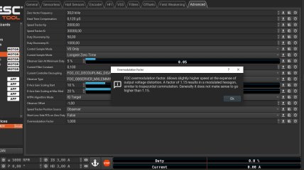

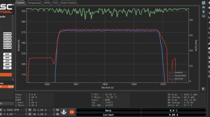

Still playing with different parameters to fine tune VESC.
One of my best result : 9 kW at 690 rpm.
It's really nice to see that phase amps are not to high at around 230A.
Edit: turn PA to 350A just for fun: 9.6 kW at 725 rpm
Edit 2: Turn ME1507 PA to 1200A: 10 kW at 680 rpm
I think it's time for me to find a 16S (60V) battery.
