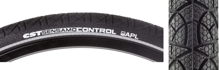

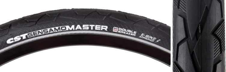

So I may try out their "CST Premium Sensamo Control Tire, 26x1.75, Black, Sc/APL"
or "Cst Premium Sensamo Master Tire, 26x1.75, Black, Sc/Db"
as some of the reviews state the Control is a very grippy tire.
