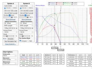

I thought of a way to widen your power delivery speed range. If you have two batteries of the same voltage and two controllers, you could switch between half voltage and double current or double voltage and half current. You could use a big multipole switch to change batteries between series and parallel and to switch between one controller and the other. If the motor is rated to take the higher current then you would have a mountain climbing speed range and a faster but lower torque operating range for roads and less steep terrain.
That's not really how electric motors work, switching the battery voltage while keeping the motor the same will do basically nothing. Technically there is probably some very very slight change due to switching losses or something. To change electrical "gears" you have to change the motor winding and even then the advantages are slight unless your operating speed range is massive. This isn't unheard of, that is having two sets of windings that you can switch into parallel or series but it's pretty rare and again only works if the speed range is quite large, which based on his conservative top speed isn't the case.
Thinking about ways to make a bike adapt to increase range, with fat tires an automated tire inflation system would be interesting. You could use two of those tiny battery pumps mounted to the hubs. To make it really automated though you would need a system to release pressure to a set pressure, which could also be done. Central inflation would be pretty neat, too bad I only ride my fatbikes in areas where low pressure is always needed or it would be a cool project.
What I was suggesting was having for example a 48V 25A controller alongside a 24V 50A controller that get switched over when the batteries are changed from series to parallel. With any given single motor winding, the motor will find a lower efficient speed at lower voltage, even if the higher voltage controller can serve up the same maximum current from a stop. Which it probably can not.
The low voltage configuration will most likely give more torque at low speed, but definitely will deliver better efficiency and less heat at low speed.
It depends on what you're looking for. Higher peak current is higher peak torque (or percieved power), but that's applies to peak of the torque curve, that is at stall on an electric motor. For my ebike riding, that peak isn't of much use, but for a wheelchair trying to get up a curb, it might be. Raising the voltage shifts the torque curve so there is a much greater torque advantage at ebike speeds. This is why, given a choice between the two, as long as the peak torque of the higher voltage system is adequate, I'd choose higher voltage, and just keep it that way rather than switching back and forth.
PS. I didn't adjust the internal resistance of the pack to reflect the serial vs parallel arrangement, but I doubt it matters much. I used 2x battery current for the phase current limit.
I understood exactly what you meant, it's just not correct. The same motor, at the same speed and phase current will be basically identically efficiency wise if you change the controller input voltage in this range (yes if you like change it from 2V to 300V or something you are going to start to get some weird very extreme switching and inductive losses). The lower voltage config will give exactly the same torque if the phase current is the same and the efficiency will be basically the same.
If you want to make a motor run very efficiency you need all of the losses and you match those will the load and you select a winding that fits the speeds and torques you need. Many many of these ideas of, oh the motor is more efficient when XYZ have basically nothing to do with those factors and are just because those mean the motor ends up operating in a more efficient range as a side effect of the voltage, current, and windings being well matched. Put simply you run a motor too fast with too little load, it's inefficient, you run it too slow with too much load it's inefficient.
For example:
Note something important here, I've turned on the auto throttle and set the speed to the same. So same motor, same speed, same torque to maintain that speed. IDK does that theoretical 1.7% increase in efficiency seem worth it? Pretty sure the weight of the controller, switches, etc, could be used for a few more batteries. And note I did adjust the battery resistance.

There are useful characteristics of higher voltage used with the same winding motor, namely re top speed. Changing to higher voltage has saved bikes that were too slow for me otherwise, even ones that supported field weakening. Field weakening is very inefficient.
It's very difficult to get the motor simulator to claim top speed would be the same for double the voltage:
Even with auto throttle giving an unfair advantage to the lower voltage configuration (I always run full throttle anyway in actual practice, unless at the speed limit), the baserunner controller I use still ends up running faster at higher voltage:
