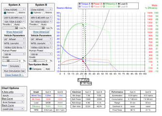

I believe what I modeled in the Grin simulator in post #74 matches what was described, using consistent assumptions/components in both systems for things not specified. Let me know if there are any errors or inconsistent assumptions. The exercise is really about maximizing performance with the batteries you’ve got, which are two fairly weak low voltage batteries. Even though they are weak, they can still manage 30mph, but dog crap slow getting there, but it gets there. But it’s totally gutless for getting up a steep parking garage ramp in high speed mode. So, at the ramp, you switch to double torque mode, ride up at 10mph, then switch to 150% speed mode for the street.
PS. The simulator does not model battery current capability directly. That is done by setting the custom controller battery current limit for purposes of running the simulation.

I believe what I modeled in the Grin simulator in post #74 matches what the OP has described, using consistent assumptions/components in both systems for things not specified. Let me know if there are any errors or inconsistent assumptions. The exercise is really about maximizing performance with the batteries you’ve got, which are two fairly weak low voltage batteries. Even though they are weak, they can still manage 30mph, but dog crap slow getting there, but it gets there. But it’s totally gutless for getting up a steep parking garage ramp in high speed mode. So, at the ramp, you switch to double torque mode, ride up at 10mph, then switch to 150% speed mode for the street.
He doesn't talk about batteries being a limiting factor at all, only about the motor and controller efficiency and power.
I think what you overlooked in your simulation and what Apart insists on is the motor current. Here is an example and I'll try to explain everything I did carefully.
OK so first, everything the same, same motor, both all fully throttle. Now the battery of course same as if you had two packs and series paralleled them. These are wimpy batteries as you said, they are the limiting factor so they can only output 5A in series or 10A in parallel.
Controller can output 100 phase amps (called mtr amps in the sim) because we want as much torque as we can get. In your sim you changed the motor amps to half by using a controller with half the motor amps for the higher voltage battery setup as Apart suggested. But why? You can just use a controller limited to as many motor amps as the motor will take.
So you can see the curves line up the whole way through acceleration, same efficiency, same torque, same power from the battery, higher voltage battery setup draws half the current but twice the voltage so same power. So the battery is the limit the whole way through.
I know it seems like a free lunch but it's just you aren't changing the motor so the same motor will act the same with the same current. There are losses involved in increasing the speed with more battery voltage, primarily magnetic ones but this tend to balance out well in our uses because we are using motors that are well sized to the application.
Wanting your controller to multiply battery amps by 10X or 20X is not the same as it doing that. I have not messed with every controller around, but the ones I have worked with can deliver 2X to 3X phase to battery current ratio.

Maybe a real world example might support you idea a bit better. The simulator creates very odd results when you put in values not based in reality.
I think it’s obviuos to conclude that the batteries are providing their max current in the two configurations, for most, but perhaps not all folks.
‘If you have two batteries of the same voltage and two controllers, you could switch between half voltage and double current or double voltage and half current.”
In that example that is not happening, the motor current stays quite low, there is no magic here. The motor current is the same for both battery setups the entire time.
I mean the simulator, simulates, pretty accurately in most cases and the cases that I'm aware of where it fails we have not entered into (eg motor saturation).
Here we have the controller current set low, no magic "multiplication" of current
Lets bump that motor current up a little so it matches lower voltage battery
Still no dice, ok well what about we bump it up more, now the motor current is twice the higher current battery config so we are not limiting it there.1779378893022.png
These values all seem pretty reality based to me, I mean pick any values you want you just need to keep the phase current setting the same because saying a lower current controller has less torque is just a fact. The motor doesn't care what the battery voltage is, it cares how much current it gets and to it 100% duty cycle at 24V is the same as 50% duty cycle at 48V.
Yes there are good reasons to select the correct motor and battery but we aren't in those areas, we are using a motor that is reasonable for the application, not one that is way too small or way too large, we are spinning it at reasonable speeds for it's design, it's a hub motor after all. And we are operating at reasonable voltage and current levels for it's design. Those weird edge effect losses are very small and the motor does what the motor does.
If you keep setting the simulator for the same max current on both controllers, then yes. That is not how controllers rated to deliver twice as much current work.
I have no idea what you mean here, please explain how controllers work then. Are you saying just because I halve the voltage to a controller I can use one that outputs twice the current and the motor will be fine with that much current? Can I halve it again and double the current? Can I keep doing that until I can put infinite current into the motor?
Eh whatever I think I probably proved the point to anybody reading, you seem to have no interest in actually explaining how you think things work and I'm not having fun explaining this over and over so unless you have some actual facts to explain your point, rather than your gut, some things you heard, some vibes, whatever you're going on here lol.
