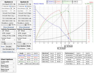

I didn't know what "150kg rider + bike" meant, so I just put in 200kg (441lb) as the total weight, which is either too high or too low. Anyway, using the Grin Max45 in standard wind, in a stokemonkey setup, and 18:34 gearing seems like another good option. More complex than a straight DD, but runs cooler.
It can do 20% for a bit over 5km before overheating in that configuration. If the speed requirement only applied to flat ground, then dropping the front cog down to 15T would allow it to climb 20% forever without overheating, but at 25kph.
These are all modeled with no pedaling.
Very interesting. The rider+bike in my post was the total weight, so you simulated it at 50kg more. I don't know why I framed it that way. My apologies. English in not a native language to me. :)
I completely missed the the small blue dot in the simulator, that allows you simulate a DD motor in mid-drive config. I see that in this simulation with that gearing you "only" get 103.4Nm to the wheel, would that be enough to push 150kg up 15-20% slopes? But then again you can just change the gearing, and "help" the motor a bit with pedaling. As to the speed I didn't have a good enough of a reason to think about drag below 40-50km/h until now, but apparently that is a huge factor in e-bikes, so in our case dropping down to 25km/h is better for range?

Thank you.
I guess I need to play a bit in the sim with different DD motors around the 2500W continues, and the variety of combinations, of motor wingdings to sprocket ratios so I get to what I'm after.
