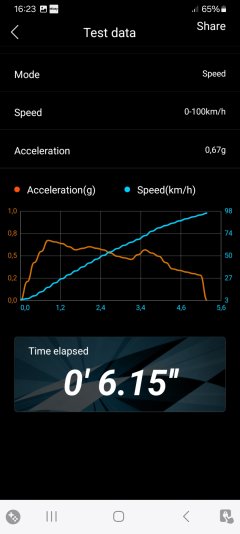

After installing the 273 60h motor and the Fardriver 721800 , I am now shure the 273 60H motor can take a lot more power than the QS260 40h without getting hot.
0-100 times is reduced from 9,5 seconds to 6,6 seconds with doubling the phase current and adding 20% more line current.
The 273 60H motor can shure take 40kw peaks. But at the moment I am limited to 33kw but the motor stays cool, even uphill for a few minutes.
I made a few test runs this year with 450bA and 1400pA >35kW. The QS273 60h can take this.
0-100kph acceleration drops to 6.15seconds. If I and the scooter would loose a few kilogramms (me 85kg and the scooter now 190kg), under 6 seconds would be possible. The motor can even take more for a few seconds acceleration.
