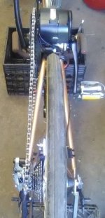

ps, I wanted to ask if you know about vertical vs horizontal drop outs and which can handle ebike power better. And also maintaining really cheap old headset bearings,,, but I won't.....

...Notice here how I've fabricated a mount for the headlamp. Not sure I like it - the lamp seems vulnerable out there! After executing the installation, I'm now re-thinking it; maybe the lamp should have a quick-release so I'm not carrying it when I don't need it and so it's less likely to get damaged (or stolen). ... Not sure how I'll accomplish that ... Weld in a bolt so it can't get lost (or need a tool to tighten) and then use a wing-nut? Do that only for the lamp or maybe the mount, too? (And if the mount, it'll need an index to keep it in position, not just a bolt.) Hmmm...
On to other matters... You can also see how the kickstand now is on its heals instead of its toes! :shock: This is better than it was, but still not quite right! I need to try again, kind of splitting the difference between the last two attempts!
AND, as I reported in the main TSDZ2 thread, I replaced the chain and now the 11T doesn't skip or hop any more! 8) :D The math says I can get to a theoretical 34.2 MPH at 90 pedal RPM! ... Somehow, I don't think I'll get it up that high, but at least I'm more likely to NOT top out the assist speed of the TSDZ2! And THAT's something to be happy about! :D
I've got two links left over for my emergency kit - not that I'll ever need it I don't think. I'm running the chain the same length as the old one (in link count). I bet I could get a 32T in the rear if I really wanted, maybe a 34! (Is there as standard rule of thumb to have any idea if it might work without the parts on hand?)
While at it, I investigated the parallelism of the dropouts - the right one is pretty damned perfectly parallel to the wheel, while the left one splays outboard a tiny bit, but in thinking about this, I really don't see why anyone should be alarmed if there's some modest error in parallelism. Any additional stresses would be localized to the nut on the axle where it clamps down ... I could see if there were a significant error, perhaps the angle could put bending forces on the fixed portion of the axle. Yet, it's a non-rotating part so it isn't going to work-harden and get a stress crack like a rotating part would - it'll just bend some. And I can't see it bending enough to cause bearing problems or such... In any event, next time I have it apart, I'll see if I can't improve the parallelism of the left side.
Meanwhile, the 52T and 11T make a perfectly straight chainline!

The creation and installation of the trailer hitch went off without a hitch! :lol: 8)
Here you can see it done: I used the same two M6 mount points used for the rear rack and kickstand, and just sandwitched the dropout. The dropout is threaded, of course, so I just put in longer bolts and then mounted the hitch with nuts to the inside face. Simple, light weight, and strong.
