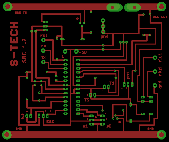

The build is still alive, I'm not able to perform mechanical working atm, but the design of the electric/electronic system is going forward.
The idea is to set up an ACTIVE electronic system, instead of the usual passive one.
For example, I'm implementing a smart engine regulation with different riding modes, such as power saving mode, street legal mode, max efficiency mode, race mode etc..
Riding modes will also depends on bike's parameters, so if motor or esc temperature is getting higher, power will be automatically reduced, or if the current over speed ratio is getting too high (an hill?) the system automatically engages a lower gear, and so on..
Also the bike lights will be controlled via software.
INPUTS:
- ESC thermometer
- Engine thermometer
- Wheel speed
- Direct/inverse current
- Battery tension
- Throttle position
- Other..
OUTPUTS:
- Servo 1 control
- Servo 2 control
- ESC control
- Lights
- Other..
A 128x64 backlit LCD will display all the riding infos, such as speed, temperatures, power, autonomy etc..
It's the core of the user interface, where the rider will manage the entire bike behavior.
Will be essentially based on my modular LCD driver:
Here you can see the very first sketch, many corrections and refinements are needed yet. :wink:
This will be connected with the LCD driver via a serial communication.
Thanks for following! :)

By the way, here's the PCB design of the main system:
Also the firmare is under development, I can correctly acquire data from the throttle pot, speed, voltage, current and temperature from the two thermistors.
I hope to power up the bike in the next week!
