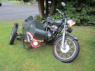

A few thoughts, as an individual experienced with sidecar equipped motorcycles, in both setup and riding..
Driven wheels to both sidecar and motorcycle might pose issues in terms of steering control. There have been precious few Sidecar outfits equipped with a successful 2wd option, and those were generally Military outfits used in low speed, difficult terrain conditions - and the driveshaft was disengageable to the sidecar wheel, to prevent tendency to want to track straight into corners at higher speed, smoother surface conditions.
There was a one-off custom 'High Performance Sidecar rig' that i am aware of that utilizes a 2wd system, involving a proportional gearing/LSD setup in a PTO arrangement located under the sidecar body. I can't even fathom the amount his engineering and fabrication efforts cost him, for his project build.
Sidecar wheel, lead in. This is crucial for neutral steering characteristics - do NOT put the sidecar wheel parallel to the bicycle rear axle. The sidecar wheel needs to lead a few inches ahead of the motorcycle axle - as such, build in adjustability of position and length of your sidecar attachments, to make this doable. You'll also need that adjustability for sidecar toe-in and motorcycle lean-out setup. Otherwise, you'll be scrubbing your tires away inside of an afternoon or two due to track misalignment. I'd suggest utilizing adjustable Heim Joints with connection rods for that purpose. You'll be adjusting Frequently, at least initially, until the setup finds it's best 'track'.. sidecar/motorcycle synergistic setup tends to be equal parts Black Magic, and Science.. and no two setups are exactly alike, except from Factory.
Steering/handling - while it might not be as big an issue with your lightweight project - the best way to make a motorcycle handle like a wheelbarrow, is to leave the front end steering geometry as is while adding a sidecar to it. Rake and Trail must be looked at, to make steering responsive, and not near as heavy in terms of steering effort required.
Proportionally speaking - look at the overall rig, as three points of a Triangle - do not let the legs between corners (wheels) be too narrow/short in any dimension. Stability requires both adequate length in terms of wheel track fore and aft, as well as distance between centerline of motorcycle, and sidecar wheel.
Try to observe the general rule 3:1 - motorcycle weight generally should not be more than 3 times the weight of the sidecar. Avoid building a lighter, or physically under scale sidecar relative to motorcycle, which creates a generally unstable setup... on a serious bump with a rigid suspension chair, if two light, it could throw the pups out of the seat - or worse, turn the rig turtle. I've done that once, so please don't do that... no pups were harmed in my case. Utilize the battery pack location for weight ballast, accordingly.
Similarly, building up an overly large sidecar, relative to motorcycle, presents challenges all of it's own. See my Photo example below of this - this was a mismatch pairing, 'a challenge' in regard to overcoming that weight/scale mismatch - sidecar was originally meant for a much larger/heavier touring bike. It took Automotive tires/rims, complete suspension design replacement on front and AND for sidecar wheel, and a sway-bar linkage to keep things nice, flat and stable in terms of neutral, bump-steer free handling. It was a personal design/aesthetic exercise that came out of a cheap sidecar opportunity, that got away from me at first, then became a serious engineering challenge when Reality hit. I've done two other outfits, that were much more proportional to scale, and relatively unchallenging in setup.. scale, matters.
Treat the package as a whole - what you do with the addition of a sidecar, is going to affect the motorcycle, and vice versa. 'Suspension' as such for your project, isn't really a concern.. but it is a general factor with the more modern sidecar rigs using suspension in various forms, in respect to changes that need to be made and are often overlooked, when adding a sidecar to a motorcycle.
I would concentrate on getting that motor putting out as many Watts as possible.. with rider, and dogs on board, you will need something that will not overwork itself to death through overheating, liquid cooling, or not. Attachment of a sidecar does put a scrub and rolling load on motive power utilized, regardless of scale. Marginal power, will yield unsatisfactory results for your application.
I may be overcomplicating your project needlessly, versus your own goals and desires for it.. but please do look at the whole package - before you start laying pipe to build your frame - you might want to locate the ideal frame points for connection bosses for your sidecar linkages, as some vintage motorcycles came with, back in the day.
FWIW, and IMHO.. good luck!

Yes this is an ambitious project, but far less so than a steam locomotive. I can ride this more places than a loco too.
You have given me more to think about in terms of the side car arrangement than I had thought of yet. I very much appreciate that feedback regarding weight balance and geometry. If I was planning on riding with side car all the time I'd build the battery pack into the underside of the sidecar... that is something to think about as an option.
As far as thoughts about powered sidecar drive, I'd only considered a small hub wheel add on if it proved necessary (which I doubt). No Years ago I'd seen a bike trailer that was had e-drive assist that gave the idea of side car with a hub motor. That trailer is the ridekick but now there are many more.
