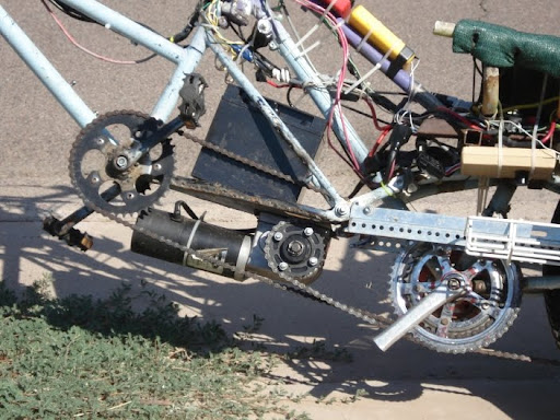

I’ve done following modifications in my creation (Pics attached):
Motor pulley is replaced by a 10 tooth gear and chain system.
I’ve designed a PWM circuit with 555 IC (I didn’t knew electronics so I had to study a lot to make that) and an array of MOSFET (IRFP 15N) which is very cheap and readily available in the local market. As for being a newbie in electronics I had to do so many experiments and failed, but every failure gave me new strength to start over again and again and again, some time I surprise my self too.
The rare suspension is modified and embedded in between the gears so that it may look good.
There is a new concept I’m working on, which I took from the 3 phase alternator system of a wind turbine on the internet. I’m trying out the same in my front wheel. For this purpose I’ve collected as many hard drives as I can to obtain the most powerful neo magnets (the most powerful magnets I’ve ever known). The thing is still in pipe line. My theory is that while I’m paddling I’ll also be helping the bike to run and produce some of its electrical energy back into the batteries. Secondly there are many times when I hold the brakes slightly which cuts of the power to the motor but the bike goes on smoothly, specially when I’m intending to stop. This will also do the same (put back the inertial energy). Thirdly, there are a lot of downhill areas on my way back home. So it will be a fruitful effort I guess. Your feedback will be highly appreciated in this regard.
I’m also not satisfied from the front suspension of the bike. I’m also intending to improve the same that is on the bike right now, as this is the only suspension available in the poor market here.
My friends I’m so much moved by the offers you make to me for any products that I need to be shipped to me. But I would say that “LET ME FLY ON MY OWN WINGS”, and let me put my self to the test, that what I can do good in the name of Allah (God) for the humanity. May Allah bless you all.

I LOVE your bike! I love your spirit! You made your own controller from scratch, as a first electronics project!!! WOW!!!
I admire that you don't want any help, and you obviously don't seem to need any. However, if you happen to have trouble locating something, anything at all, large or small, like a new front fork perhaps? Just PM me your mailing address, and the head-tube size, and it will appear in your mailbox.

In this model that won me 3rd position; basically I tried to achieve efficiency through modifying my past model:
i) Shafts and bearings were replaced with better quality and better design.
ii) Relays based speed controller was replaced by Pulse Width Modulator 555 IC and MOSFETs IRFP 150N. (design was further improved this time for efficiency)
iii) Speed throttle was modified.
iv) Automatic chain tension controlling mechanism. (high rpm motor some time derailed the chain)
v) 10 Amps Batteries were replaced by 12 Amps.
vi) Total volts 54 instead of 48 this time.
vii) Speed meter, charger and speed controller were beautifully placed/positioned.
viii) Handle bar support.
ix) Front suspension was extended and better shock absorbing mechanism was developed.
x) Aluminium heat sink for motor.
xi) Two way Onboard charging system (fast and slow charging)
xii) Custom designed cycle stand (strong enough to support more than 40 kg e-bike).
Following are the modifications/upgradations in progress:
1) Chains and gears will be replaced by a beautiful and efficient gearing box (not worm gear; ration 1:11) which I’m trying to locate in junkyards. It is also my concern that the same should have a proper lubrication system inside. This will save me a lot of energy which is lost in chains and gears. It will surely increase my distance coverage ability of bike.
2) Strengthen the frame further to make the bike stable at high speeds and off-roads.
3) Gearing mechanism (rare derailer) will be modified and more responsive.
4) Automatic charging integrated circuit, it will cut off charging automatically by constantly monitoring charge of SLAs. (Using Operational Amplifier IC LM 741).
I will try my level best not to cross the barrier of low cost as my project title is “Low Cost Electric Bike”. Due to this very reason I can’t import expensive materials gear boxes, front suspensions etc. to incorporate in this bike to make it a high tech.

Bike is doing simply great and amazing. I still can't believe the durability of the parts i used. its all functioning just fine even after having to travell 30 to 35 km daily. on the wear and tear of the tyres, the rest is just fine.
