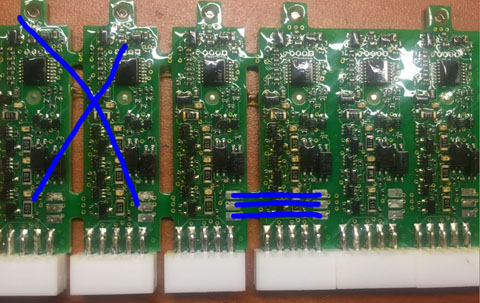

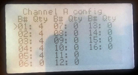

The other Problem is that i am using the BMS with an 20S Lipo Battery. The first 16 cells are getting identified without Problems. The fifth BMS Board is connected with the fourth Board via the three Solderpads on the top side of the Boards.
What do i have to Change in the BMS settings so that the fifth Board gets recognized ?
Wire it like this. Make sure you scrape off all the solder stop paint before soldering to the pads.
Go to Options/BMS Setup/Channel A config and set it up like this:
This should be enough.

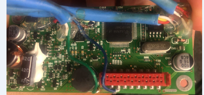

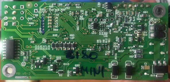

Now I need your help.
I brought a used Mini-E for my girlfriend's bike from a forum member. It arrived but unfortunately does not work and I cannot return it.
When I connect the display to the controller and hook it up to my power supply it does not turn on and the display stays black. As it is likely to have no warranty, I will try and fix it myself if I am able to.
So dear adaptto geeks, please give me a tip what can cause the controller not to start.
Things I measured:
1) Opened the display and measured all three wires vs. ground: each 0V. so no voltage gets to the display.
2) Opened the controller and measured all three wires vs. ground at the pcb connection where the cable to the display is attached. Again 0V. so no voltage gets to the connectors on the pcb :shock:
3) The controller has ON/OFF functionality, so I measured the voltage beween both wires when they are not connected. The result is the voltage of my power supply which I set between 60 and 80v. If I connect both wires there is a spark, which is the same for my working controller, so I think this is the right reaction.
4) Measured the continuity of all of the ribbon cable wires as this was the most likely thing to get damaged by the transport. But they are all fine.
The PCB looks good, too. So do all the capacitors. There are visually no black spots or disconnected routes on the pcb. The previous owner must have replaced R113 as you can see soldering flux around it. But the resistor is okay. R33 also lookes a bit like someone changed it, too. It says "123" on top and has the related 12kOhm, though.
Is there something like a fuse for the internal logic of the controller? It seems that the hole logic is suspended or the step down converter to 5v is damaged. Shall I connect external 5V to the 5V connector? I'm a bit worried about this, to be honest.
What happens if the controller was connected to + and - in reverse? What is the most likely component to die?
Any hint where to start my error search or where to find more Information about the schematic is highly appreciated! If you need more information, please let me know. I even have an oscilloscope here, if this helps.

I had a very similar problem as yours, my display wouldn't turn on. It turned out the on/off cable was shorted.
Mine Also failed to Launch on first connection, advice from Adaptto was "The problem lied in extention of On/Off wires which you've soldered. The cables inside the isolation of your extention are most likely distorted - this prevented controller from operation. Since extention of wires was made by you and on your own risk - this repair have to be paid as well as return shipment should be covered."
Hmmm, I soldered small connectors on the end and put them in a plastic connector block, spliced and soldered extensions to the small wires coming out of the Max-E then folded them back on themselves and taped them to avoid putting strain on them. Supposedly, something I did in this process "distorted" them and caused the problem which has cost me about $180 USD in freight and repairs and put my Flux Alpha build back by about six weeks. I thank Adaptto for fixing it promptly and cheaply, BUT, now with someone else having the same issue, I wonder if there is some fault in fabrication that makes these wires very susceptible to damage under normal use (ie extending the wires etc). If that's the case that little bit of the design might need a re-think.
