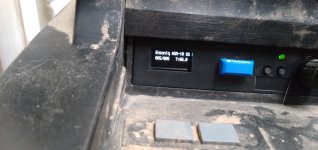

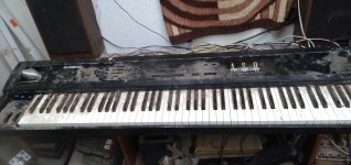

So now I don't need to deal with floppies on my Ensoniq ASR88 (ancient sampler workstation keyboard; it's core computer technology is basically the same as a Mac Plus!) anymore:

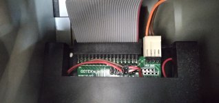

A friend that uses these on his own ancient synths sent me a GOTEC HXC2001 floppy drive emulator that essentially replaces the floppy drive with a usb-stick reader (with some firmware magic in there to translate the one into the other and some controls on the front).
Some basic info about them, and what they can work on / with, for those interested:
(basically anything that runs from a floppy drive can now run from a USB stick, including assorted industrial devices)
There are no instructions anywhere (including some extensive websearching!) for the exact process to use when installing one of these on the ASR88 (or any other ASR or EPS) and how to use it afterward. Physical installation was easy, (i have the ASR service manual, such as it is, if I needed it, thankfully didn't), but getting it to be detected and booted from..... I eventually got enough hints from the descriptions of how certain things work in various places to make a guess and that worked to at least get a bootable image onto it to startup the ASR.
I'll make as complete a tutorial as I can for anyone that runs across this in a search, but for now:
--Installs just like the original FDD, but you have to make sure the "jumper" on the HXC is set to "S0" (mine came on S1).
--You don't make the USB stick into a disk image (with your PC), which is possible to do with various programs, from the HFE or IMG files of the Ensoniq OS, you just put the image file onto the FAT32-formated USB stick.
--Put this USB stick in the emulator's slot, turn on the ASR, then the emulator will have a screen showing the first image file's details; if the OS HFE is the only one on there then you don't have to scroll thru the image files, just click the knob and it's now "loaded".
--Turn the ASR off, then back on, and it will now go thru the boot process normally.
I still get some errors; I can't change whihc image is loaded (if I have several on the emulator) as it says "disk not formatted", then sometimes if I wait a little while it will then begin reacting as if it can read directories and files on the new image, but it won't load anything off of it, giving the DNF error each time. I'm sure there's a solution to it, but I am too tired now to keep researching, and will continue later.
However...even without that, I can still just boot to the OS, faster (a little) than the original floppy, and "create new instrument" so I can then use it as a keyboard to control my in-SONAR softsynths, which is how I've used it for a long while now. This way I'm not wearing out the few floppies I have left that it can actually use (it's pretty picky because the ASR OS doesn't test for or mark out bad sectors, it uses them all regardless...so an imperfect disk will "work" but then fail on something important because the data is wrong), or the drive, and I can (eventually when figured out how) have a lot of floppy images (32gb I think the stick I have holds) on there if I wanted to have the sounds, fx, etc., and use the workstation as a sound generator and/or fx processor as well as a keyboard.

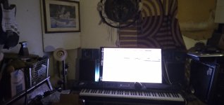

Had a chance today (by dint of failure of ability to do much of anything else) to get the music workstation set back up to use the ASR88 with the new boot drive.
The main "problem" is that the computer being used is presently still my main laptop, as I still can't clone it's drive to the SSD for the duplicate laptop I wanted to use just for the music stuff. (I have yet to finish installing enough things on the HP server rack to use it for the music stuff, and then to do the mods to the cooling systems to be able to remove all the loud fans...).
The main laptop is across the room next to the bed, and because of the already existing problems with it's connectors I don't ever move it. So the cable for the workstation's monitor have to reach to the external USB video box I've attached to it, and the audio and midi cables have to run to the external USB boxes for those, and all have to run down the back of the station, under a heavy floor rug, and back up the shelves the laptop is on, so that JellyBeanThePerfectlyNormalSchmoo won't entangle herself in any of them and remove all the equipment from the room in a panicked flight out of it as she then yanks things to the floor.... ;)
So every cable ahs to be around 12-15 feet long, or multiple shorter cables strung in series. For USB, MIDI, and audio, that's not a big deal, but I haven't yet found a really cheap HDMI cable that provides usable video at that length (tried two off amazon becuse they had free returns, and had to use that feature for both). So right now I'm using a DVI-VGA adapter at the video box output (it has one each HDMI, DVI, DP, each of which can be used as a separate monitor output, or clone the display, etc), then a long VGA extension cable and then a long VGA regular cable. The latter is well shielded, very thick, but the former is not etiher of those, so the resulting video is horizontally slurred across the screen. Still readable, but details are lost and certtin editing functions are difficult.
I have two thick well shielded cables but neither can be used because there is a missing color in each one, and I just don't have the ability at present to cut into the cables to find out which end the problem is at and replace that connector or fix it (or whatever wire fault there is between them). All these cables are used, some of them 30 years old or more, so ti's not surprising they dont' all work right. :/
Goodwill sometimes has good HDMI cables but they are never longer than about 6 feet, some fo them shorter than that. VGA cables hardly ever show up there anymore, and are almsot universally short and crappy.
Unfortuantely the video box uses a specail very short usb cable and doesnt'w ork right with longer ones, so I can't extend it that way and avoid a longer video cable; I had to actually glue the box to the laptop to ensure it wouldn't move around and unplug or damage that short cable or the lptop's (only) usb3 port.
by the time i was done I was too tired to do anything with it othe than make sure it worked and sound was good, but...it does work (and the powered partner speakers are MUCH better than the vizio soundbar i normally use (because the PPs are too big and heavy to mount on the monitor swingarm over the bed).
