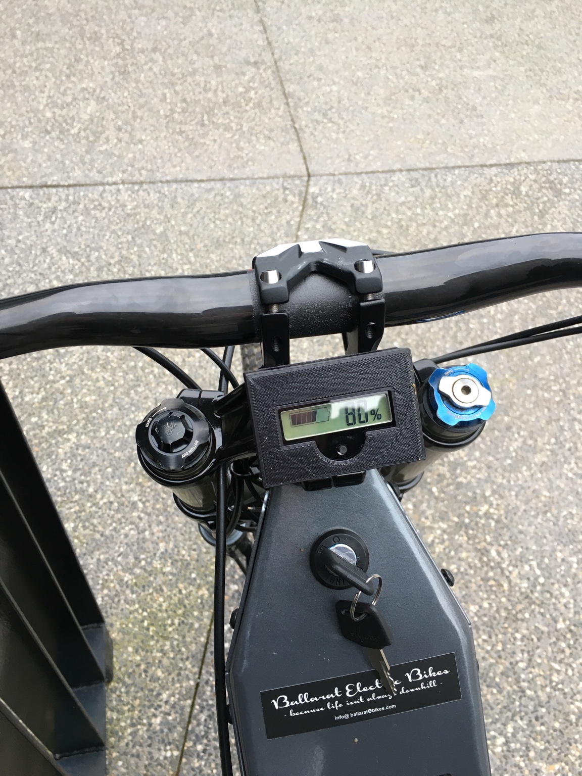

Are the info on the display useful or is it just nice to have? If you drop the bike on it's side or just laying it on it's side in your car during transport, you always risk the change of cracking the lcd screen. Keep It Simple
you could integrate the display inside the side cover. that would keep it scratch safe, and would still be useable.

Oh and Andy i usually mount that gauge on my bars / stem with some neodymium magnets hotglued into the back of a 3d printed case, and run wires down and plug it in. My printer is down atm but i can send the file if you want.
Nice case. Yeah. I could also do that. The bafang display has battery level, so it's probably adequate.
If I had a 3d printer I'd take you up on the offer but unfortunately I don't... One day.
