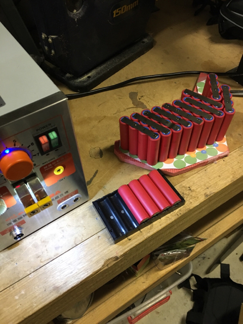

Should be a good amount of room.
I hope you guys can excuse the fibre tape. The local electronics shop was all out of banana shaped shrink :)
I used 1.5mm poly all round for a bit of piercing and chafing protection.
Photo shows a bit too much perspective. The base of the battery is inside the perimeter of the outline you sent. Some good room left for padding underneath along the shelf you're dropping into the frame.
Holy crap that looks awesome.
Well done on the battery box.
Would be good to get something soft under the battery to spread the load across the uneven base cells.
Thanks. I am planning to stuff all the gaps around the battery with firm rubber just before I close it up.
Awesome. Running two different densities of foam has proved useful in the past. A softer outer layer helps to take up irregularities if the box isn't square/even.
